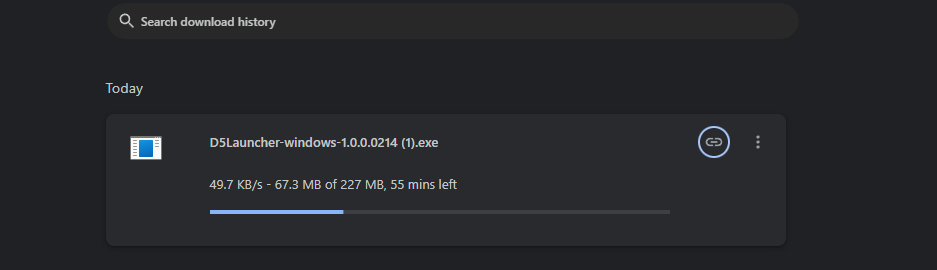

**Issue Description: My D5 launcher and render and not working properly in terms of internet connection. Assets are taking too long to download or update, although i checked my WIFI connection, it is working properly in other applications. Also tries to update D5 launcher, it get stucks at last. Also tried removing d5 render and launcher, but now when i am trying downloading D5 launcher, it is showing 3-4 hours to download setup. Getting upto 100mb/ps of speed.

Yes i have tried everything. Nothing works.
It took a whole day just to update around 15-20 assets in my project.

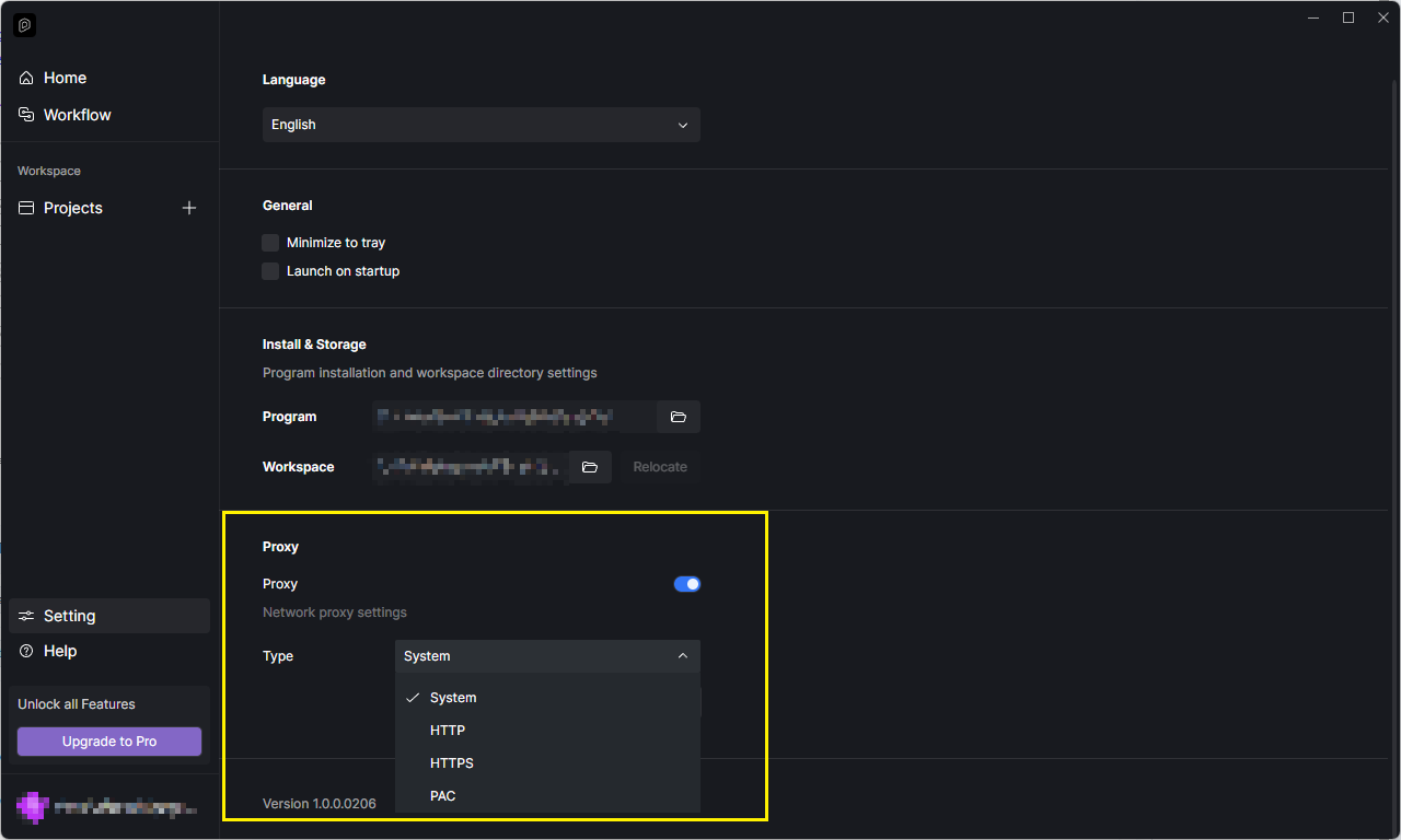

  • You may also try to modify your proxy settings and see if the issue persists.

I tried modifying proxy settings, but didn’t understand much.
