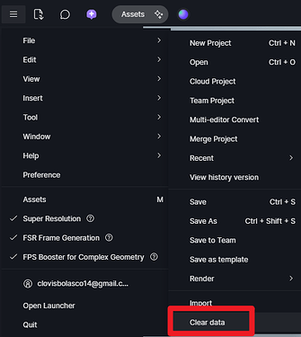

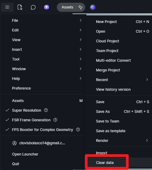

Hi @mpindur
Clear Data: This will delete imported models and auto-saved backup files for the current project.
