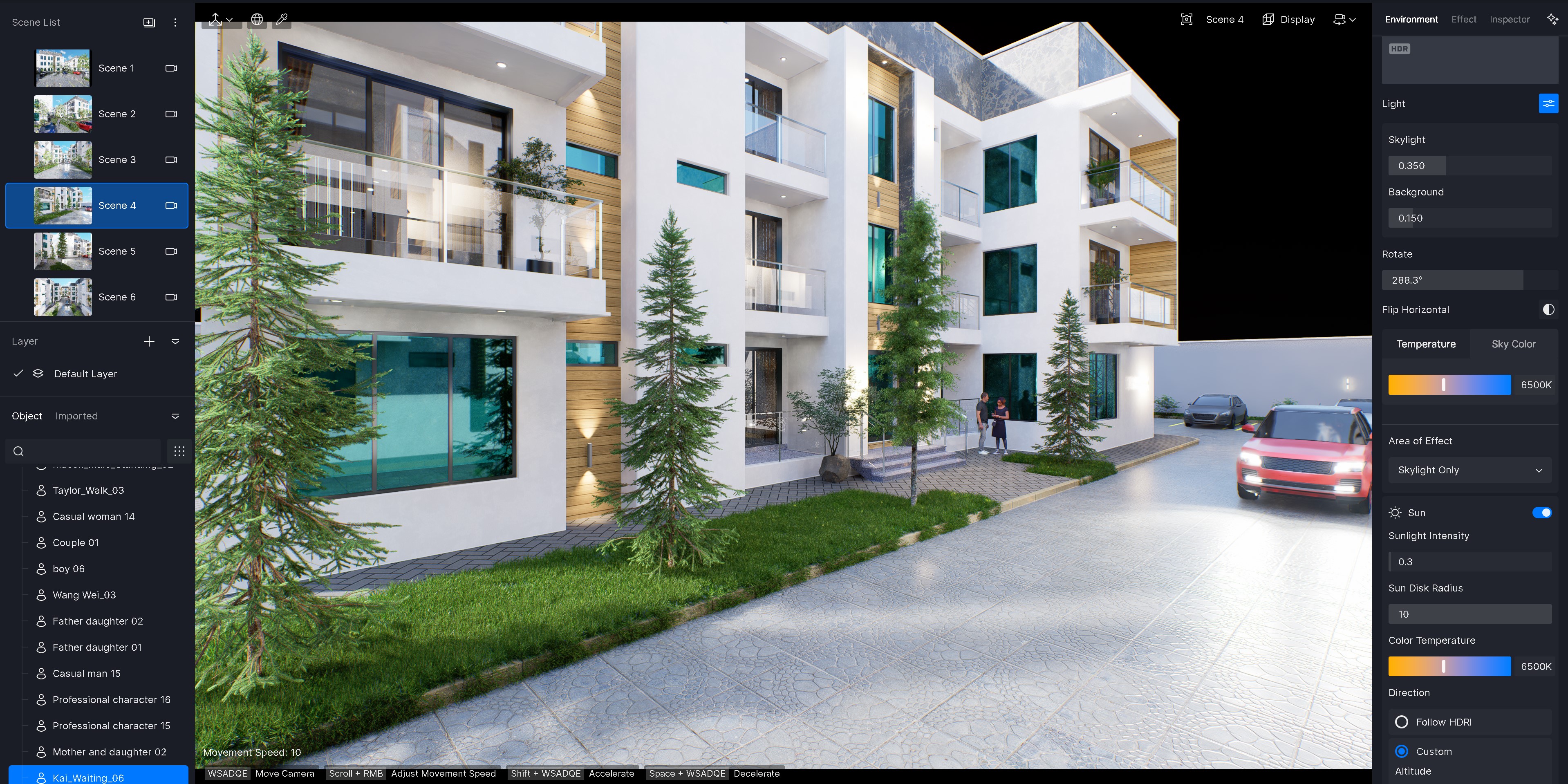

I updated D5 Render to version 2.10 yesterday, and since then, I’ve been having an issue with HDRI images. The software no longer recognizes the HDRI I had set for each scene. When I reload the same HDRI manually, the sunlight doesn’t match what I had before—the entire scene becomes much darker, and I can’t seem to adjust it back to the original look. I’ve experimented with various settings (exposure, lighting, etc.), but nothing’s working.
For reference, I’ve attached “before” and “after” screenshots below. Has anyone else experienced this after the 2.10 update? Any ideas on how to fix it or restore the previous lighting?

Could you please share how you resolved the issue? I’m still experiencing the same problem despite trying everything. The HDRI is still not appearing, and the entire scene remains dark, as shown in the attached file.
Would appreciate any guidance. Thanks!

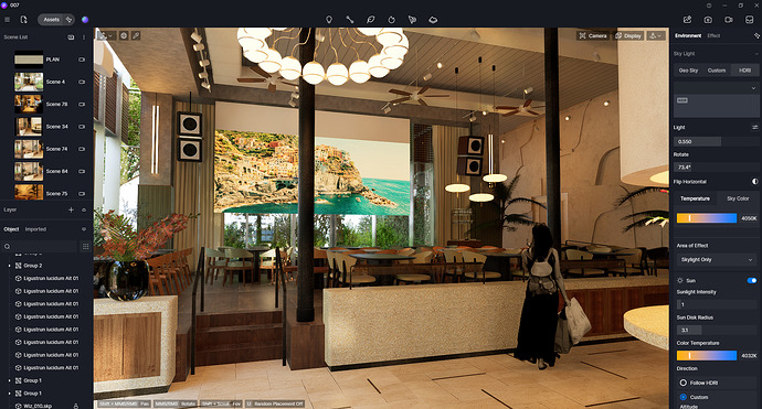

Hi @Clov !
I use one of the D5 Render HDRI. Please see a screenshot attached.
Hi @delphine.ab
What does this HDRI look like in an exterior setting? We can’t seem to identify based on the screenshot you have provided.
