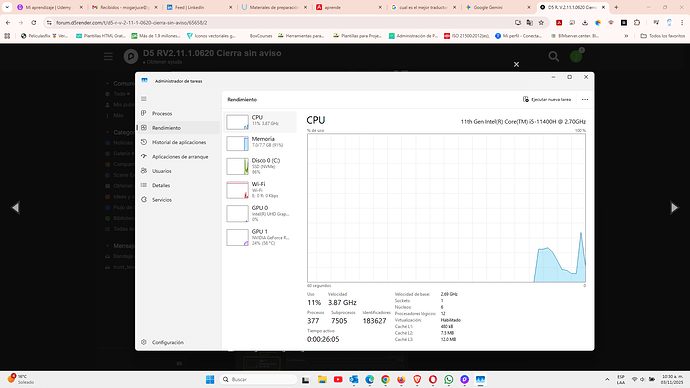

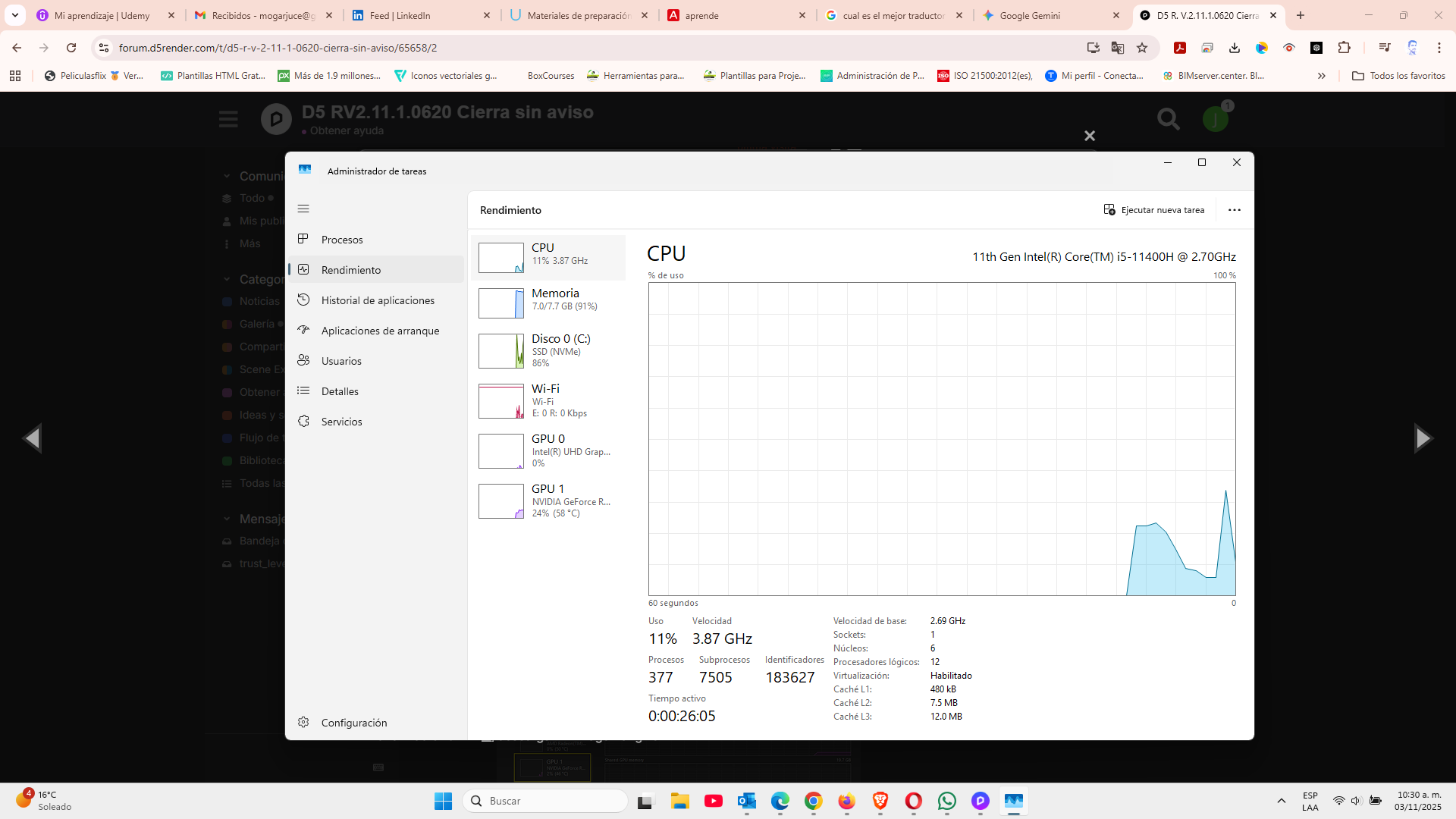

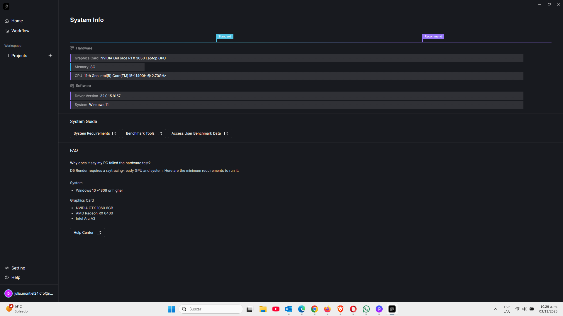

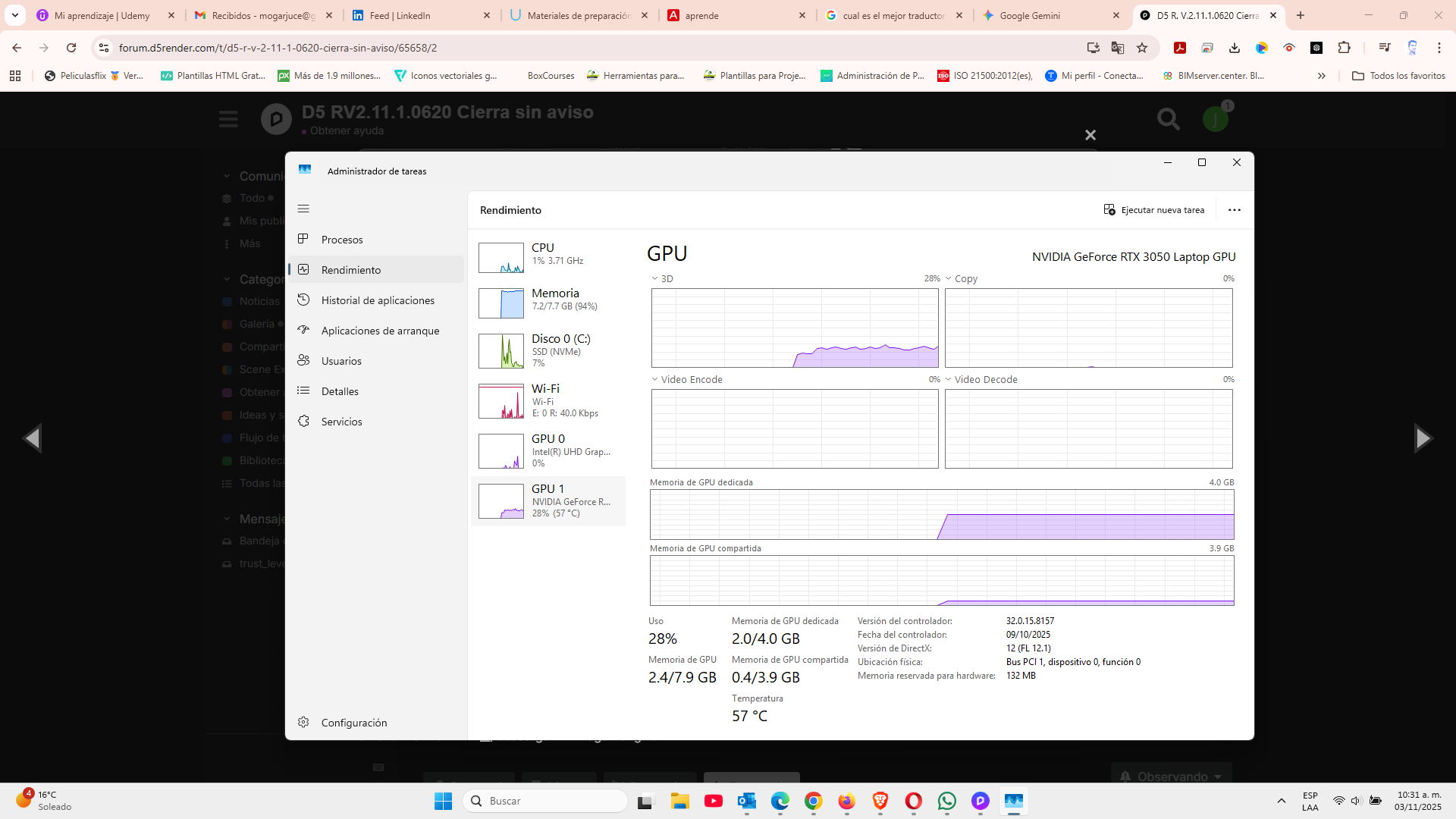

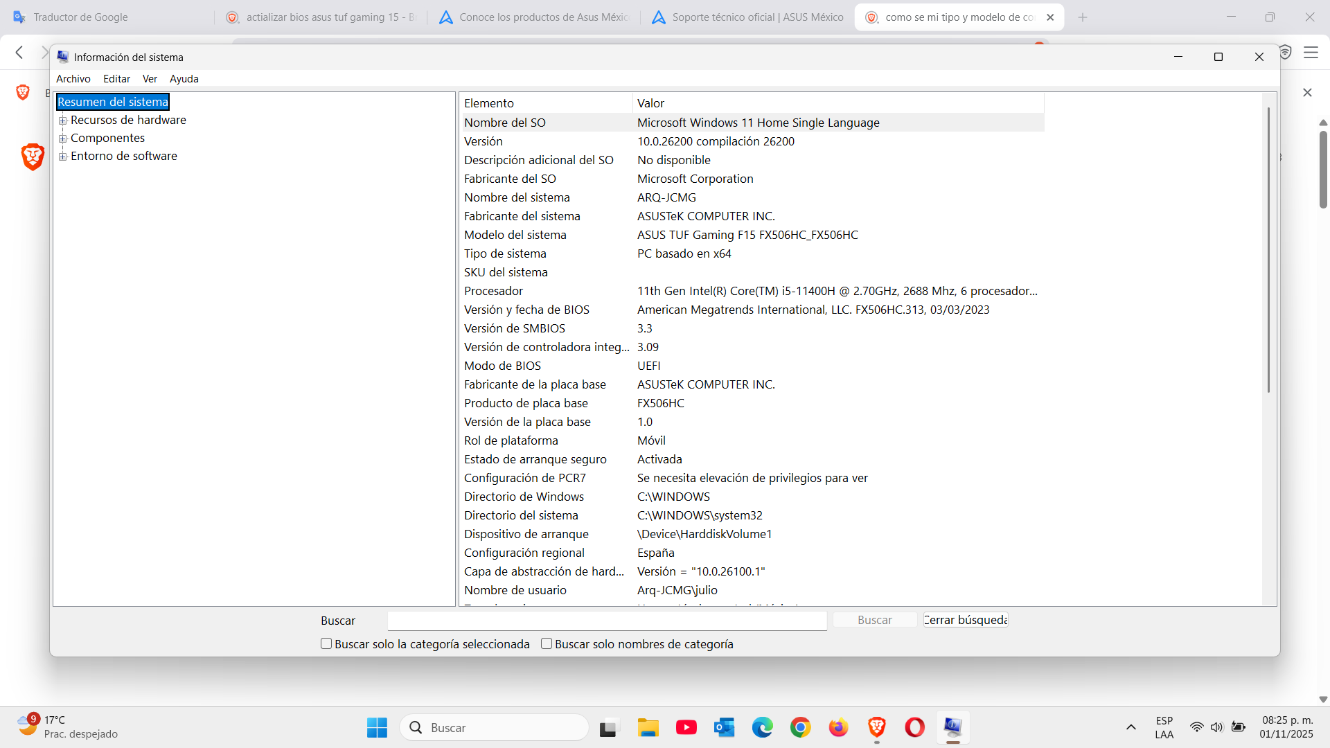

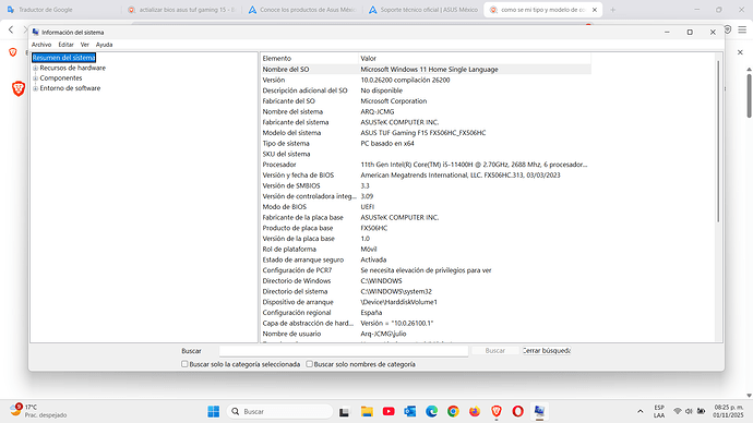

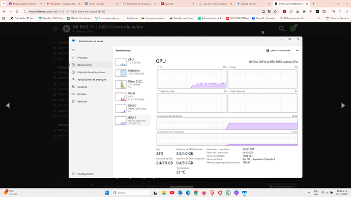

anexo caracteristicas de mi laptop

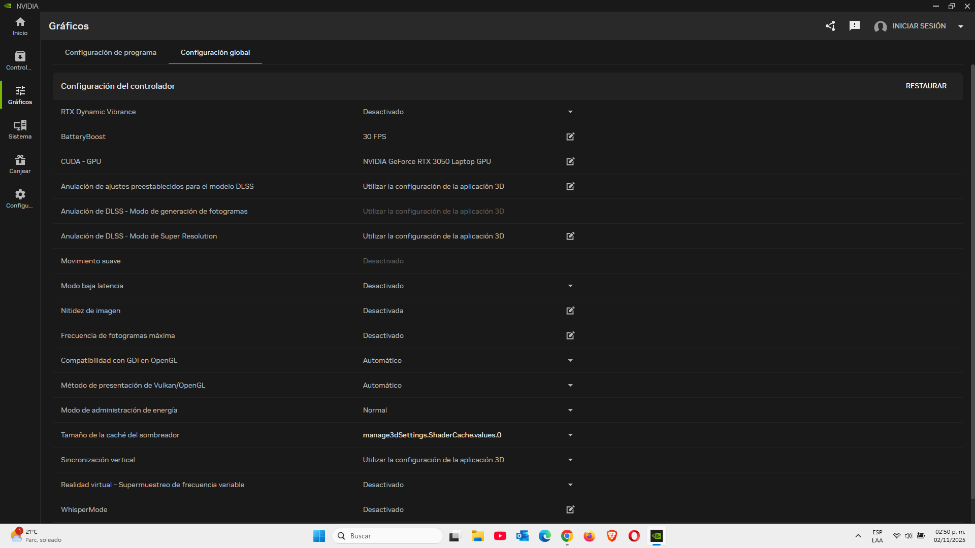

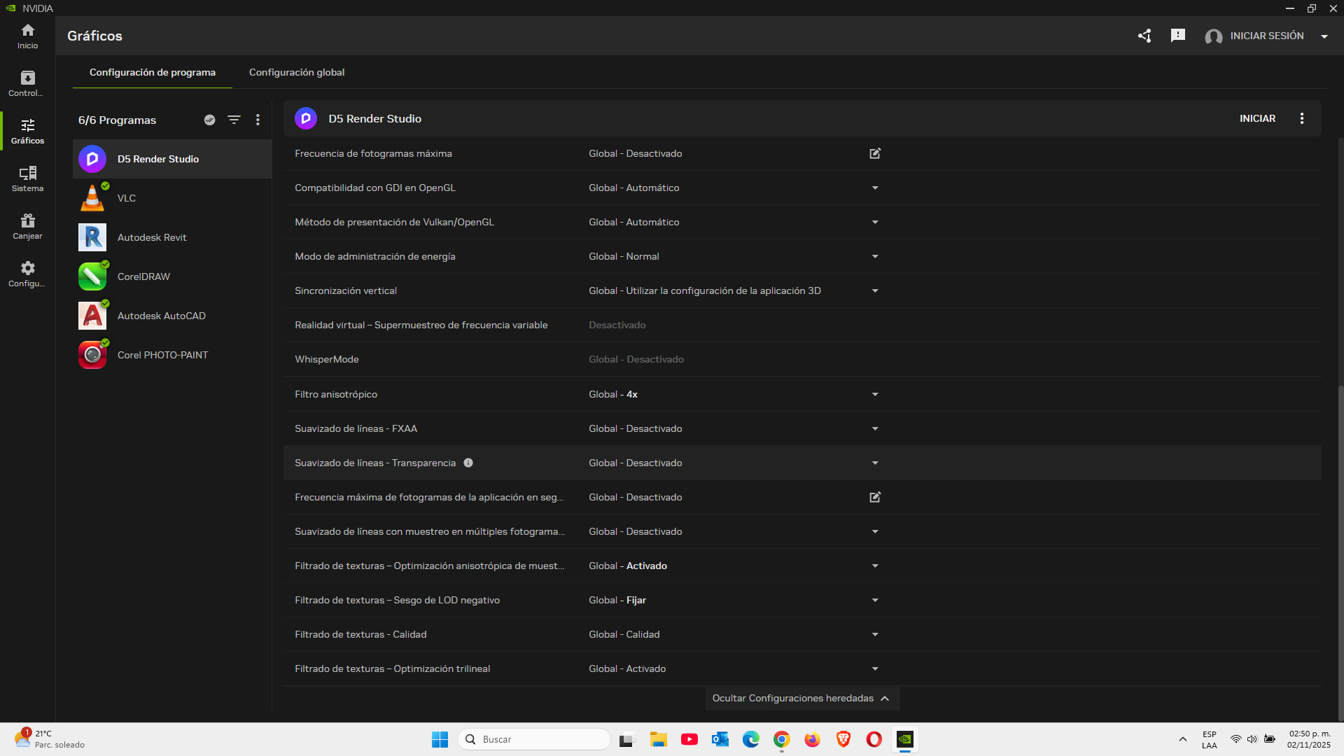

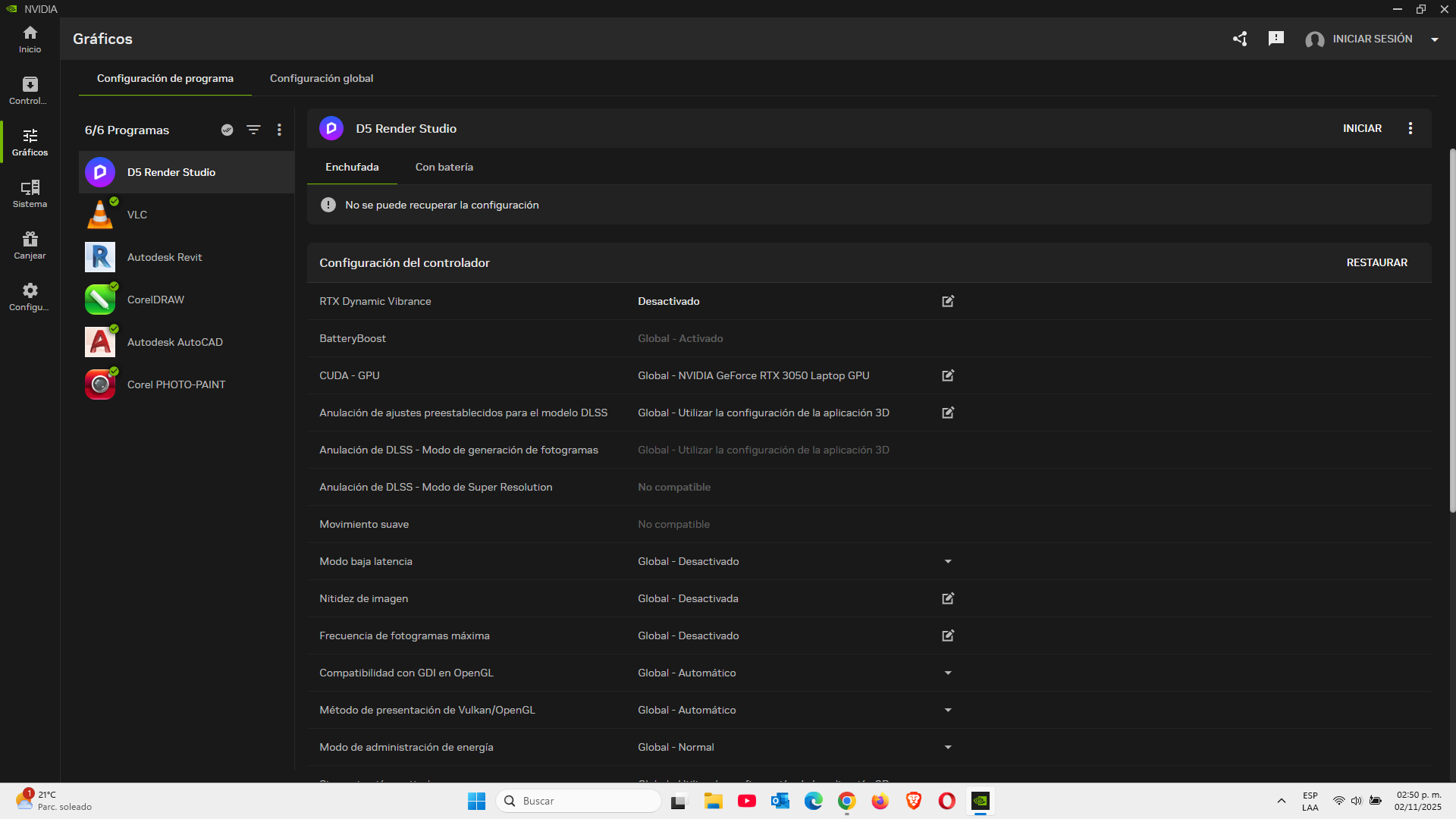

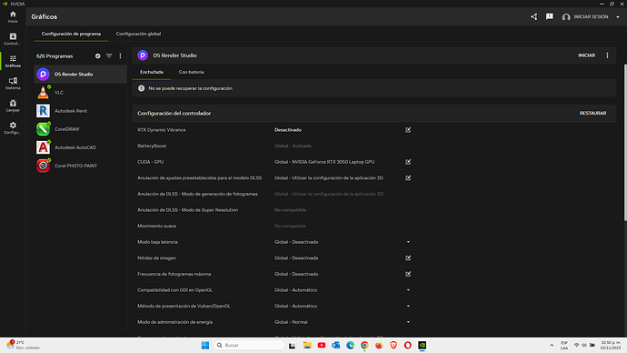

Ya intente regresar a controladores envidia anteriores, cambiar configuraciones generales de nvidia y no he tenido solución.
Hi @julio.montiel24lcfp
Does it close even with empty files? Can you send us the following images:

Please try the following:
  1. Clean Reinstallation of Drivers, or even installing the latest version.
  2. Disable Hardware Accelerated Scheduling
  3. Change NVIDIA Control Panel settings: Make sure D5 is using High Performance.

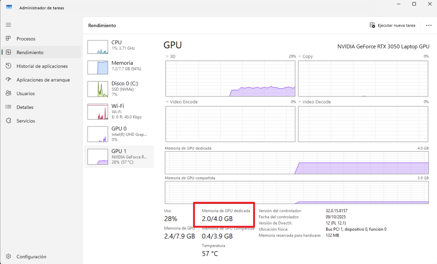

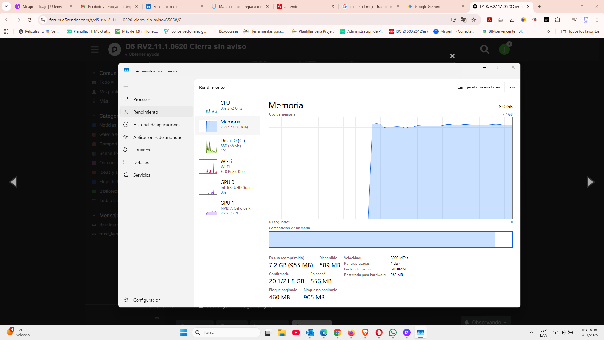

Se ha corregido el problema inicial. Solo que cuando hay archivos grandes se llega a generar el cierre de improviso esporadicamente.
Ademas se generado que al iniciar el programa tarda más en abrir plenamente (hasta 2.5 minutos)

  • Additionally, large files closing or crashing on your end is quite expected considering you only have 4GB of VRAM in your device. VRAM plays a huge part in processing large files. You may need to optimize your files.
