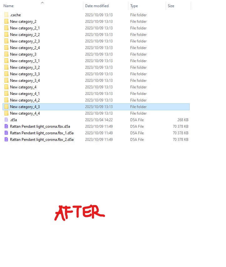

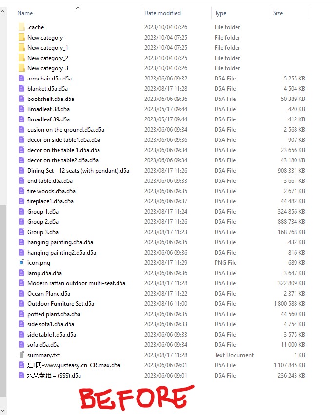

**Issue Description: My local disc had run out of storage space, so I needed to move the local asset library save location to my archive server harddrive. Once the merge was completed and cache cleared, the local library has not loaded as it was when it was still on my local disk. There are only cache files, txt files, and icon thumbnails. I cannot gain access to these locally saved assets anymore. No “categories” made it through the merge either. How do I restore my local asset library?

Hi ChanLee,
Thanks for the reply. Much appreciated.
I followed those exact steps. The server was mapped to a network drive and the location was changed via the Preferences menu.
Is there any way to “restore” the assets from the “.cache” folder where inside there are 3 files per object: “fileslist.txt”; “icon.png”; “summary.txt”.
The .d5a files are the ones that are missing.
