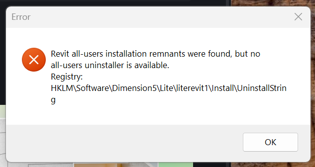

**D5 Render Version: D5 Lite for Revit
**Graphics Card: 5070Ti
**Driver Version: Tdudio 616.56
I get the attached error when trying to install D5 lite on my machine for Revit 2027
Anyone run into this?

Hi @mbianchi
I messaged you privately about the files we need to collect. Please check your forum inbox as soon as possible.
It appears that I needed to change the dropdown on install to “All users” and not “for me”. After I fixed that, it worked and installed flawlessly.
