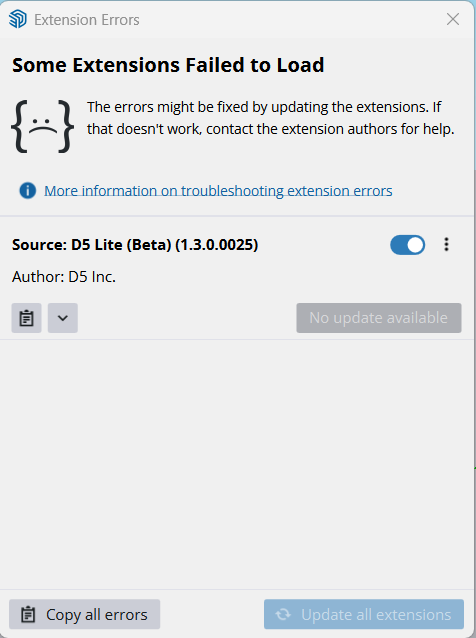

D5 Lite Failed to load
**D5 Render Version: D5 Render V3.0.1 // D5 Lite V1.3.0
**Graphics Card: RTX 4070 Laptop GPU
**Driver Version: Nvidia Studio Driver V595.79
**Issue Description: I installed d5 lite to try it out, but its failed to load. I already tried uninstalling and reinstalling everything, but the same error persists.

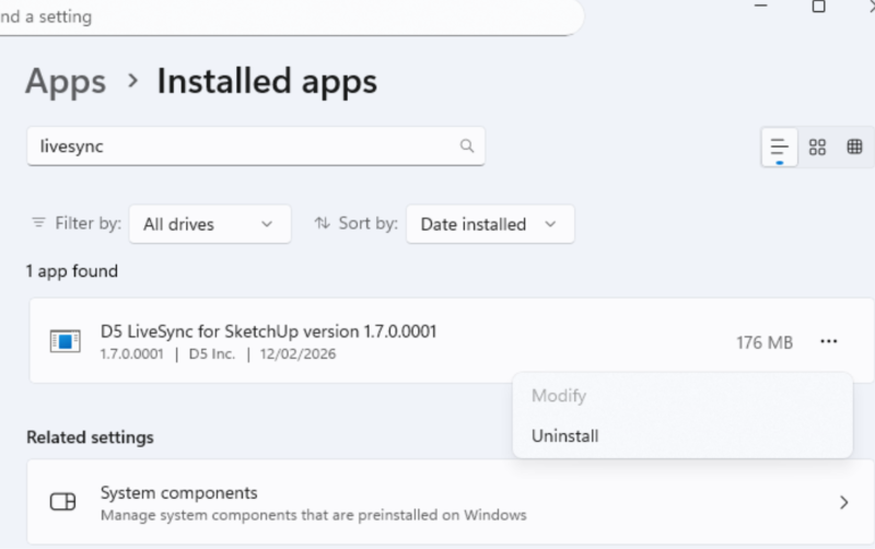

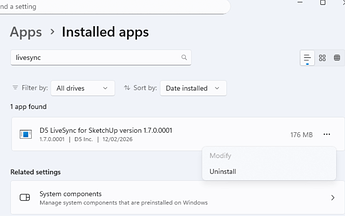

There were some reports regarding this issue, and we were able to pinpoint that this is usually caused by the presence of D5 Livesync.
  • Please uninstall D5 Livesync via Control Panel or in your Windows settings
  • After that you may reinstall D5 Lite again.
