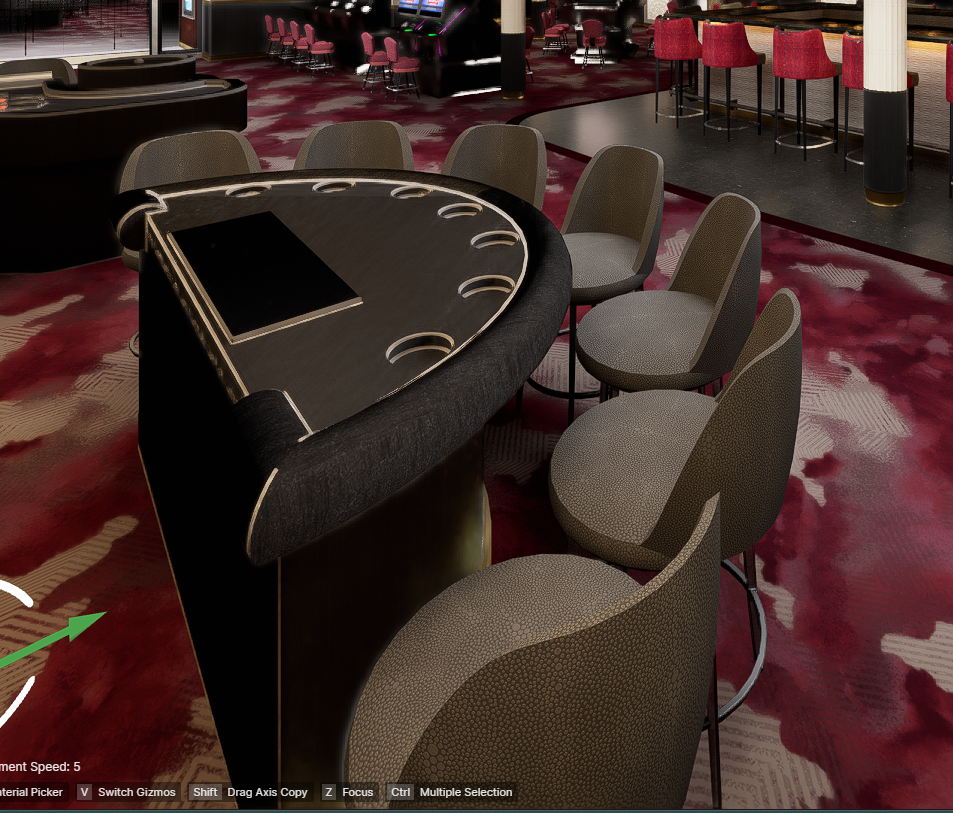

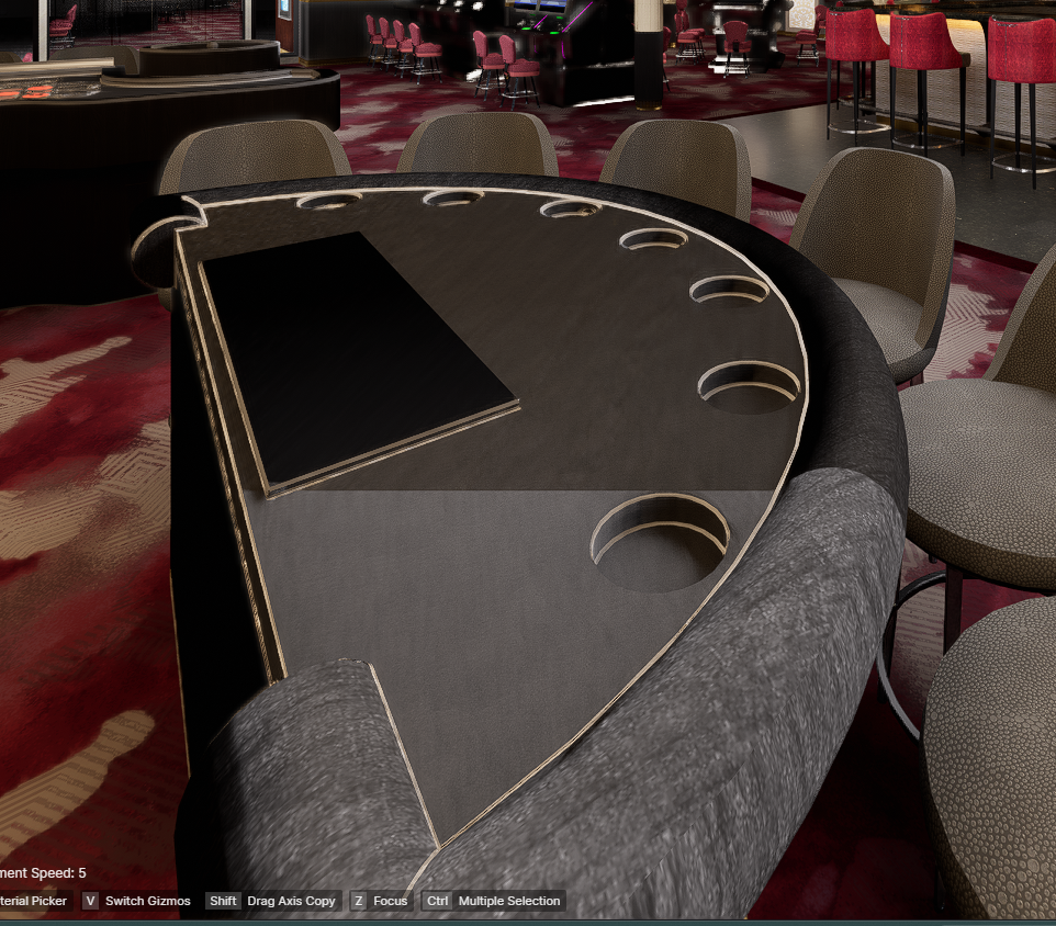

I was working on a scene on one computer with version 2.10.1.0579 and noticed the materials were super dark. I walk closer to the material and it becomes normal with a harsh line–almost like its culling or something. See images.

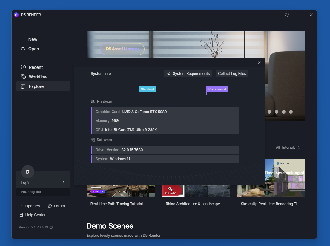

I apologize for the inconvenience. May I know what GPU you are currently using?
  • There is currently a known issue with RTX 5000 Series with Driver Version 576.02 and above with Round Corner enabled, resulting in an unnaturally dark material. The workaround is to revert back to 572.83 Driver Version.
  • This issue will be addressed in the next D5 Version.
I am currently running a NVIDIA GeForce RTX 5080 with the Driver Version 32.0.15.7680–see image attached.

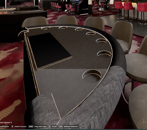

Also looks like the original post duplicated the image–see attached for the issues.
Are you using round corner? Please try to refer to this reply, and disable “Round Corner” for this specific material.
