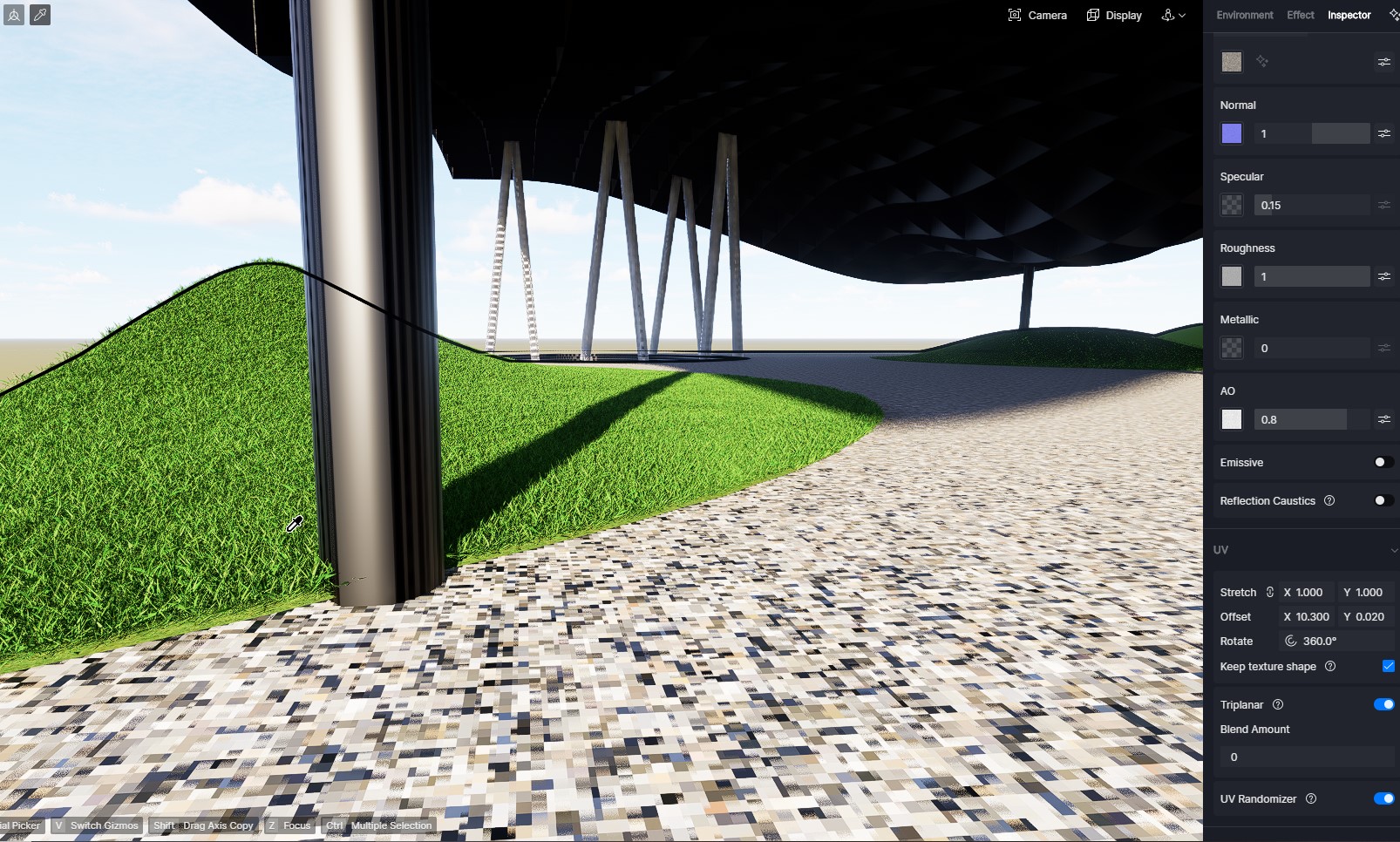

Hello, i have problem in D5 when I want to put Pebble material from D5 library, it shows as pixelated and flat. It is 3D model imported into D5 from Rhino file… Can anyone help?

Please try the following:
  1. Change the UV Material Map in Rhino
  2. Try to check the model’s position and bring it closer to the 0,0
