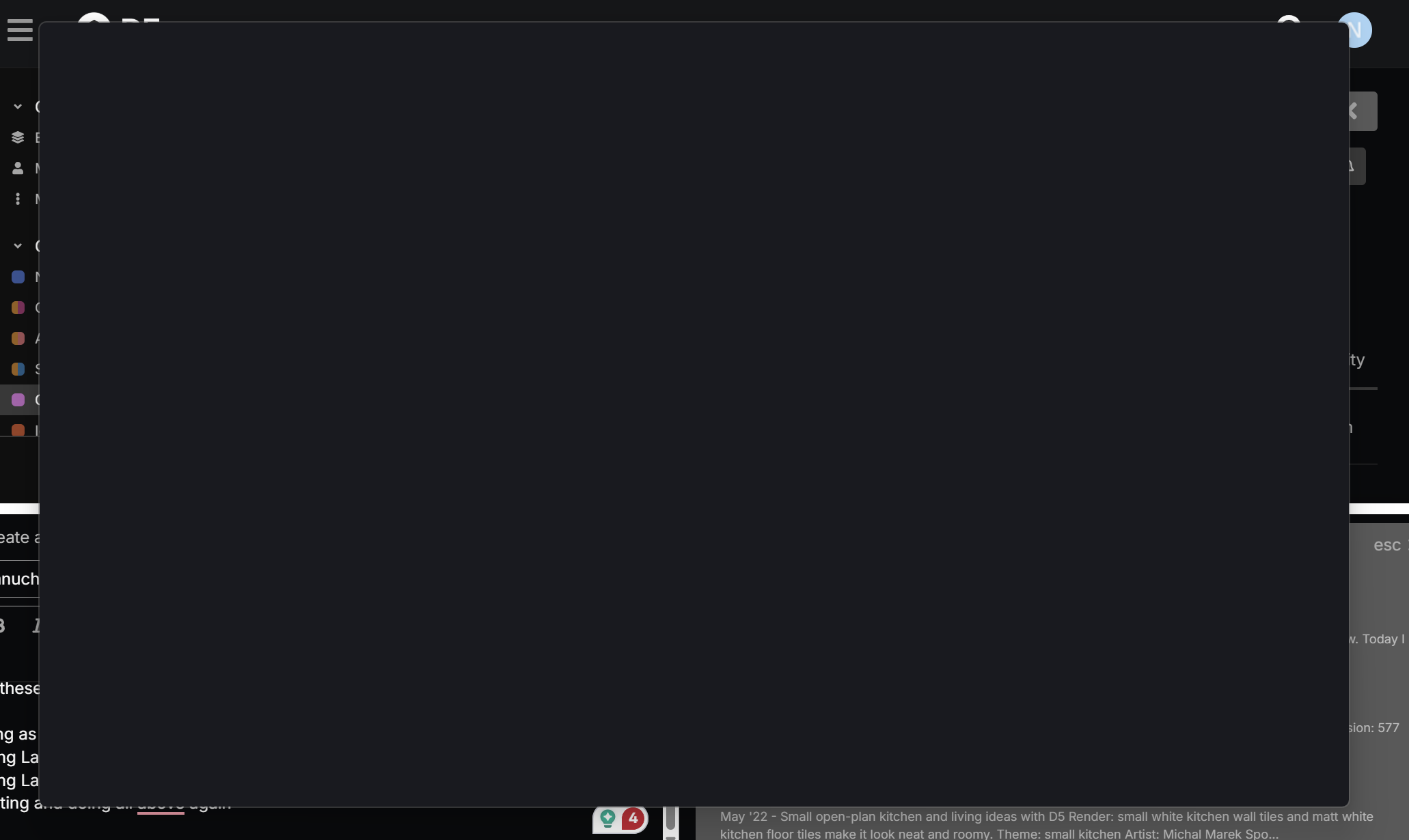

Hi there,
I am trying to open the launcher to install the D5Lite.
The launcher popped up okay for the first time but now it does not run.
I tried these:
Running as administrator
Opening the Launcher from the D5 client
Opening Launcher from start menu (separate from the D5 client)
Restarting and doing all the above again
The Internet is fine
Tried disabling anti-virus/defender, etc.
Latest versions
It always shows like this: a black screen that looks like it is not loading

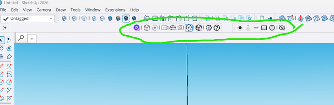

A fresh installation of SketchUp 2026 and all D5 plugins are installed
But I do not see any D5 Lite icon anywhere

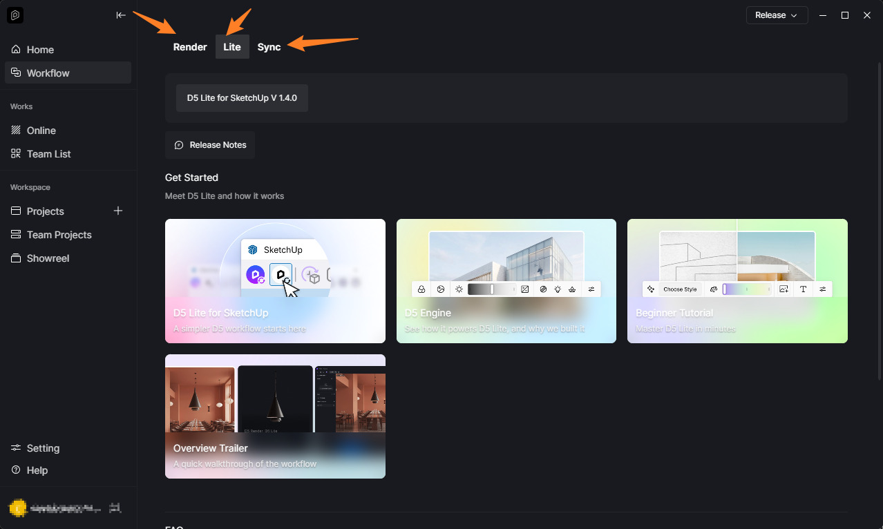

Solution:
For all users who have experienced such a frustrating issue, this is the way to get D5 Lite running:
Open the launcher, head to the “Workflow” tab, select your 3D application, and click “Install” for D5 Lite
If you follow the path that the D5 website is suggesting, you never get to this; it just redirects to the download page, never saying you have to install it from the launcher/workflow.
