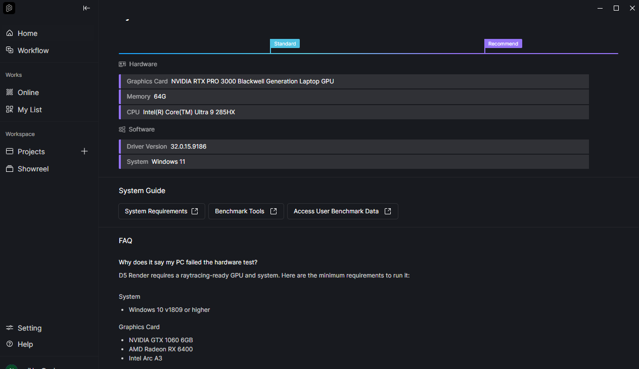

Please also attach a screenshot of your D5 system info

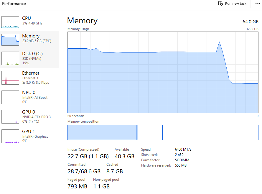

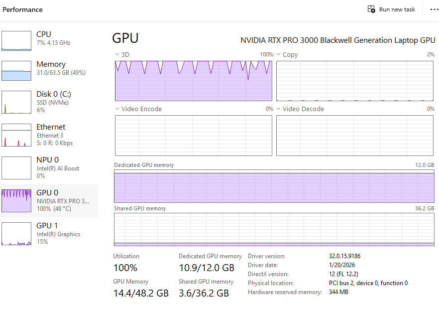

And screenshots of your hardware usage from Task Manager

Hi @neil.lao
Thank you for the detailed breakdown and for attaching the screenshots—they’re very helpful.
