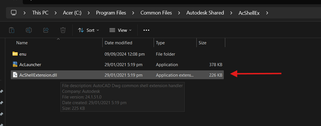

Hi @justinush1 I would like to know if you are using Claro drive or Autodesk DLL/plugin,
Please rename this: AcShellExtension.dll > AcShellExtension.txt. If the issue persists, please share your logfile with us for further investigation. Apologies for the inconvenience
I was having similar issues with version 3 of D5 crashing. Crashing with a brand new empty file, a current project file, didn’t matter. Program would open or start a file and then if I tried to save it would crash. Sometimes it would crash just trying to move around the scene.
I renamed the .dll file mentioned above and so far (fingers crossed!) I am not having any crashing issues.
Thank you for the feedback @dan. Please reach out to us if the issue persists.
So far so good! I was VERY happy to find this solution.
