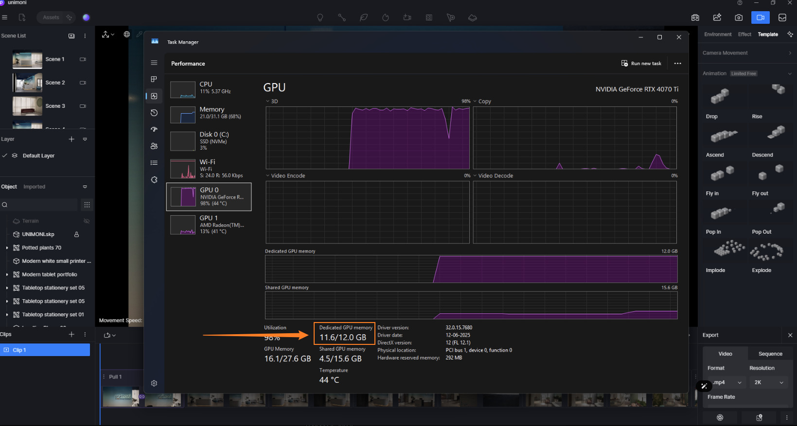

D5 is frozen when rendering videos and crashes mid way, when it comes to image rendering its lakes about 15 mins to render in 2k , earlier it would just take 2 mins. However with SR turned on its fast but a lot of details are lost

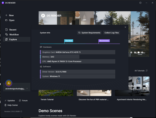

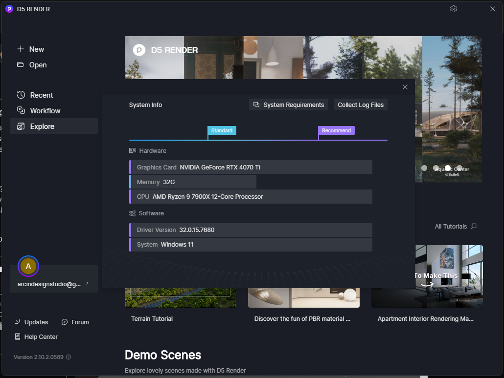

**D5 Render Version:**2.10.2.0589
Graphics Card: RTX 4070Ti
**Driver Version:**32.0.15.7680
**Issue Description:**D5 is frozen when rendering videos and crashes mid way, when it comes to image rendering its lakes about 15 mins to render in 2k , earlier it would just take 2 mins. However with SR turned on its fast but a lot of details are lost. Also the graphics card turns of mid renders

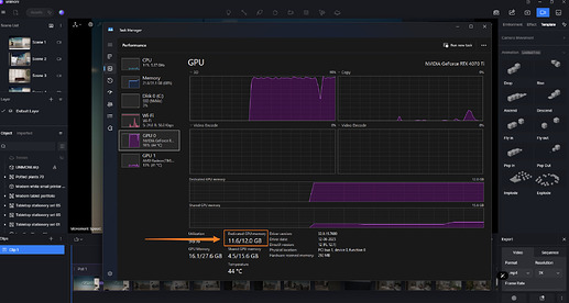

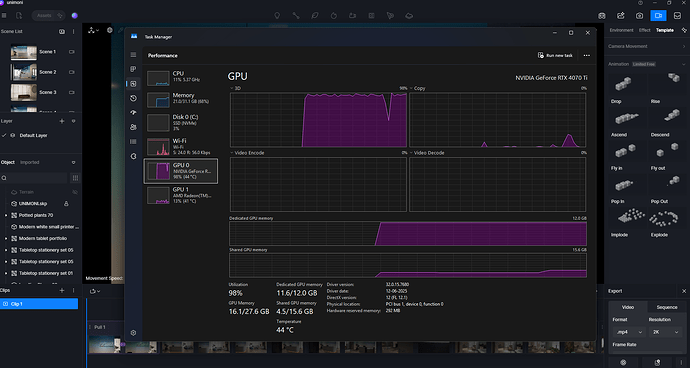

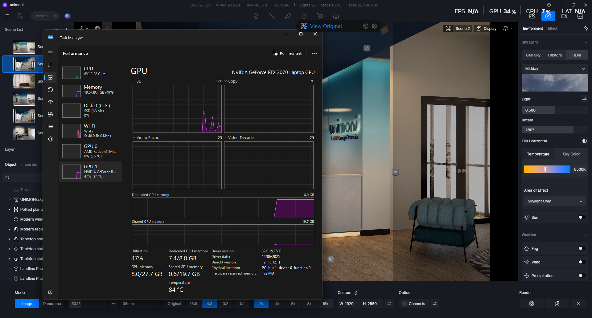

Anyway, based on the images you have sent:

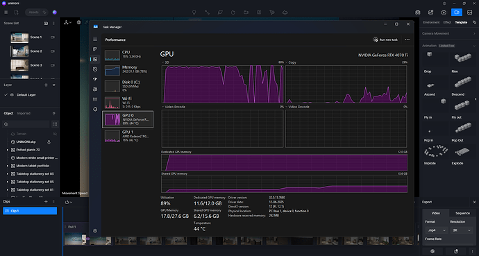

  • Lagging and crashing is susceptible to heavy files, most especially when VRAM is nearing it’s maximum capacity, it is already using 11.6 GB/12GB of your device.
  • You have mentioned that “GPU turns off mid render”, can you check the capacity of your PSU? It should be above 750 otherwise, it may cause power delivery issues.
  • D5 SR Widget, significantly improves the rendering time at the cost of losing some details. If you wish to prioritize render time, then it is best to enable this feature.

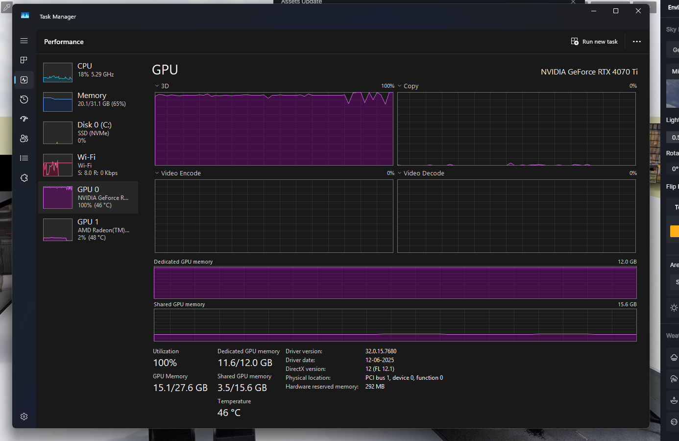

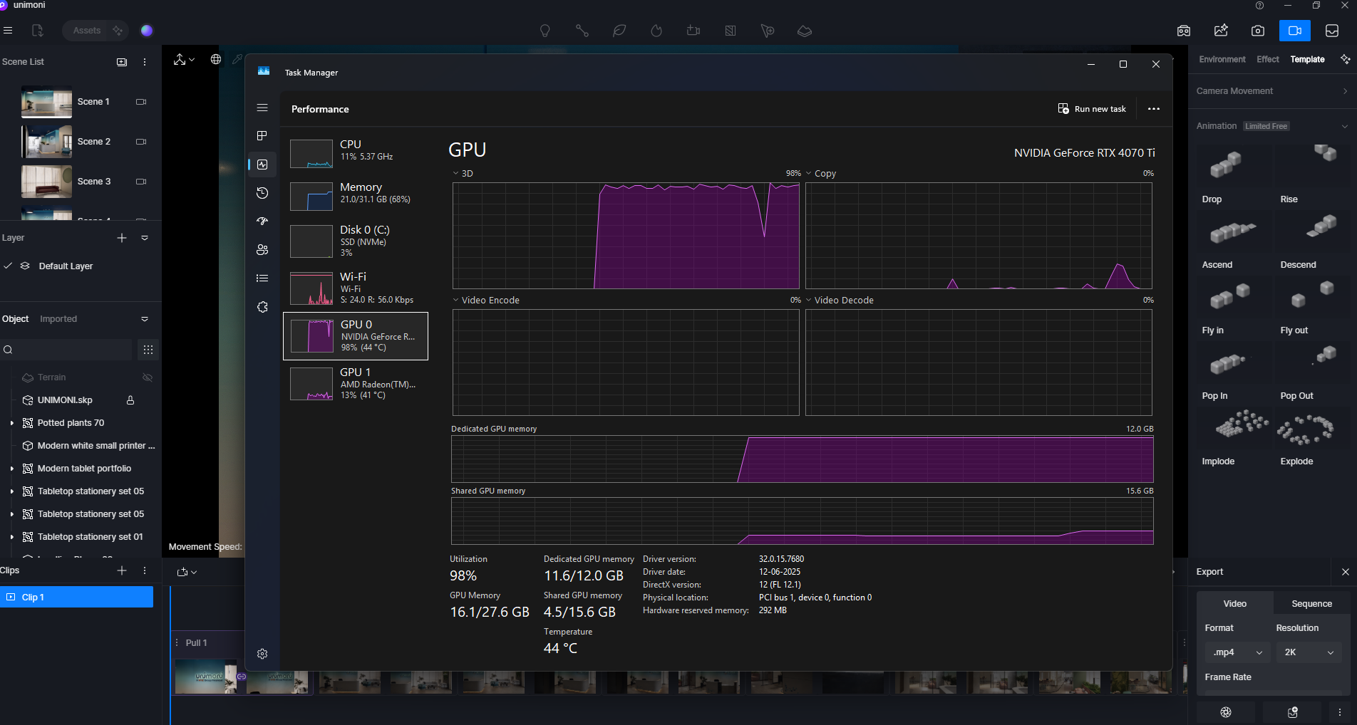

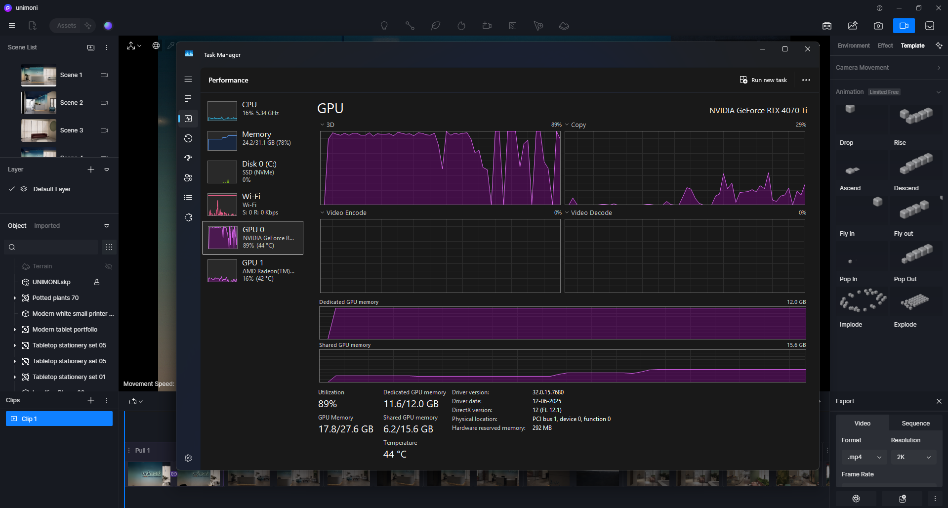

Its not a file specific issue, I’m having difficulties in navigating through the old projects too. I opened an old file and still the VRAM is showing the same value of 11.6/12 GB.
The power source seems to be fine . My UPS is a 1000 VA/ 600 W.
The screen has started to stutter during navigation.
Also I just have Super Resolution-DLSS is not available. Navigating through the files have also slowed down and started to stutter.

I just tested your file on my device. For reference, my device’s specifications are:
Results:
  • There are no crashes on my end. I have rendered 7 images.
  • Each scene render time spans from 2 minutes to 4 minutes and has not gone beyond 5 minutes, even with D5 SR Widget disabled and Path Tracing Enabled
  • Overall, the project is normal on my end, which is surprising considering that your device is significantly stronger than mine.

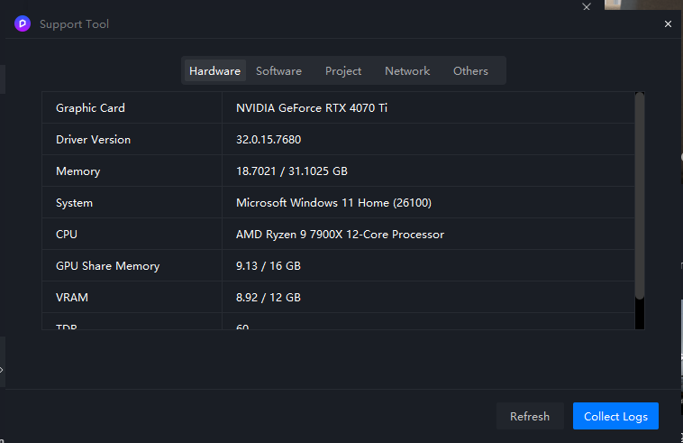

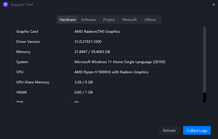

  • This is indeed unnatural and should not be happening on your device considering that a lower-spec device was able to handle the file and render them successfully. We may need to investigate this issue further, please generate a log file for us and send it to support@d5techs.com
  • Log File - How to use Support Tool? | User Manual
