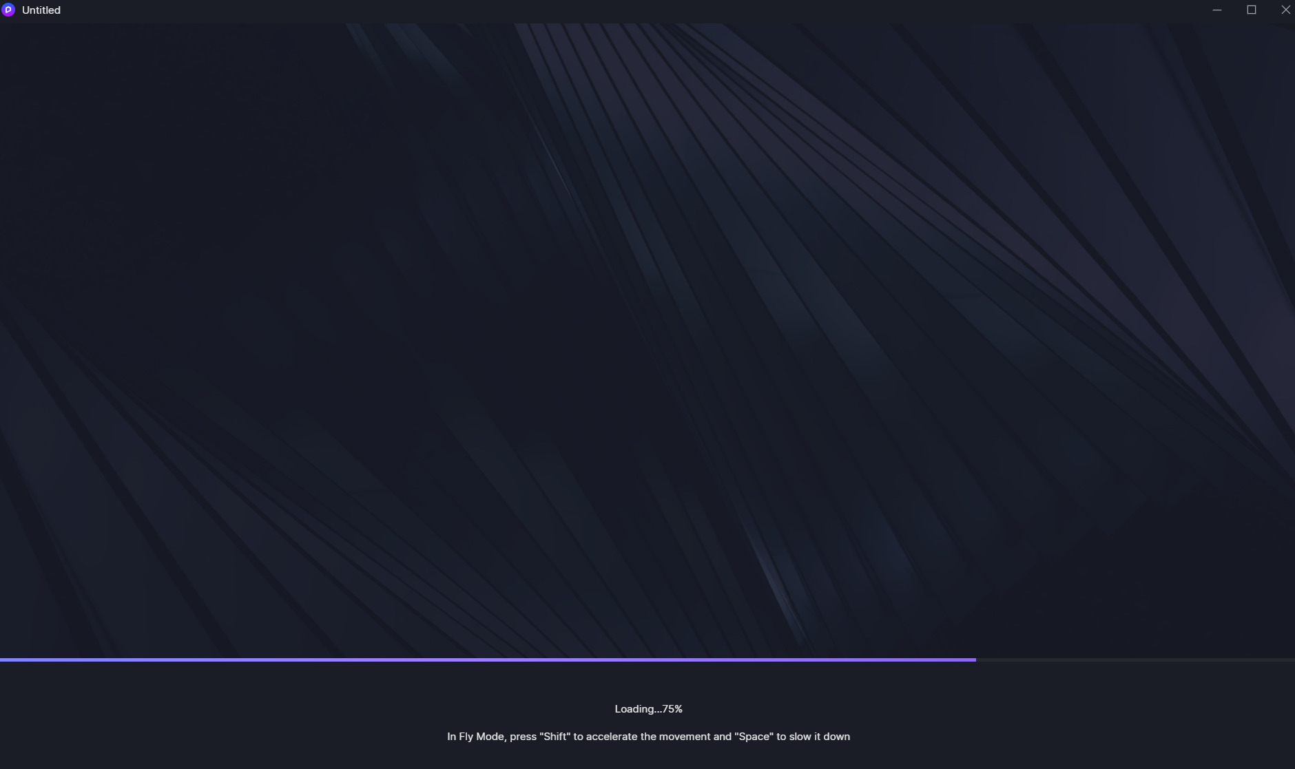

D5 File not loading at 75%
**D5 Render Version:**2.10.1.0579
**Graphics Card:**RTX4050
**Driver Version:**NVIDIA Studio Driver 576.02
**Issue Description:**D5 not loading

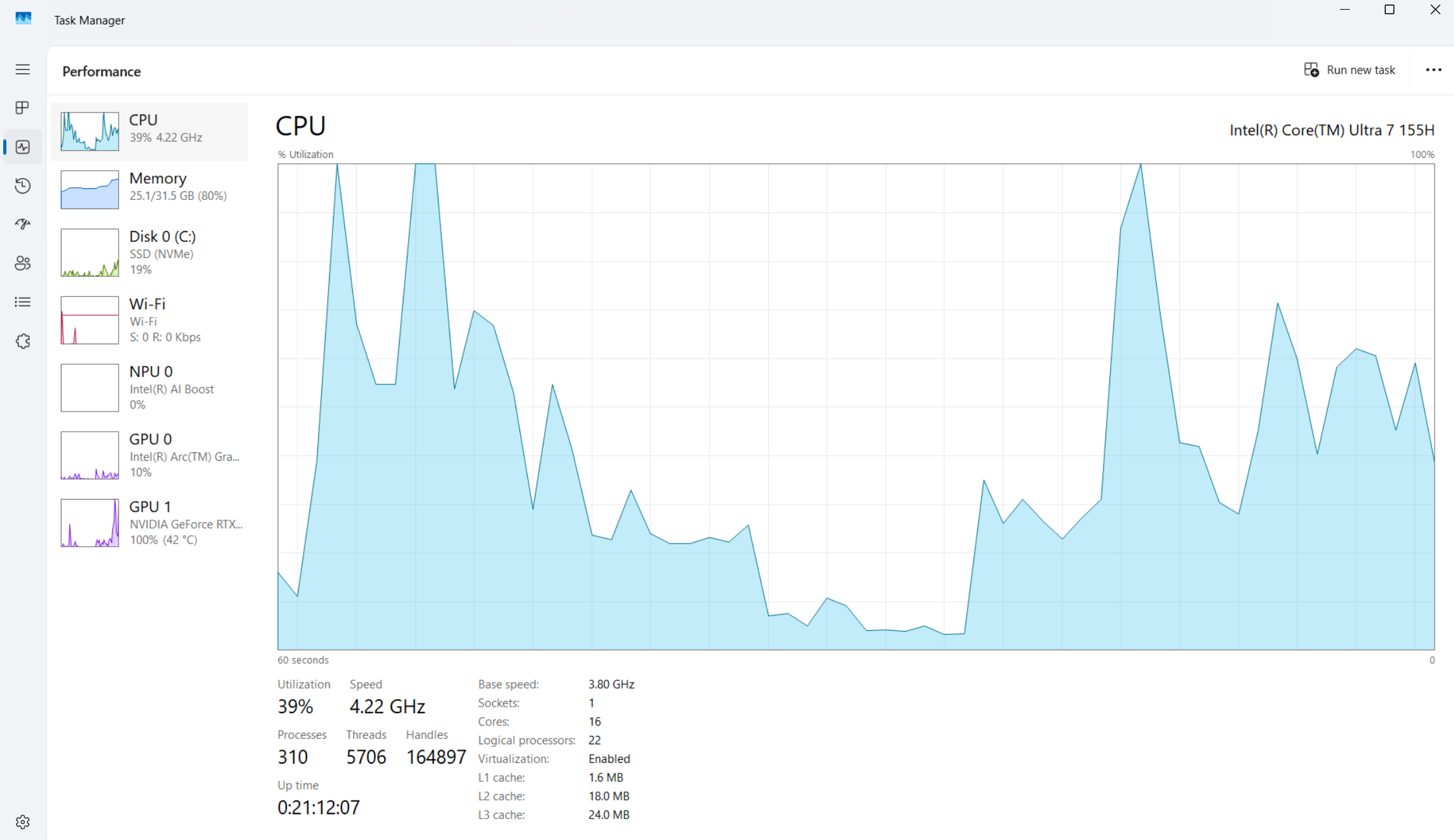

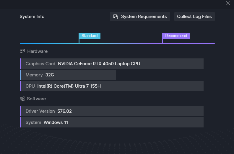

Here is the system info:
This only happens to larger files. If I open a small file it won’t cause that issue.
I didn’t touch the files in D5 folder.

  • First and foremost, I recommend installing 572.47 Version for NVIDIA Drivers

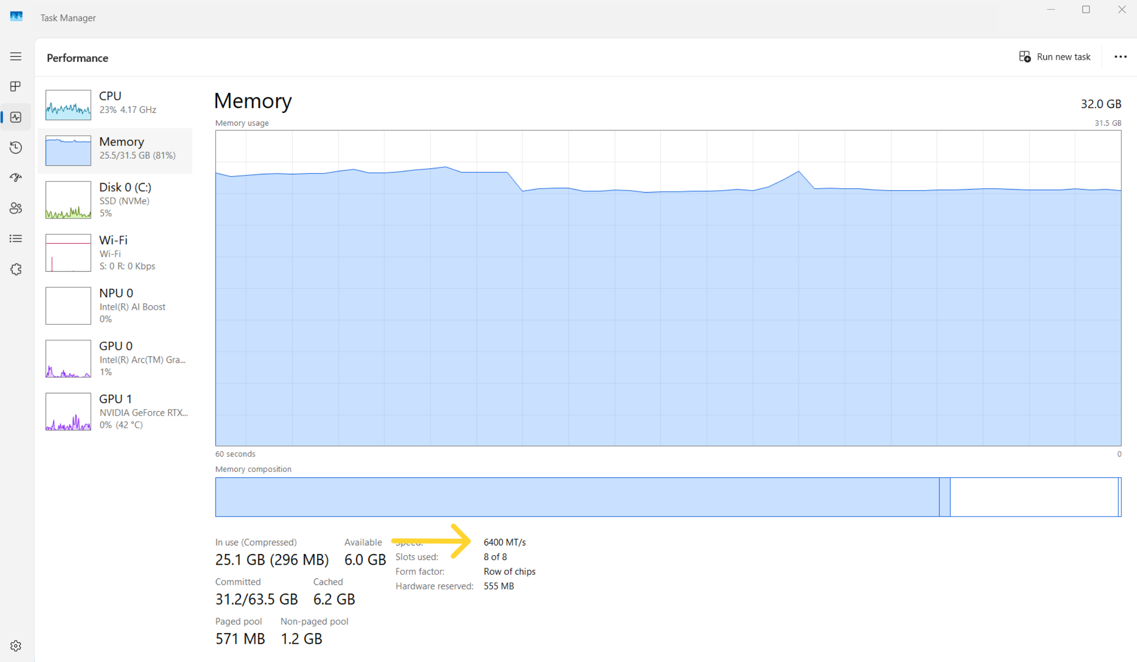

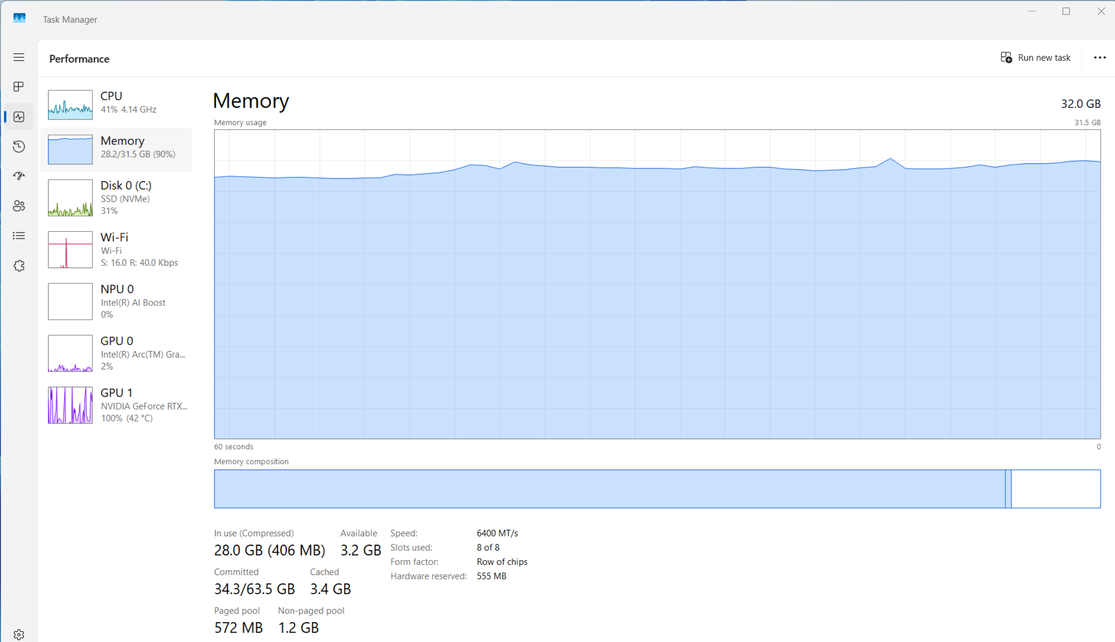

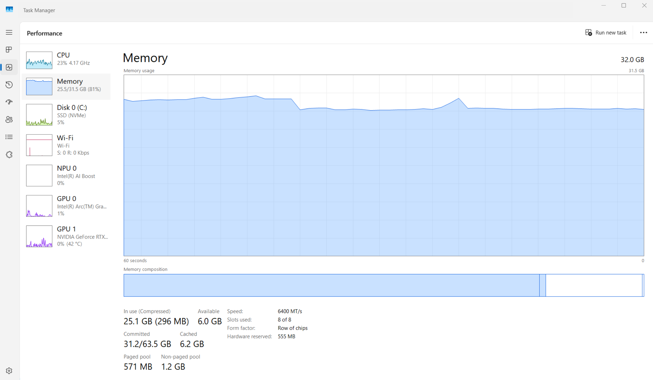

  • Your memory speed seems to be too high, it’s around 6400 MT/s. We do recommend keeping it at 4000 MT/s or below, 4800 MT/s should also be okay.
Since you have also mentioned that this only occurs with Heavy files, then there is a huge possibility that it may be caused by excessive GPU usage because of many assets that were used. Please optimize your file by disabling Dynamic Assets, Running Smooth Mode, etc.
  • Another solution is to delete the ‘f2’ folder under your WorkSpace path and then reopen the archive. Once it’s open, refrain from updating the assets until you have lightened your scene file by deleting some assets, including procedurally generated vines. This will help prevent it from crashing again due to excessive video memory usage.
