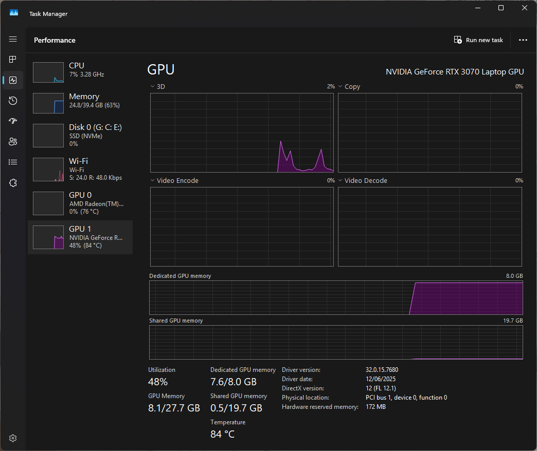

Hello,
I was working on my project yesterday without any issues. However, today when I tried to open it, D5 displayed a warning that the TDR delay value on my system seems low. This is strange, as I had already addressed this warning when I first installed D5, and it appeared to have been resolved.
I allowed D5 to apply the suggested fix, but the program crashed during the process. Since then, every time I try to open that specific project file, D5 crashes while loading it.
I’ve already updated my graphics card drivers and rebooted the system, but the problem persists. I also tried opening the file on another machine, and D5 reports that the project file is corrupted.
Could you please help me resolve this issue? I’m happy to share the file with you if needed.
Below are my system specs
Thank you!
**D5 Render Version: 2.10.1.0579
**Graphics Card: RTX 3080 Ti Laptop
**Driver Version: Nvidia Studio Driver 576.80

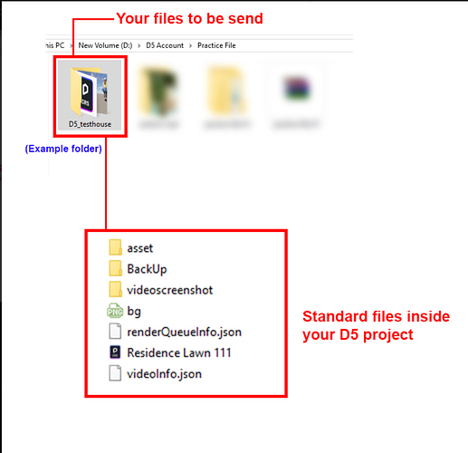

I apologize for the inconvenience. Did you perhaps transfer the .drs file location out side of the file folder? Or perhaps rename it? Were there any actions that might have caused the File Corruption to happen?

We can’t seem to download the file due to the website you are using. Please send us again, and this time, I highly suggest using either Google Drive or WeTransfer.
Additionally, There’s no issue when it comes to:
  • Storing these files on a Cloud Storage, unless you are currently opening it and editing/doing some work while being placed in the Cloud Storage. We recommend placing them first in a local file path if you plan on opening these files. Since we have yet to optimize this workflow, it may cause some issues.
  • Creating a new copy of a particular file via the “Save-As” button should have no issues.
