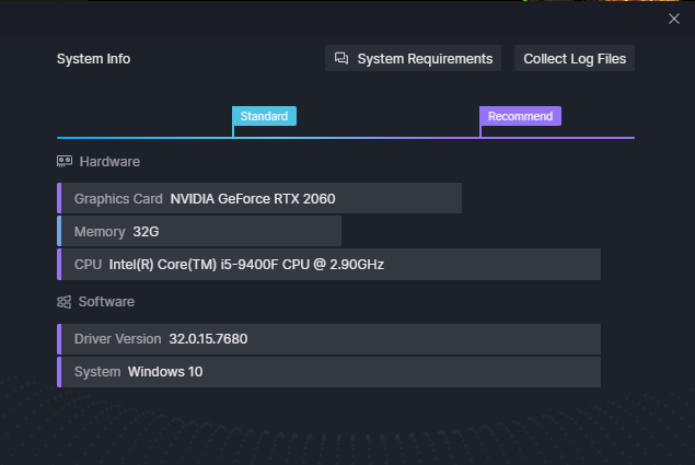

D5 Render Version: 2.10.1.0579
Graphics Card: rtx 2060\6gb
Driver Version: 576.80
Issue Description: Crashes in any size scenes
Steps to Reproduce (optional): Was workin on one big projext, firstly was good, but slow in the end. Then it started to crush (mouse freezes and had to reset my PC). Tried different nvidia drivers (studio and game ready versions). Dont know whats happend.
Empty scene warks good i suppose.
Mid size and big size scenes crush in couple of mins.
WIN 10 22h2, 32 gb ram

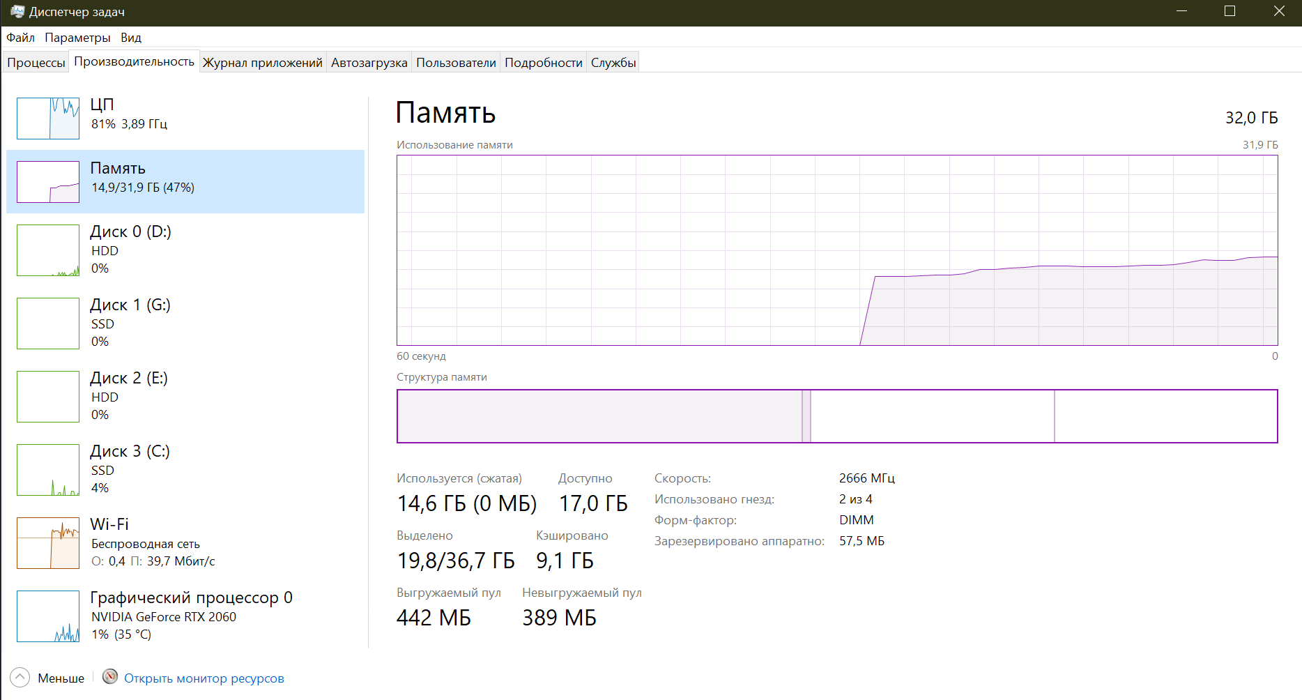

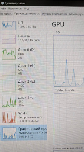

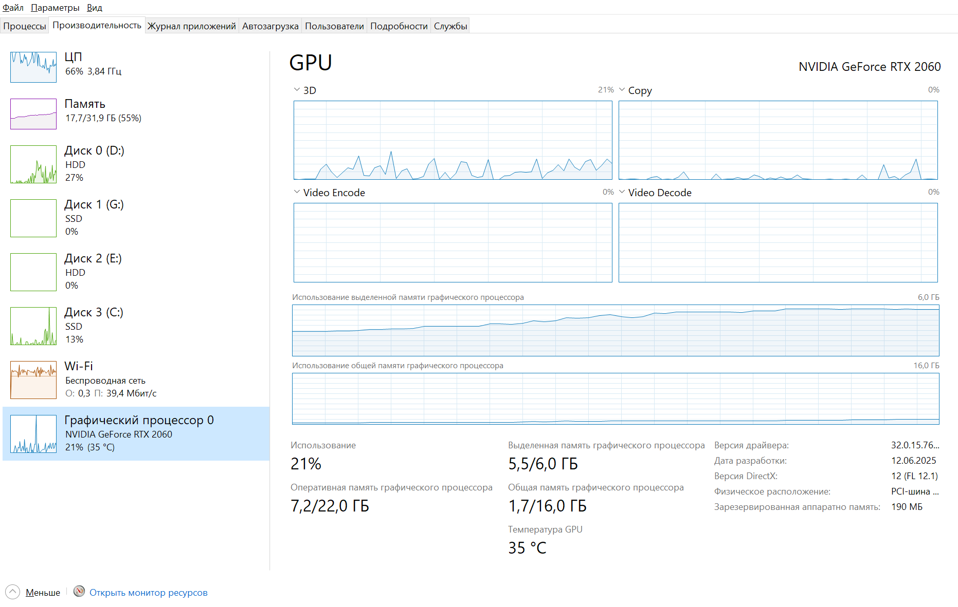

By the way this is the moment of total freezing. You can see that CPU (ЦП) is fully loaded. GPU and RAM are good i suppose.

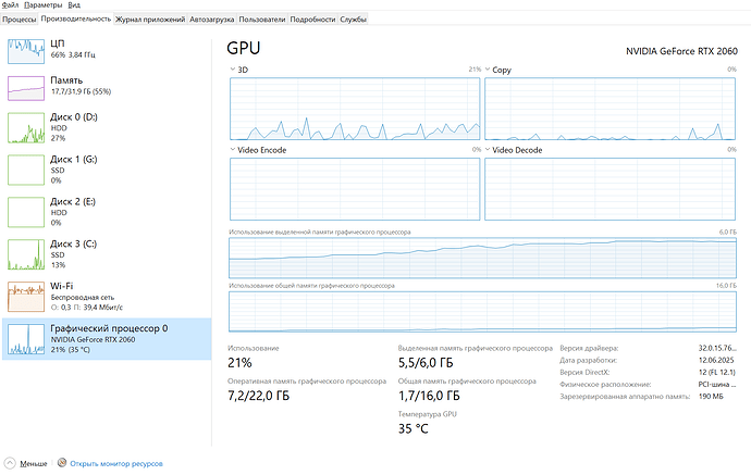

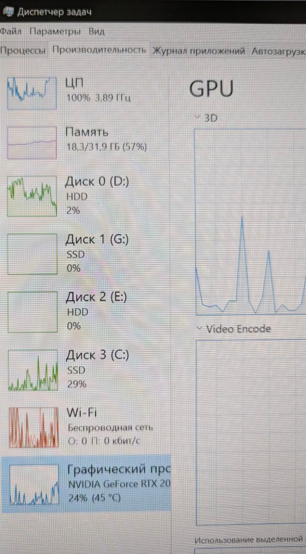

Next time it crushed a bit later, when CPU was not so loaded (image 2)
