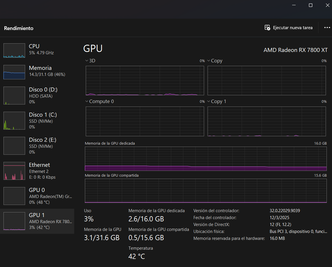

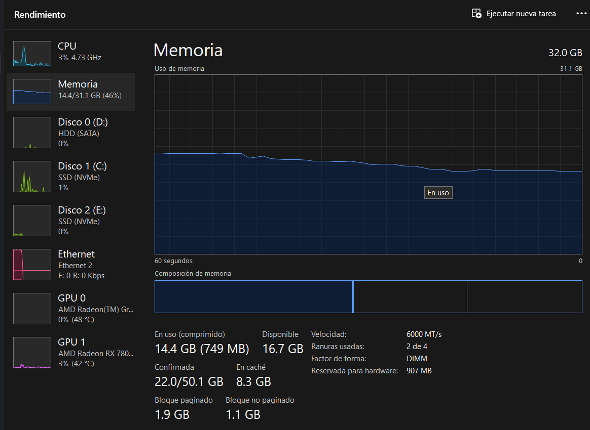

**Issue Description: Hello, I’m used to using another render software most of the time, but I thought of giving D5 a try. I have downloaded the software opened a new file in it, and it works fine, but after I created one file, if I try to create a new one and move the camera in it the program just instantly closes, I can still move around the menus and switch the sun path and time, but if in any way i try to click or move the camera in the viewpoert the app closes, Its just a straight loop, I install the software create a file works fine, open a new one move the camera and it closes. I have to uninstall the program with a advance uninstaller that doesn’t leave cache sush as REVO for it to work again. My main idea with the program is to use a Rhino file for my architecture project but there it comes again I tried using Livesync, but if I open D5 through Livesync, it closes. I even tried moving my rhino project in Revit and using Revit Livesync, and it doesn’t work. idk what to do at this point. Also, just to mention, there is no GPU spikes. When the program is open my GPU sits at around 70% usage and when I move the camera, it doesn’t spike, **

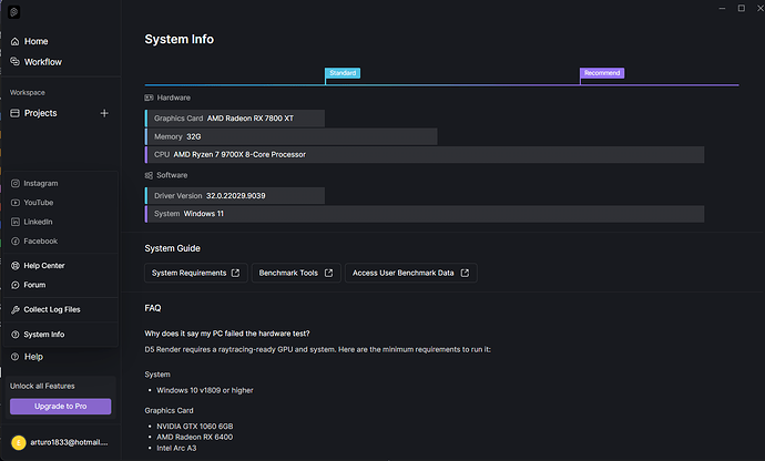

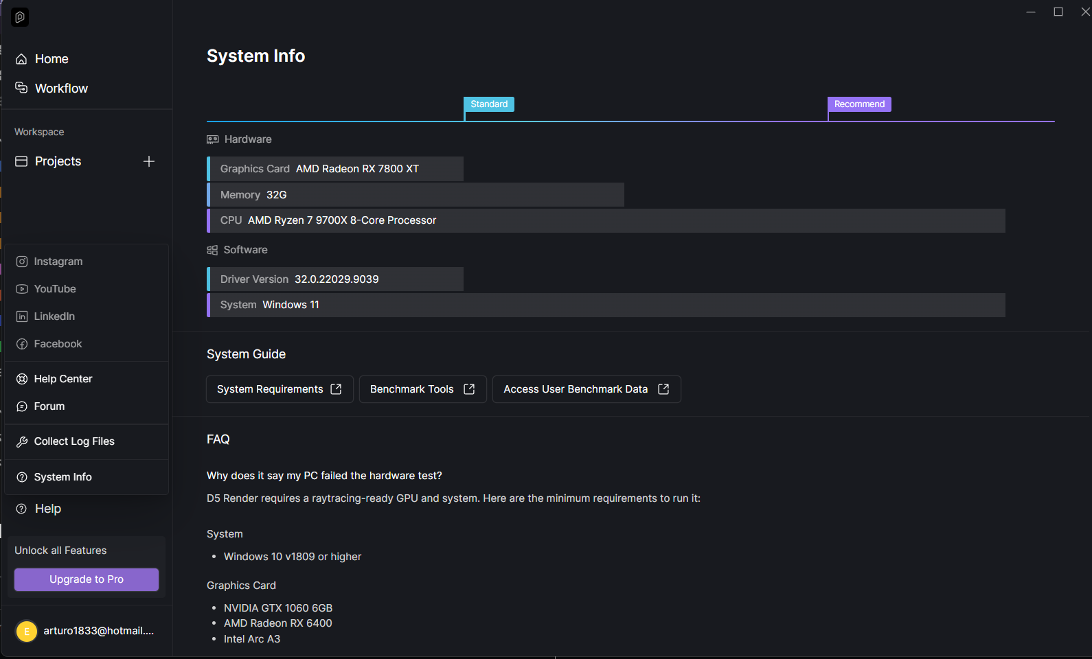

To help us investigate this further, could you please share the following:
A screenshot of your D5 System Info

Hi @arturo1833
Thank you for sharing your system information. Your stats look normal overall. However, this issue may be related to a recent known issue affecting AMD graphics cards.
We recommend referring to our official documentation and rolling back your AMD GPU driver to a stable version as outlined there. Several users have reported similar behavior that was resolved after reverting the driver.
Please let us know once you’ve tried this, or if the issue persists afterward—we’ll be happy to continue assisting you. Thank you
