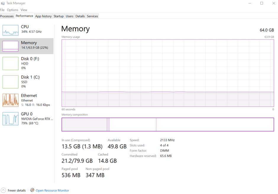

This is performance settings whilst D5 idle with a very simple scene (only 25,000 faces):

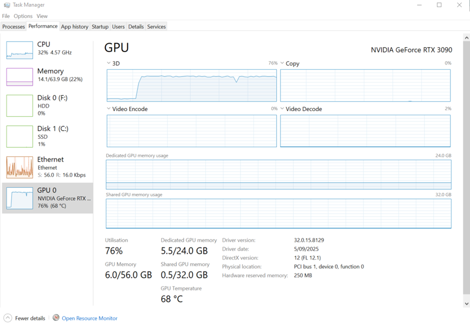

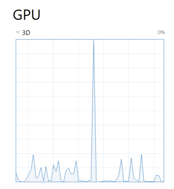

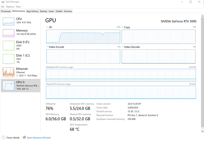

This is GPU spiking at time of a crash:

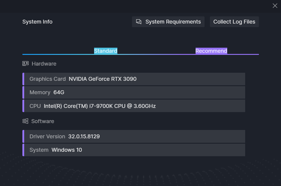

I apologize for the inconvenience. Can we collect the following on your end:
You may send it to support@d5techs.com and have it titled Clov-Forum D5 Constantly crashing without warning. Let me know if you have sent it already.

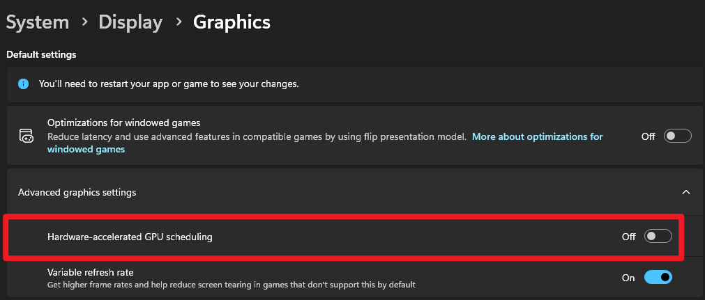

Please try the following:
  • Disable Hardware Accelerated option
  • Try to rename your Workspace folder to something else, then after renaming, try to open an empty file or a d5 file.
  • According to your log files, it has detected 3 GPUs. Please ensure that D5 is using the RTX GPU. You can either change the NVIDIA Control Panel or disable the other 2, then try running D5 again.
    Snipaste_2025-09-25_10-22-41
I suggest trying the proposed solutions individually instead of doing it all at the same time and please let me know if there are any improvements.
