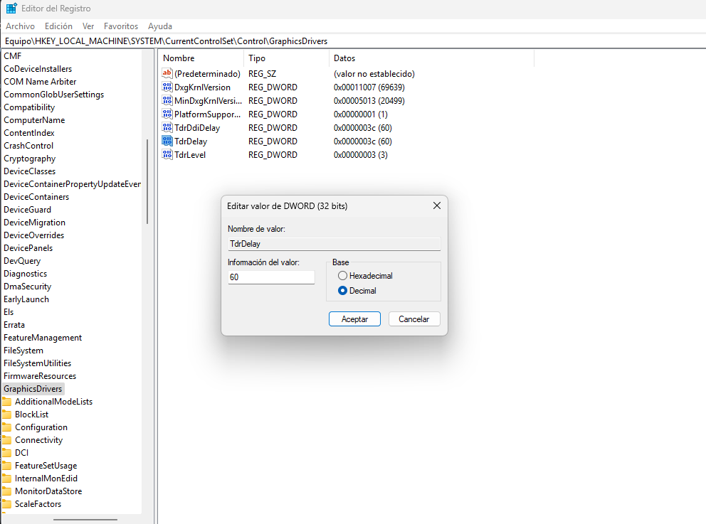

i tried manually setting TDRdelay in Register Editor to 120 but d5 still crashes when i create a new project or open any project

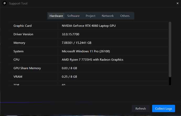

  • The image you have sent is not the logs, you need to click “Collect Logs” to generate a zipped log file.

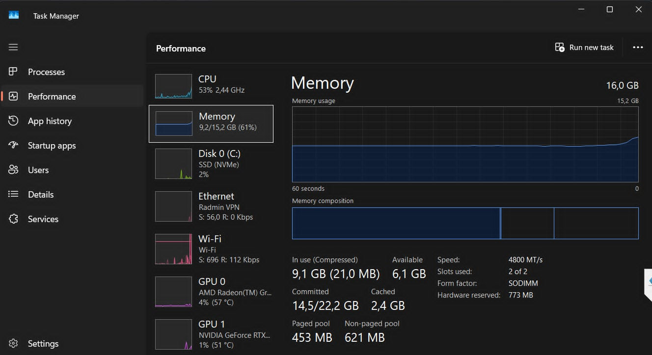

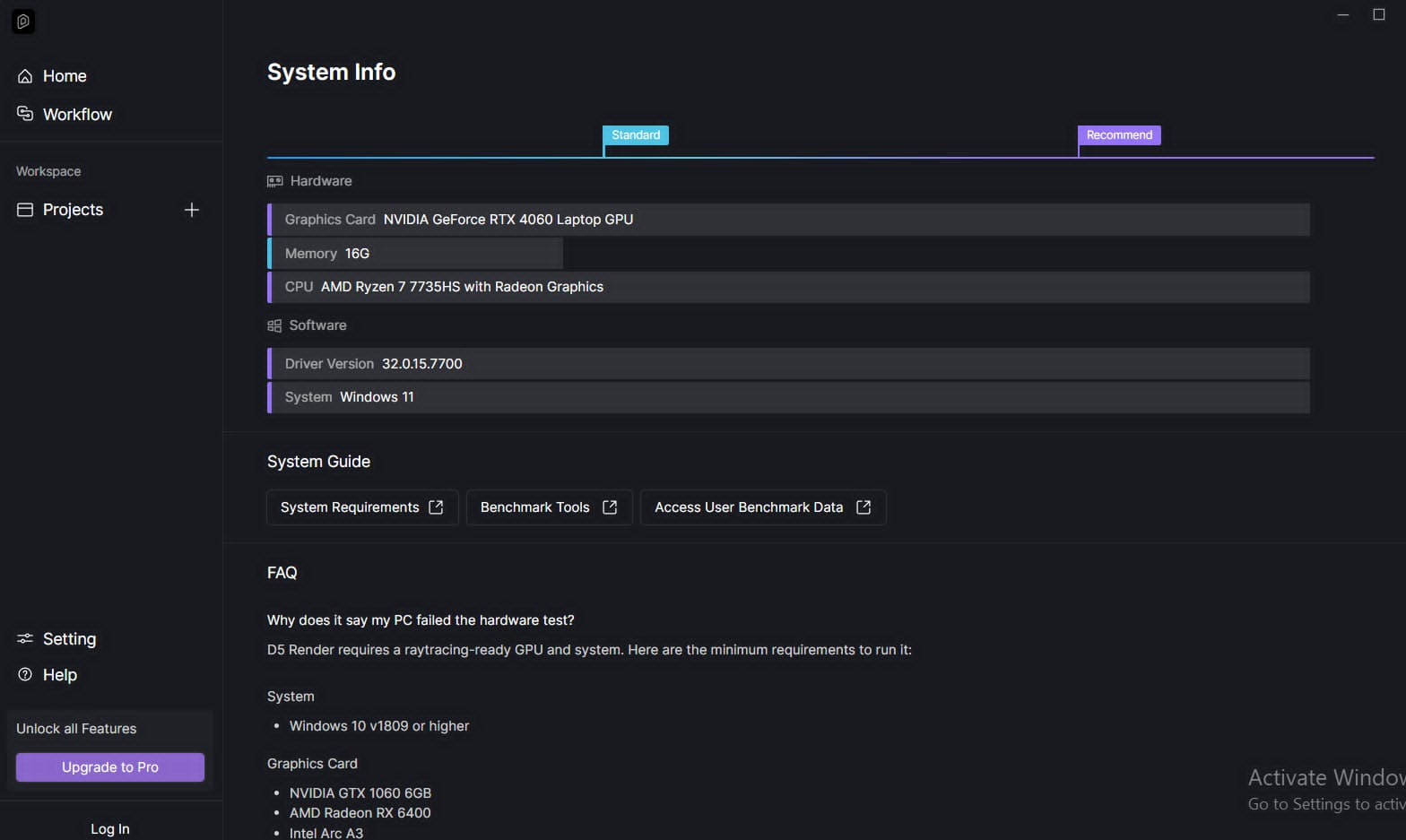

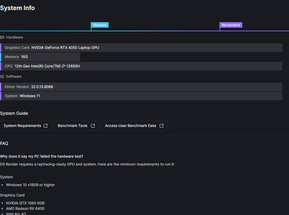

What is his System Info, VRAM, and Memory Speed? Please send these images.

About my friend’s problem: he tried installing an older version: 2.10 and it worked at first. However, when he restarted his laptop and opened it again, it only ran to 99% and then disappeared:
  • The problem occurs with all files
  • Tried opening a blank file or Demo Scene but it didn’t work.
System Info:
VRAM:
Memory Speed:

Is the TDR Error prompt still evident? After the above steps are finished, have you rebooted your device? Remember to reboot your computer; otherwise, the change will not take effect.
Hi. Thanks for the answer.

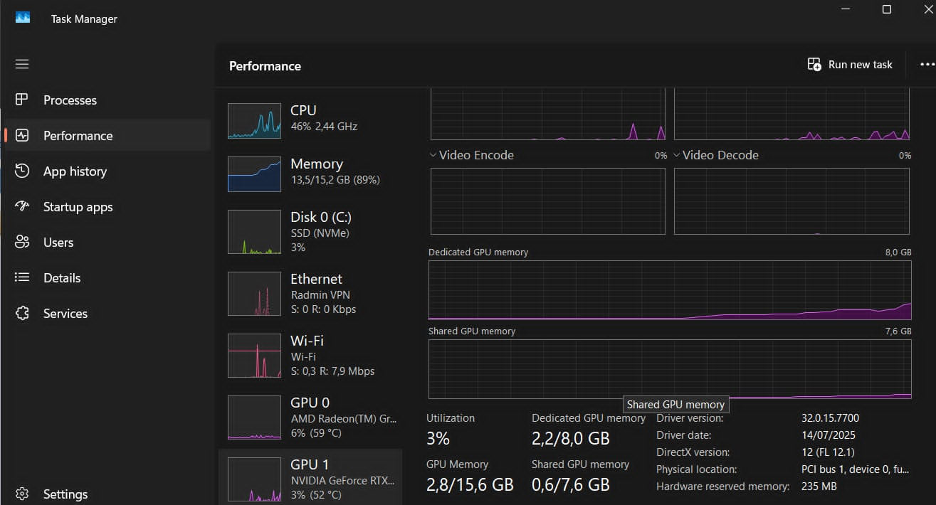

Still doesn’t work. I rebooted my pc and still crashes when it gets 99%. The file has vegetation with scatter tool
Hi @daniel.saballos
I may need to check these files on your end. Please check your inbox.
[Update] User was unable to open the specific file because of the size and number of Scatter and Vegetation Assets used, also considering 6GB VRAM may not be able to handle such large assets.
Solution: Delete f2 folder (pak files) then optimize the file before updating.
