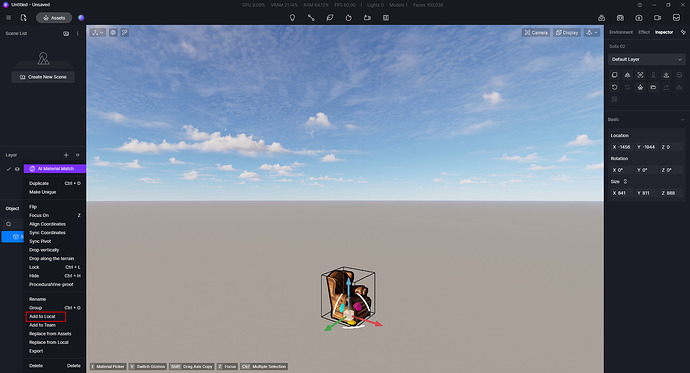

Hi! If you want to save this assets, you can also add it to local.
