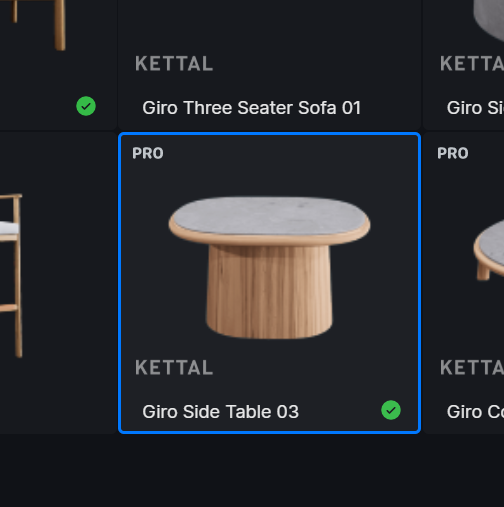

Issue Description:
Hi crew!
While working in D5 saving directly into dropbox (so I can WFH in the same models) the finishes of the assets start to drop off and show white.
Any way to fix this and get the original materials back?
