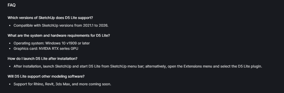

Something else strange that’s happening is that it’s telling me the hardware requirements for the Lite version aren’t met. But it’s showing me this.
What requirement isn’t being met?

Hello
Lite only supports NVDIA RTX Series GPU for now. :pray:
