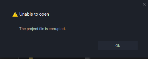

Issue Description: Opening this one file says its corrupted, didn’t change it, it has 55kb, lot of work sits in it, but i cant access it

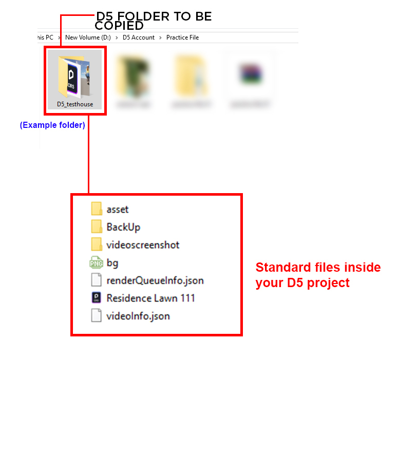

If you’re trying to transfer the project, please make sure to copy the entire project folder, not just the .drs file. The .drs file alone doesn’t contain all the linked data and assets — moving it without the full folder can cause corruption or missing file errors.
Please try restoring or opening the file from its original folder. If the problem persists, let us know the project’s save path and whether it was stored locally or on a cloud drive, so we can further assist.

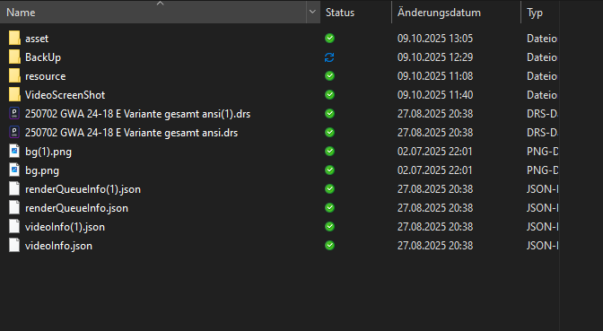

it was stored on an icloud storage and another cloud, 2nd cloud (Ionos) didnt store the whole data, since the strukture where too long, i guess thats the trouble at all, the cloud might corrupted the files, as you can see they saved as (1) too, which did the cloudservice not me. im going to save locally on the next projects, still hoping to revive this file since it has a week of work in it.Text
downloaded the files from icloud browser, and now they working
