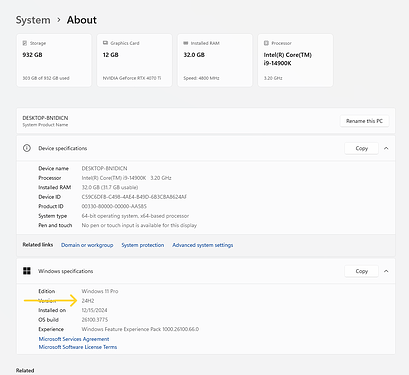

Hi @Clov
It’s always restarting the pc, can’t even open d5.
I’ll attach the system details here below
Thanks.
Hi @nithinpaul4444
Thank you so much for providing these images. Please try the following probable solution:
  • Intel Core i9-13900K/KF/KS and i9-14900K/KF/KS - Please try to update your BIOS, Intel has released a new microcode patch**(0x129)** to its OEM/ODM partners. You may visit the motherboard’s official website to update the BIOS version.
  • Windows 24H2 - Please try to revert to a different Windows version other than Windows 24H2 and see if the issue persists.
  • Disable CPU or GPU Overclocking
