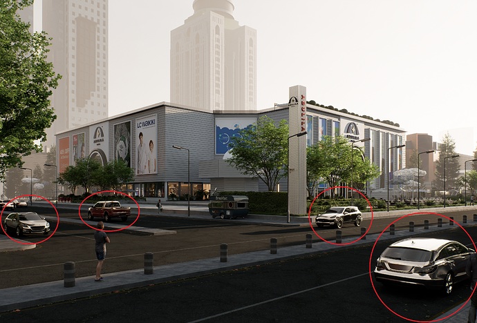

Hello , I noticed recently that the car material is so shiny and the reflection is so unrealistic
it doesn’t look like a clear coat paint , its like it has a roughness map applied to it.
I hope you guys fix it asap
here are some examples
the car on the left is a car that I imported and applied custom materials to it , the one on the right is a car from the asset library
here is another shot
Look at how the cars reflect allot of white color and the reflection is making them look like they have mirror material

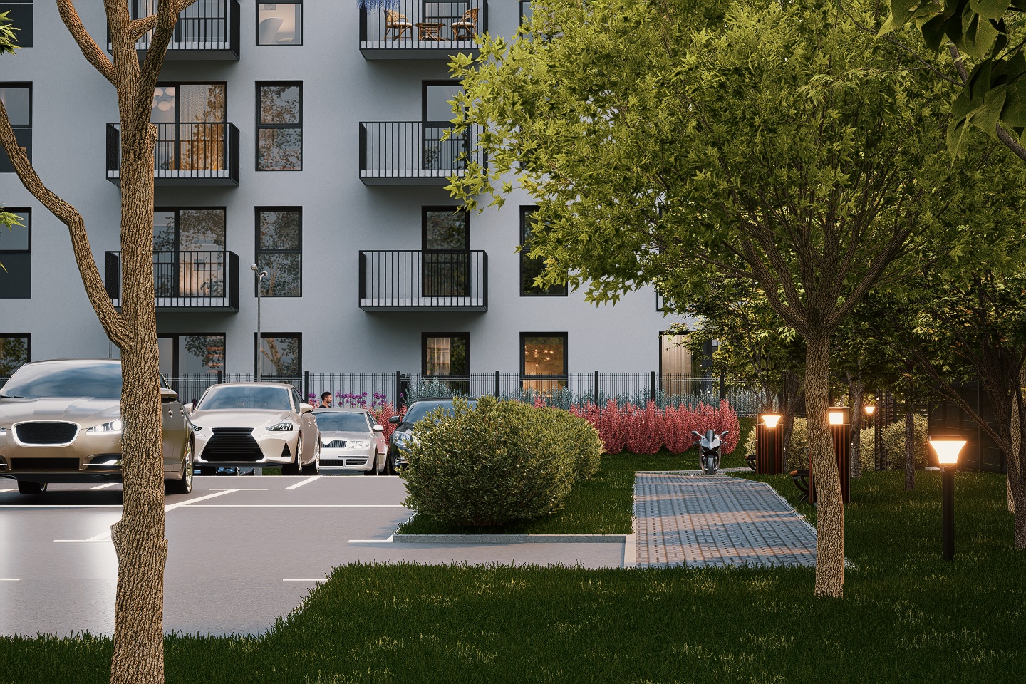

It’s 2025 - I didn’t had this problem before but now with the new updates I think the problem happens again. Cars are having so white reflections that they look awful and unrealistic. Any manipulation with car clearcoats doesn’t work. All assets are from library.
Here is the shot from 4k render

I’ve tried yesterday version 2.9 and 2.8 and everything looked the same at this scene. Well it’s wierd and now it’s interesting cause even if I use Altitude and Azimuth to change sun position and I make a tree shadow on the car it look exactly the same at this point. All car is darker, but not this point.
But when I change hdri wheather at Overcast from studio it looks better.
But you know- this is not the mood I want to use at my scene. I will have to play at Photoshop with both renders. Well :slight_smile:

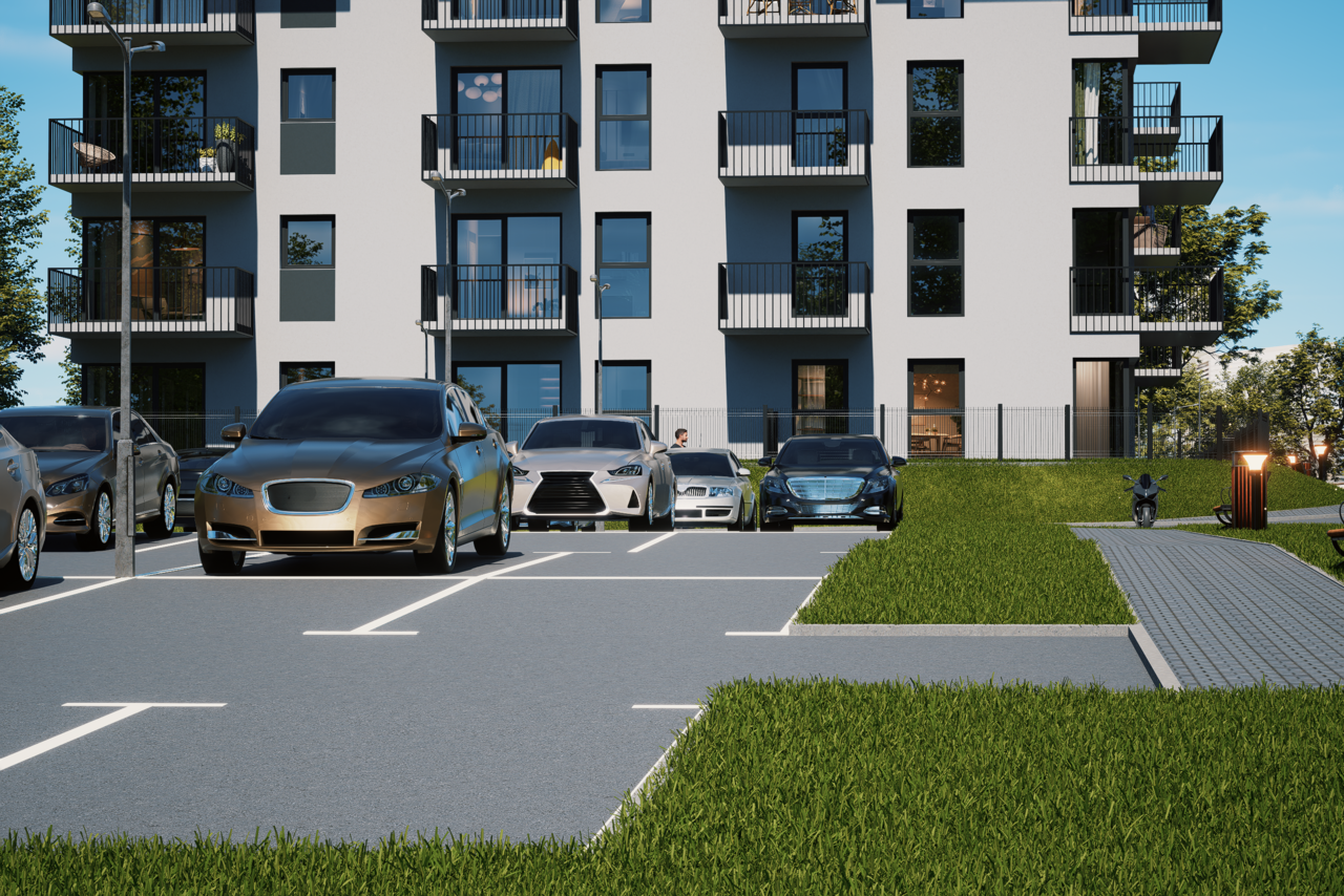

While writing I’ve rendered another scene with some Exterior-Day from Studio.
I don’t know - I don’t like these reflections. They don’t look natural. Of course in the real life it will reflect but I guess you know what I mean.
Any of these pictures doesn’t look good for me. What do you think?
I think it might need some updates in the future on this topic.
Later I will do rest of my renders and I will see if it will repeat.

We’ve pinpointed the problem, and it appears to be related to the “Fog” setting being enabled. For the time being, disabling Fog should resolve the issue. We’re working on a permanent solution that will address this issue in subsequent releases.
Thanks for your support! It indeed turned out to be the fog problem. Thanks to you, I now know how to work with it — and it’s great to hear that you’re working on a permanent solution!
