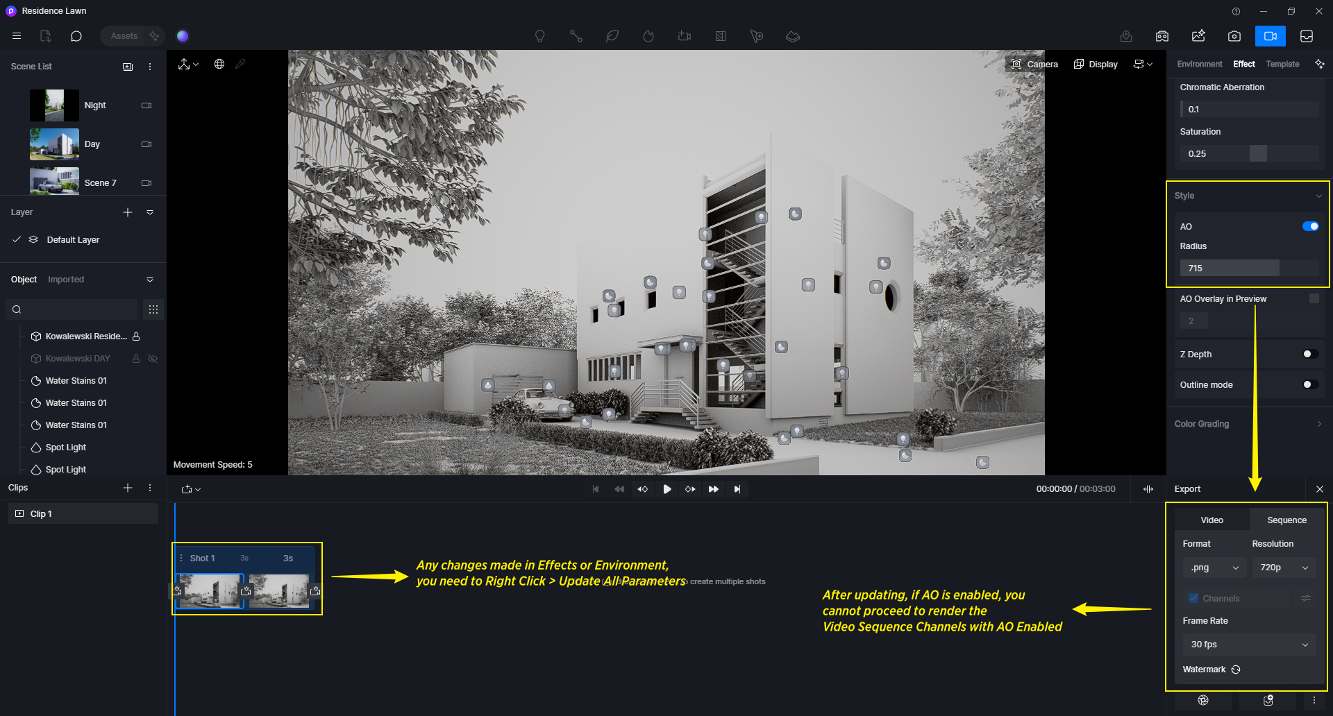

Enabling AO in the Effects Tab and at the same time rendering a video sequence with channels enabled is not supported. So, you can’t basically render the channels when AO is activated.
I’m not sure how you were able to render the Channels with AO at 350 :thinking: , but I’ve run some tests on my end:

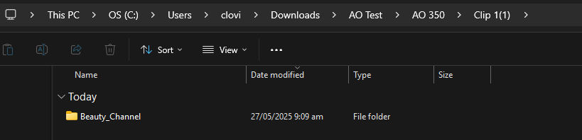

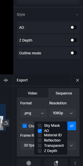

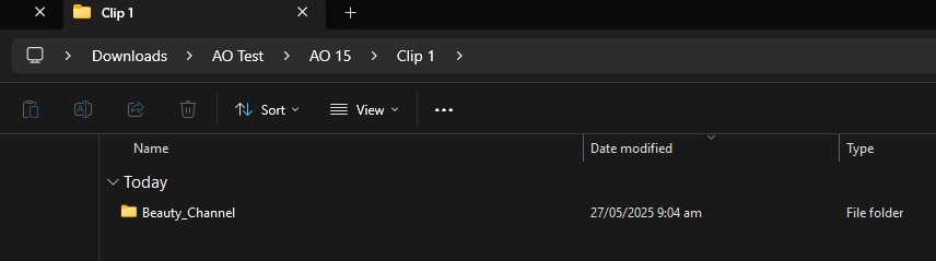

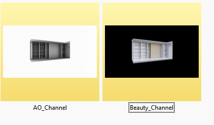

I´ll put some screenshots.
If I disable AO in effects, but I turn it on in channels, D5 renders with channel. But I dont have control of the radius. 350 is a default. Too big for my little project.

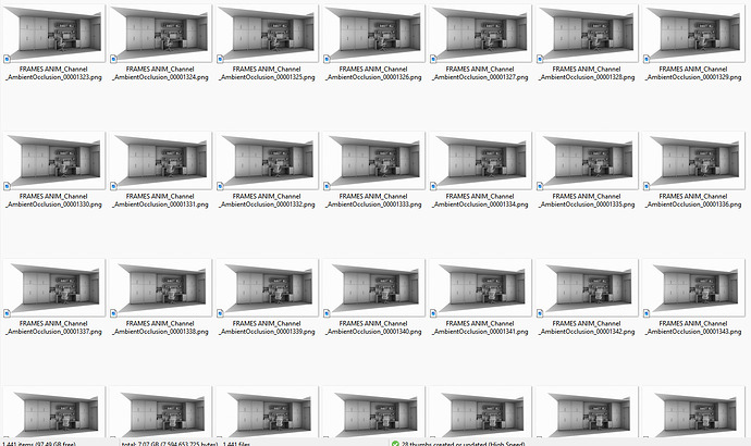

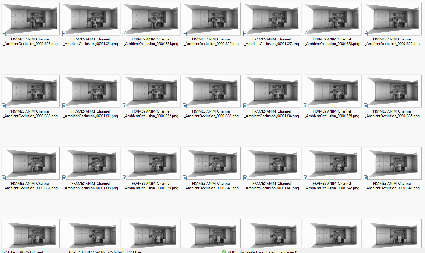

Here, both folders:
{50E3ABA8-290D-4538-A960-763D2641696D}
And, the PNG sequence inside folder:
Hi @theodecarvalho
Oh, oka,y I understand. I think I misunderstood because I thought you were able to enable AO in Effects and at the same time render the different Channels.
Indeed, this is under our expectation since for now, enabling AO Effect and at the same time rendering the different channels is not yet possible.
