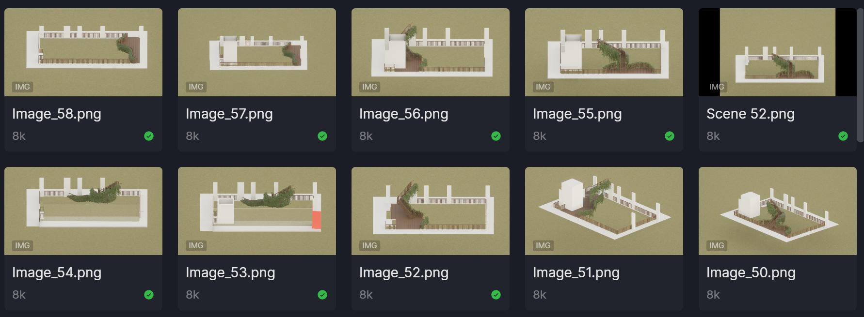

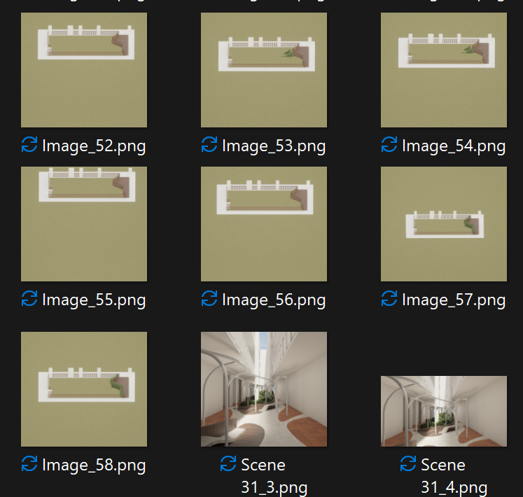

Hi, Im facing a similar issue but with Sketchup where my output renders are of the same scene and dont match the render queue thumbnails. Was there a solution to this issue? I waited really long for my renders :frowning:
