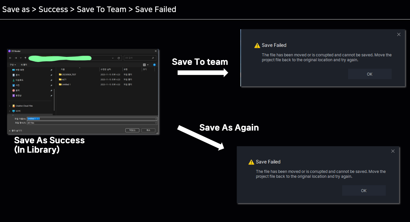

D5 Studio’s Team Space or Asset could be read from the set team library.
But. Team projects cannot be used.

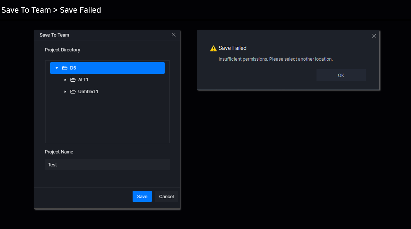

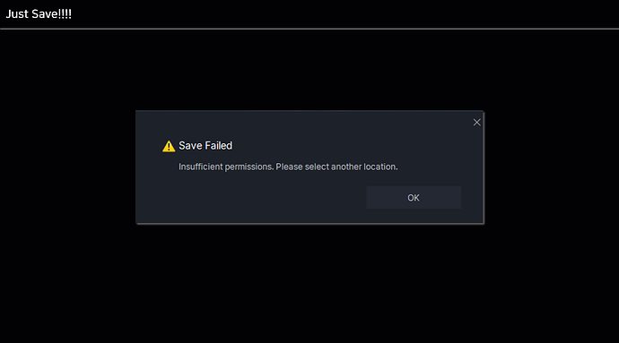

When Save a New File to the team library location I set. (open a new file with do nothing) ‘Save as’, ‘Save To Team’, or even ‘Save’ doesn’t work.
The ‘Convert to a Multi editor Project’ button is not visible at all.
It seems strange that it cannot be saved even though it was not created as a Central File.

I think there are only ways of Samba server deployment.
You can check this link for more information of managing team library. How to deploy team library and manage team assets | User Manual
