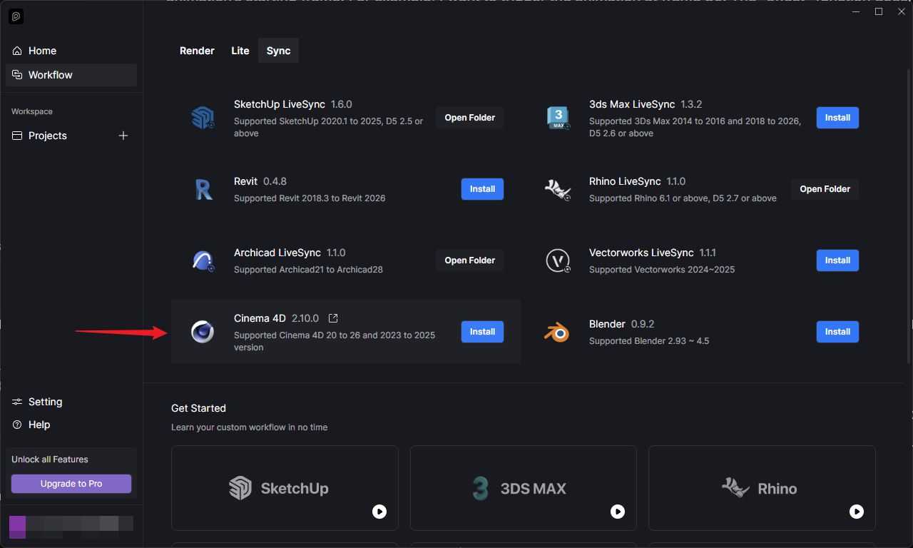

  • I suggest installing the newest plug-in version via d5launcher

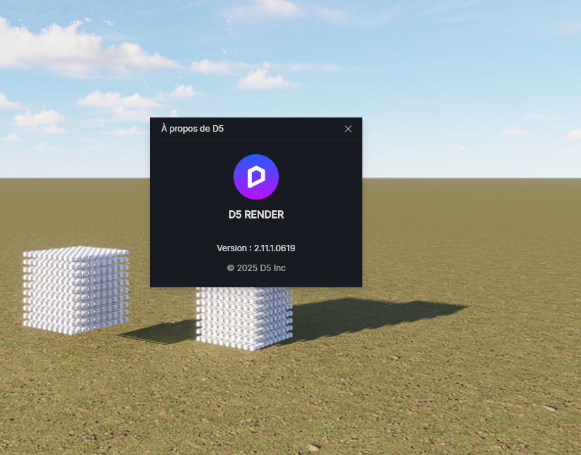

  • As for the abc file, this was a known issue in 2.11, where setting a custom animation range does not have any effect. This issue has been resolved in 2.11.1. Please update if you’re still not using the newest build. If the issue persists, I highly suggest sending us a screen recording.

I’m using the latest version of the plugin, downloaded to the launcher, and I’m using the latest version of D5R.

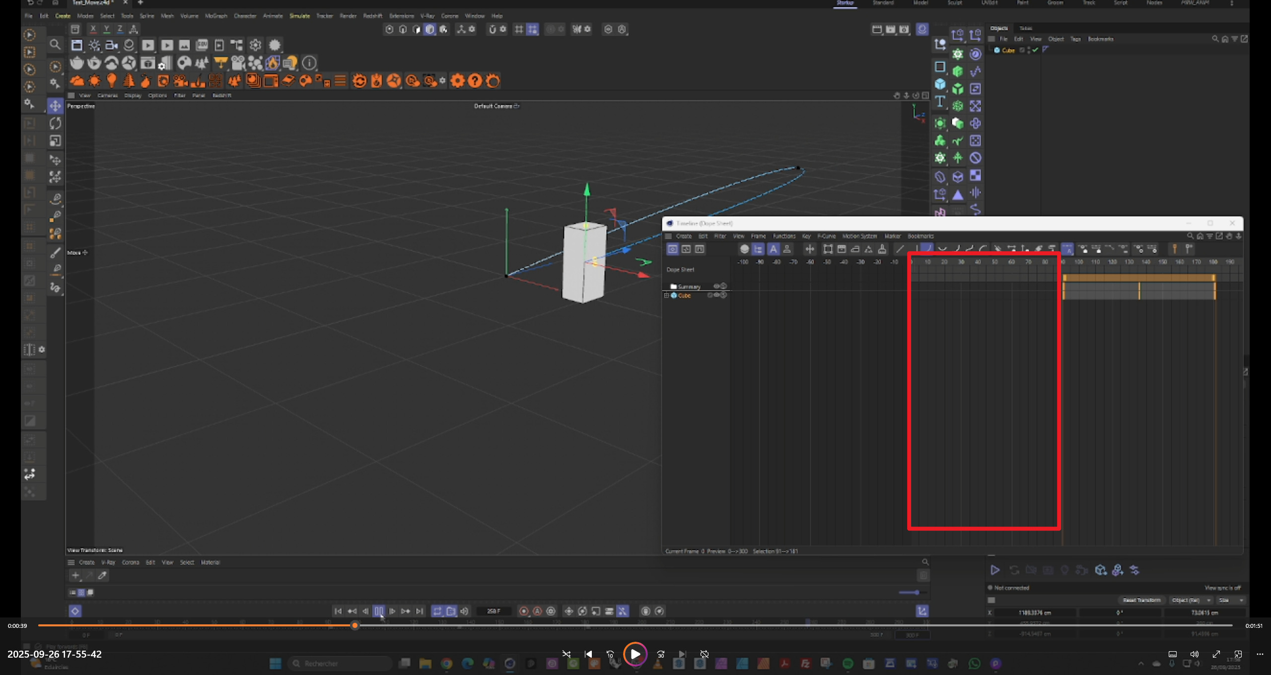

As you’ll see in the video, objects exported from C4D cannot be animated individually.
As you will also see, the range function only moves the start time of the animation and not the animation itself.

Thanks Gianluca, that’s what I’m doing. Unfortunately, I’m afraid Clov is right. The feature doesn’t seem to work on C4D at the moment. (See attached file.)
Regarding the Alembic animation offset, I’m using version 2.11, and it doesn’t work.
