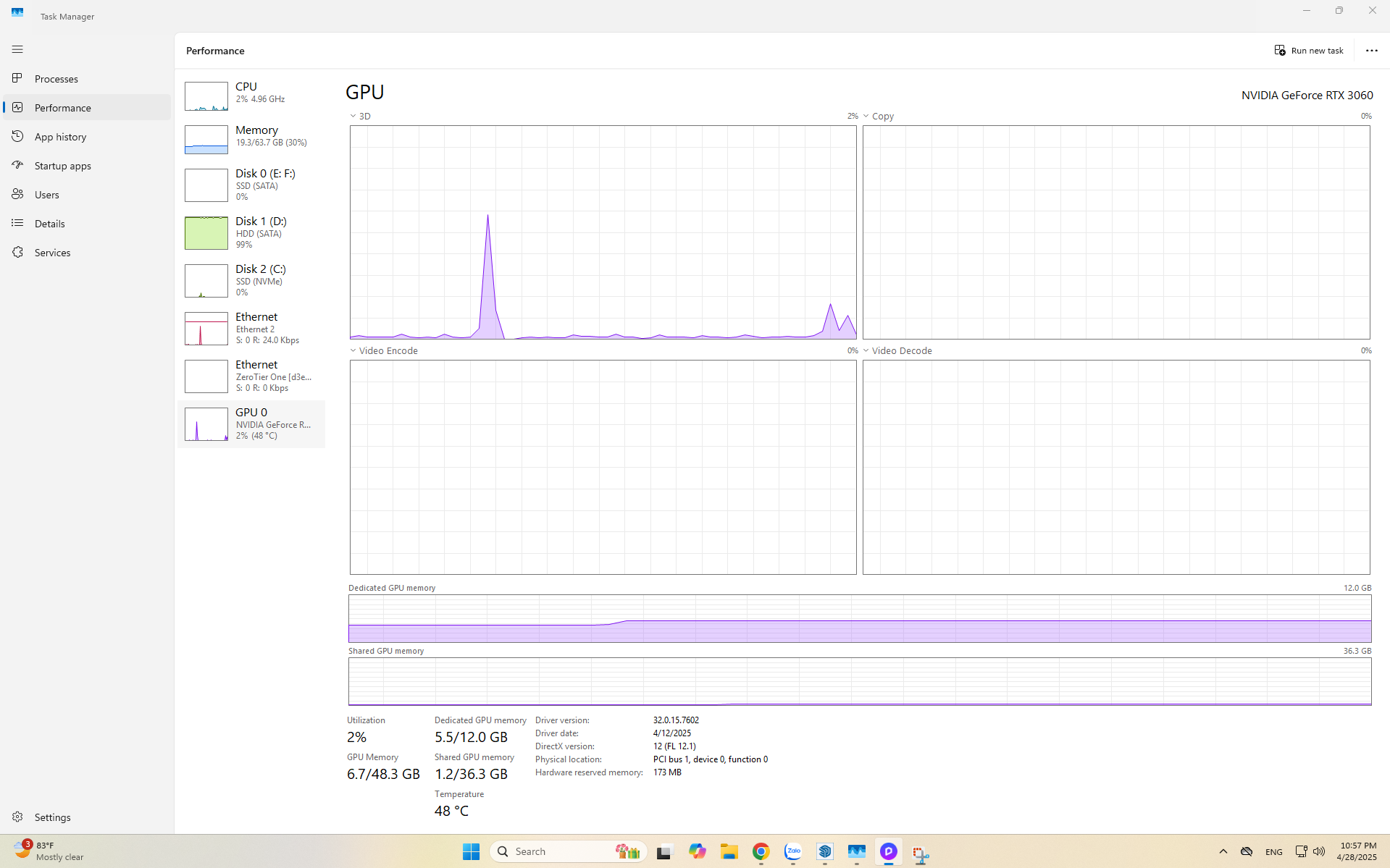

Although you have sent us your device’s information, we may still need the following images:

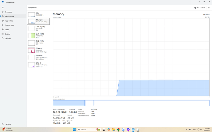

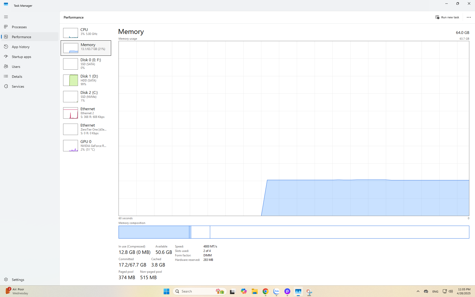

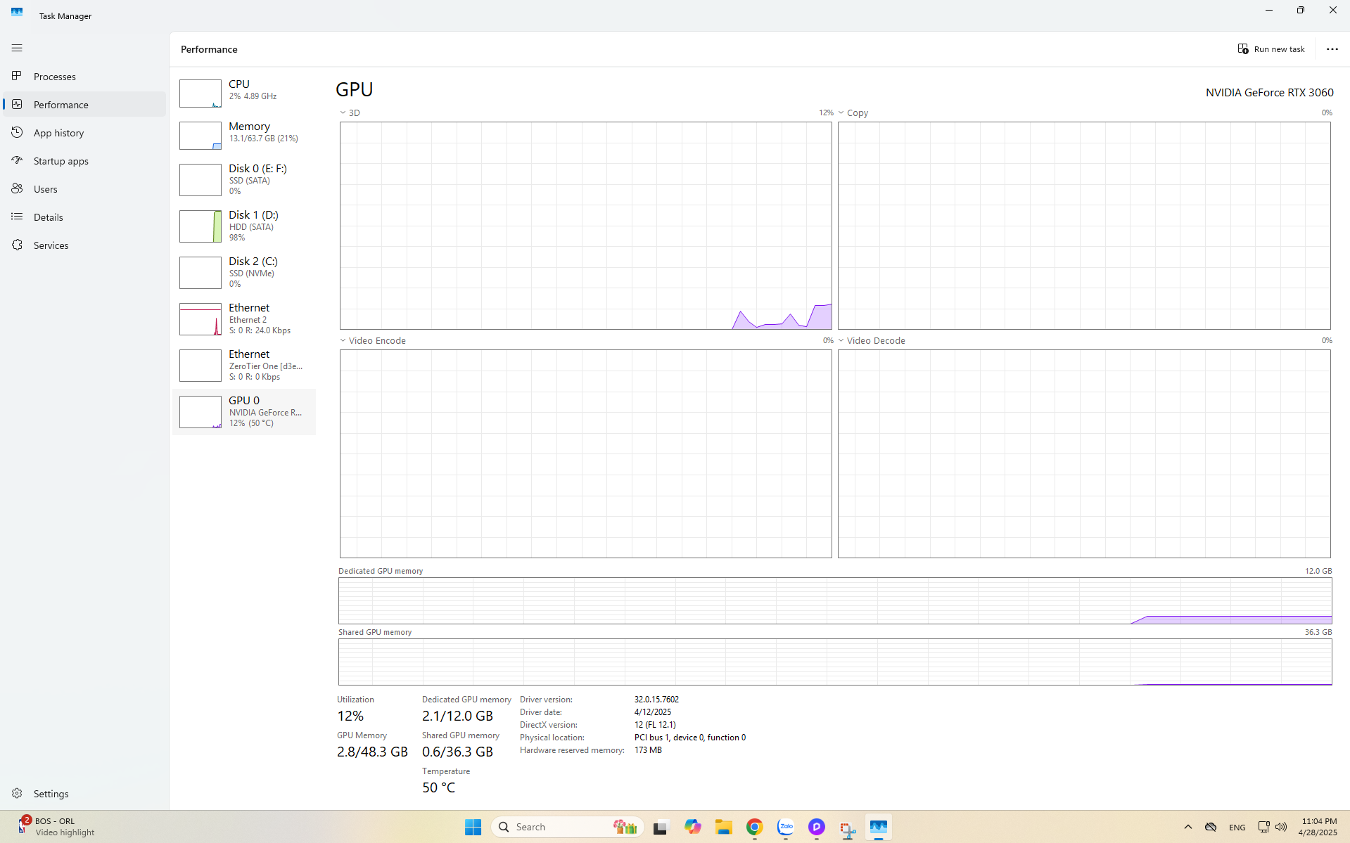

@Clov Sorry for the late response. I am sending the images you requested. I have also tried the troubleshooting methods you mentioned, but the results remain the same. I truly appreciate your support!
Hi @daddyproxx
Thanks for sending these images. There are points that I may need to point out based on it.
Please try the suggestions that I have given in my first reply.

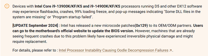

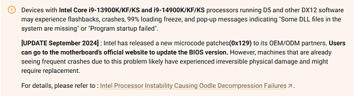

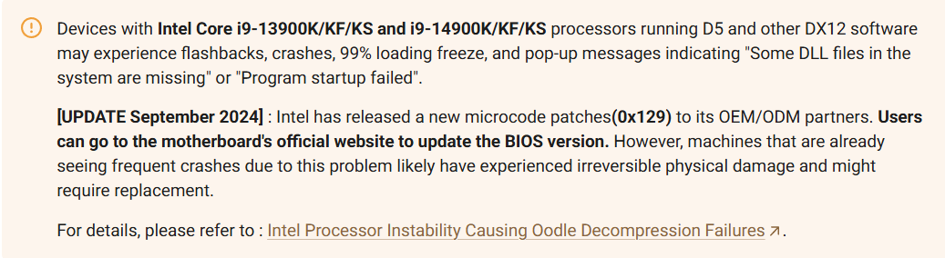

  • Since you’re using an i9 14900K CPU, please update your BIOS by visiting your motherboard’s official website.
  • Downgrade your Graphics Card Driver to 572.47 (Don’t Update to the latest one) since you’re using 576.02 which is known to cause some issues so its better to be safe.
