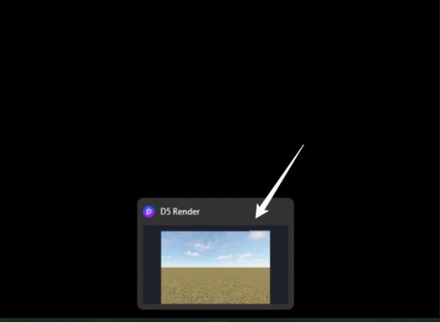

Blank window after starting new project (version 2.8)
When I load D5 and start a new project (or load an old project) the modeling screen is blank (see attached screenshot). When the app is minimizing I get a quick glimpse of the actual window.
How do I fix this problem?
I have a capable PC with an RTX 3090… and have a deadline for a render… !
Have tried reinstalling d5 multiple times (incl version 2.7), reinstalled the GPU drivers, did a windows update. Still no luck. Can only see the model briefly when minimising the application.

Even if I load a new empty project there is no view of the scene, just a white screen. It shows a brief glimpse of the project though when the window minimises.
This problem occurred immediately after updating to version 2.8.
Thought it might be GPU driver related, but have reinstalled the drivers and tested the GPU by running Twinmotion without a problem.

Then another thing, maybe I wasn’t clear, in the image you posted there isn’t the project loaded in the drop-down menu on your left. This makes me think, it’s like your job disappears. If the program doesn’t load it, you obviously don’t see it. but you tell me that when you iconify it it appears for a fraction of seconds. This is very strange, but you are not using the cloud, that is, you open the connection via the cloud. Usually if you use it for space or office reasons, it may happen that the connection with the cloud is missing, in this case you have to go to the program properties and put the address with the cloud connection properly.

Its odd - just noticed that the interface is correct when hovering over the icon in the dock, but instant turns to white when maximising the window:
I saw, but he only does it to this project, does he also do the same thing to your other works?

Hi @maslu This problem occurs for all files (new projects as well). I am going to have to shift to another software package as I cannot get D5 to work. Frustrating as I enjoy using D5.

@maslu. Unfortunately, reinstalling drivers and the D5 app did not resolve the issue. In the end I had to do a fresh install of windows and reinstall all the software. Then D5 worked correctly.
It proved to be a frustrating loss of a day to get everythiong up and running again. D5 is my preferred rending application and I did not want to have to begin the project fresh in another application.
Thanks for you help though.

Same issues for me , Asus rog g531gw laptop with rtx 2070 , tried all method . i dont want to reinstall os , that is stupid . all other programs work perfectly . its your development issue
Send us a screenshot of the D5 preview window and your GPU Info while opening the file @liquaard
Check the following:
  • If you hover your mouse on the D5 icon in the task bar, does the small window display correctly?
    → If yes, check if you’re using Windows High-contrast themes? Or are you using plugins like ‘Mica For Everyone’? Turn them off
  • If you’re on W11 disable this setting
