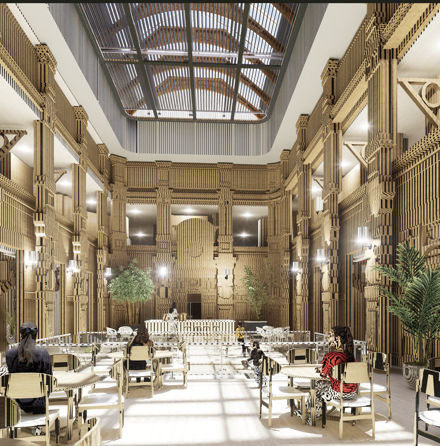

black lines in render
**D5 Render Version:**2.6.1.0423

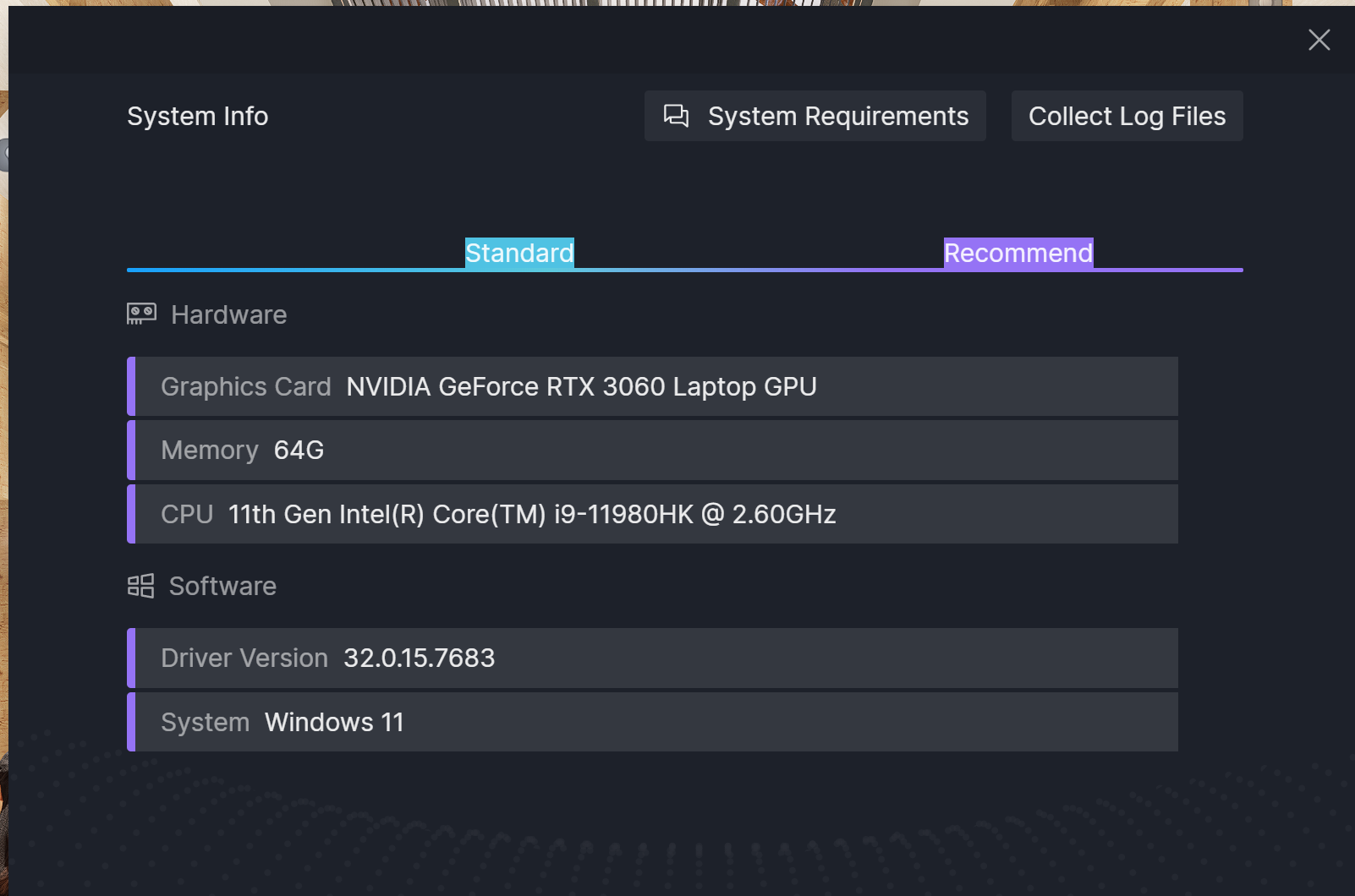

Graphics Card: NVIDIA GEFROCE RTX 3060 LAPTOP GPU
**Driver Version:**32.0.15.7683
**Issue Description:**I have been getting black vertical lines on my renders for this model. When I try moving the location of the model itself, the model disappears and I cannot see it again, even if I try moving my cursor.

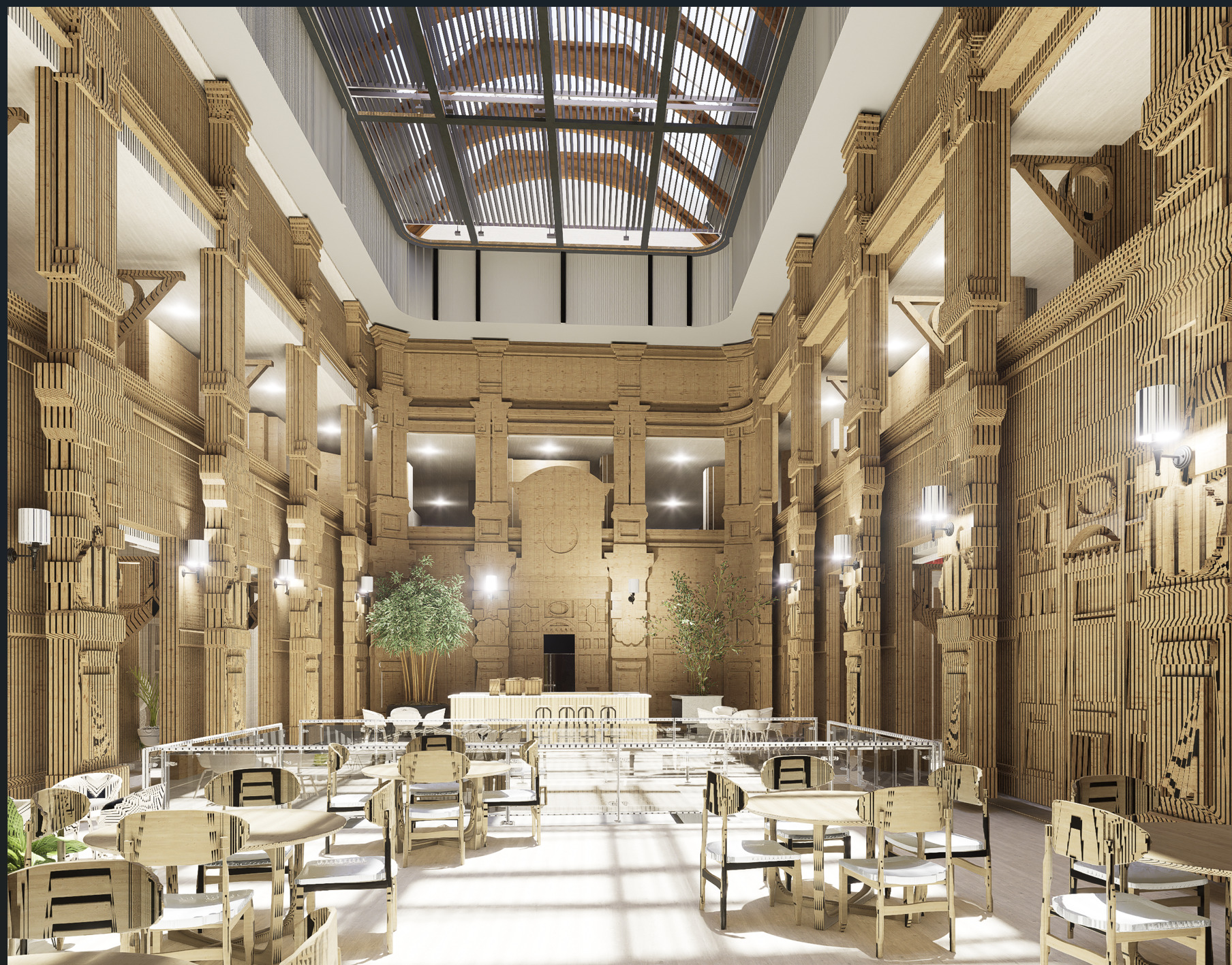

I tried changing the origins only in D5 to 0 on X, Y and; it deleted some of the black lines, but not fully. Please look at the image attached.
