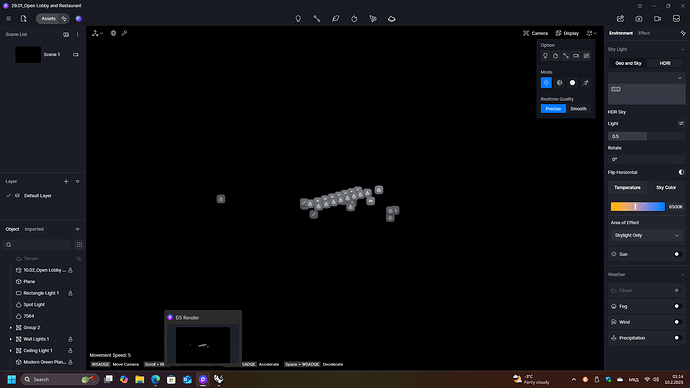

**D5 Render Version: Latest version 2.8
**Graphics Card: NVIDIA GeForce GTX 4060
**Driver Version: 32.0.15.6636
**Issue Description: I work Rhino with D5 live sync and when и start D5 with the Precise mode the display is black and I can’t work.
I apologize for the inconvenience this issue has caused. The viewport is black after opening the D5 file, but it can be displayed normally by hiding the layer where the model is located or switching to Smooth mode, this is because the value after the aftermerge is too large for D5 to carry. You can try hiding the layers to see if your viewport becomes normal, if so, it is recommended that you optimize the model.
Also, please try to export the .d5a model and then import it in D5 might resolve the issue. If it is convenient, please send this scene file (the entire folder where the .drs file is located) to us. We will check it from our end and provide an update as soon as possible.
You may send it to support@d5techs.com and have it titled Clov-Forum Black Display in Precise Mode
