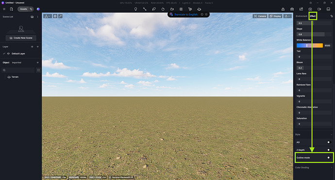

Hi @christopher98schroed
Can you check if you have enabled “Outline”?
No, its not activated. For some reason the outline from when you select a material to edit, appeared in the final render
