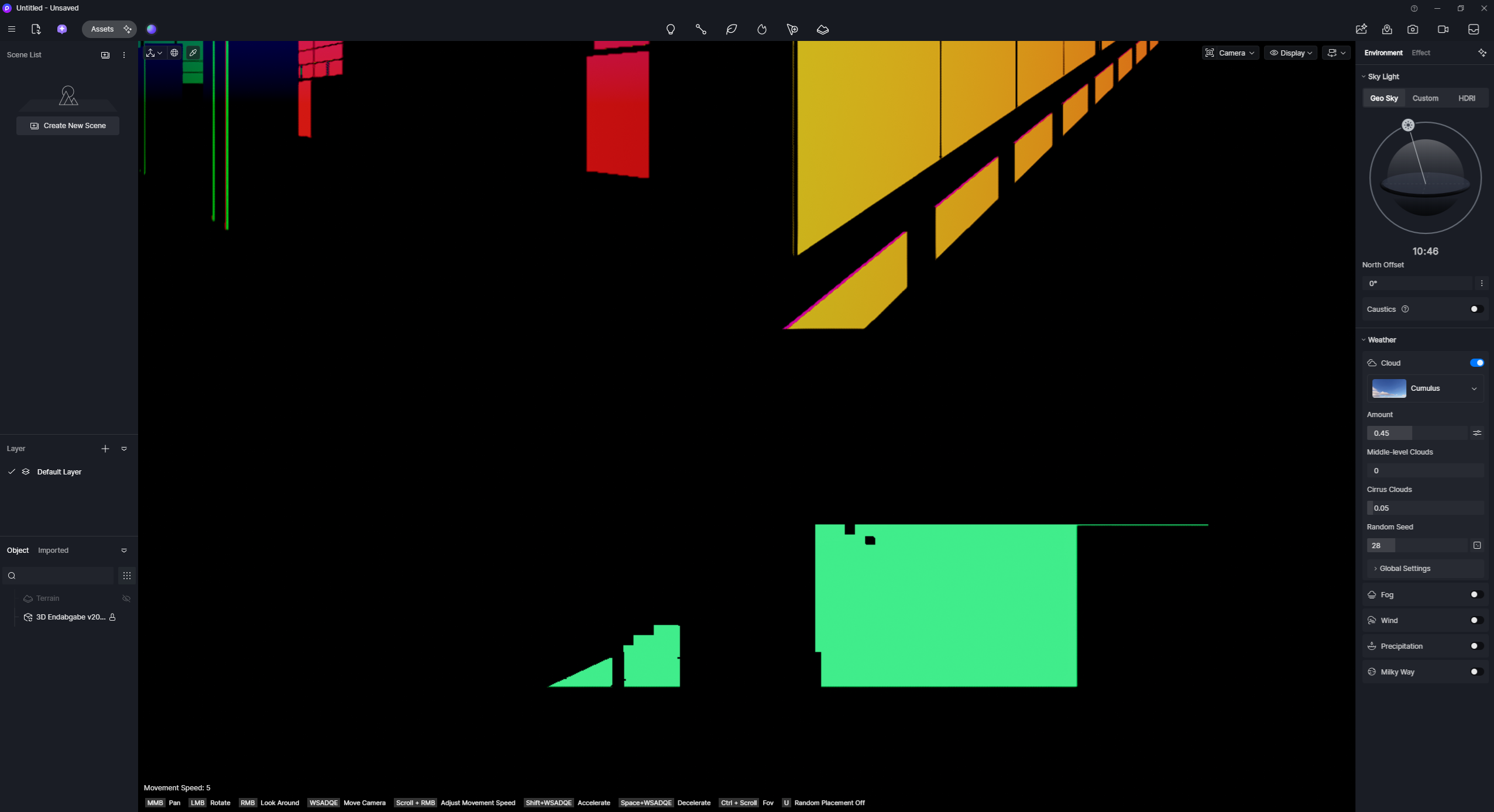

Black Background and Neon Flickering Artifacts
D5 Render Version: Version 3.0.0.
Graphics Card: RTX 4080
Driver Version: Nvidia 591.86

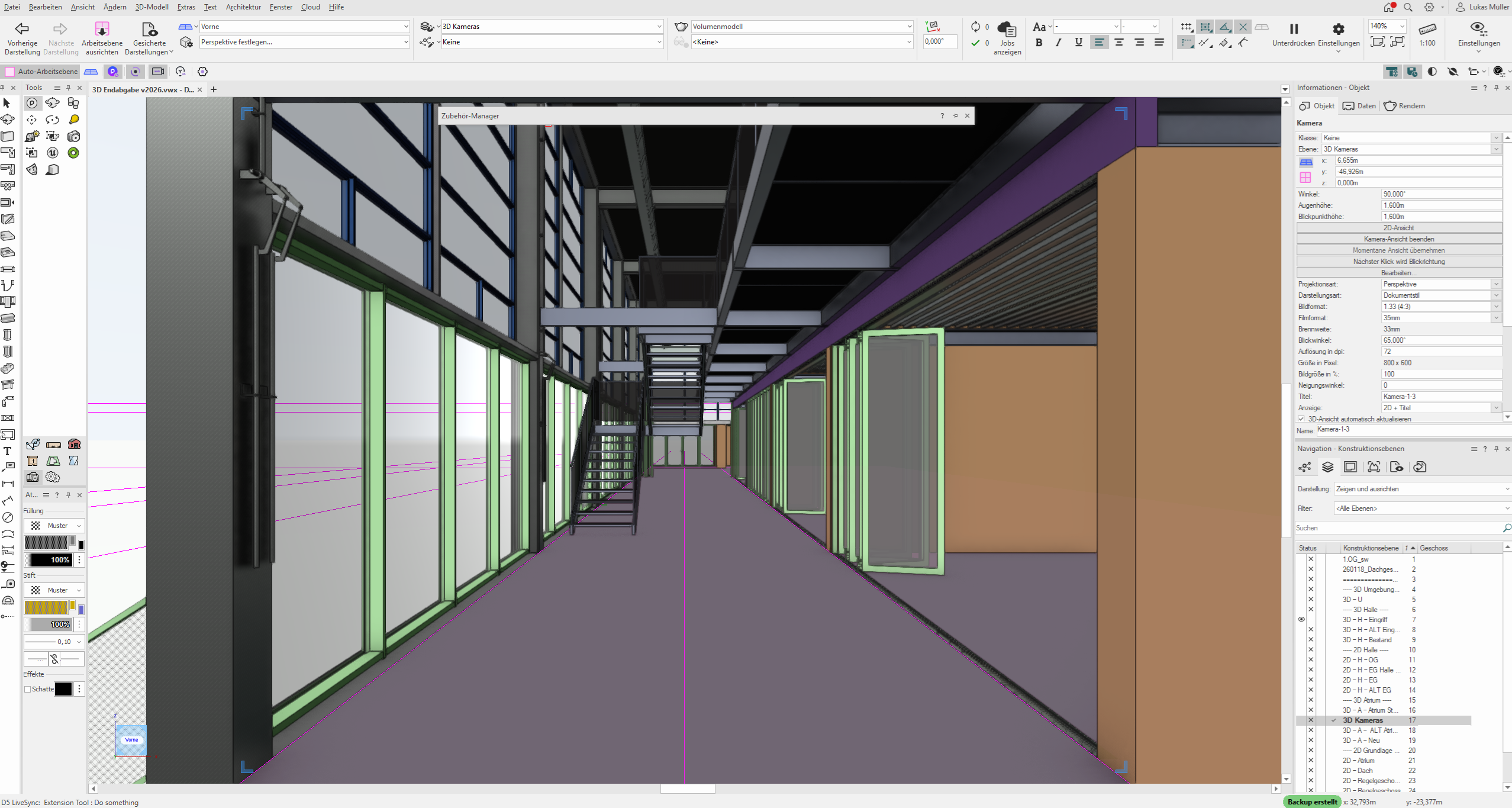

Issue Description: After Livesyncing from Vectorworks 2026 to D5 my Viewport is completely black with neon lights and lots of flickering when moving around. Smooth Display works fine, but the rendered results is also Black with the neon artifacts
Hi @lukas.82223 We are currently investigating a similar issue. Could you please share your logfile with us so we can troubleshoot this further? Apologies for the inconvenience
I found a fix for me for now by significantly reducing the model detail and turning complex geometries into symbols in Vectorworks. I hope this Log file is the correct one: https://www.mediafire.com/file/wq2mrpjm4g0xzsp/zziplog.zip/file
