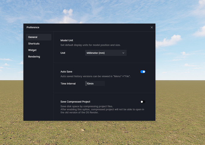

Graphics Card: I dont have the asset storage I go to the preference and its not there. I need to down load some external model to the local asset. I did download the model file to D5 WorkSpace\model. And also when i open D5 Launcher is blank white. Please help i have deadline. Also if possible can you please show me how can i move D5 from disk C to disk D cause my disk C is getting full. Please please help
Driver Version:
Issue Description:
Hi @vuphuongnhi
The workspace folder can be edited via D5Launcher only.
  • But you did mention that your D5 Launcher only appears white? Were you able to download and place it in a location where you have “Full Control” or Admin Control? You can try to uninstall everything (D5 and Launcher) then reinstall using this full package: Download Package
