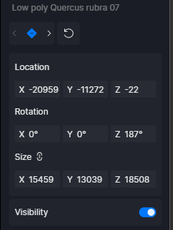

  1. Interface issue - object visibility in keyframe - it is wrong displayed. Switch is disabled but object is set to visible.
obj_vis (2).zip (1.6 MB)
  1. Objects keyframes are blocked by their Group keyframe.
If group has keyframe - it object can’t be edited.
  1. using skip to keyframe buttons doesn’t select this keyframe. Keyframe can’t be deleted without manually selecting it.
As for point 1 it looks like serious issue. if we click on keyframe all object data are not actual/updated correctly.
Object can have scale = 1 but keyframe information will show only last keyframed value
key (2).zip (1.0 MB)
