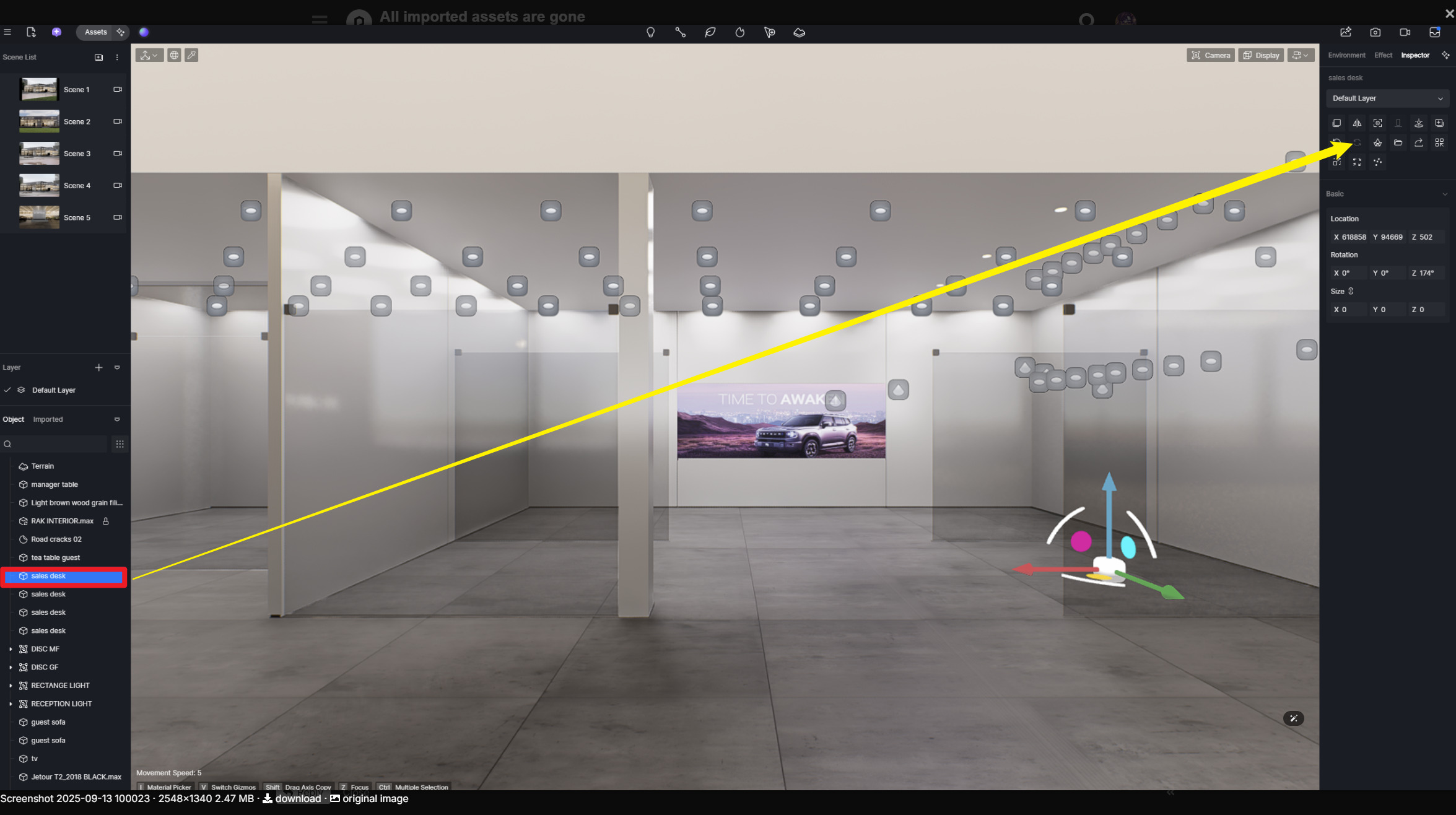

hello, i have checked and all the assets are in the scene but not visible. however when i right click on an asset in the list and click reload, it reappears. can’t do it for all the assets. so anyway to reload all at once?

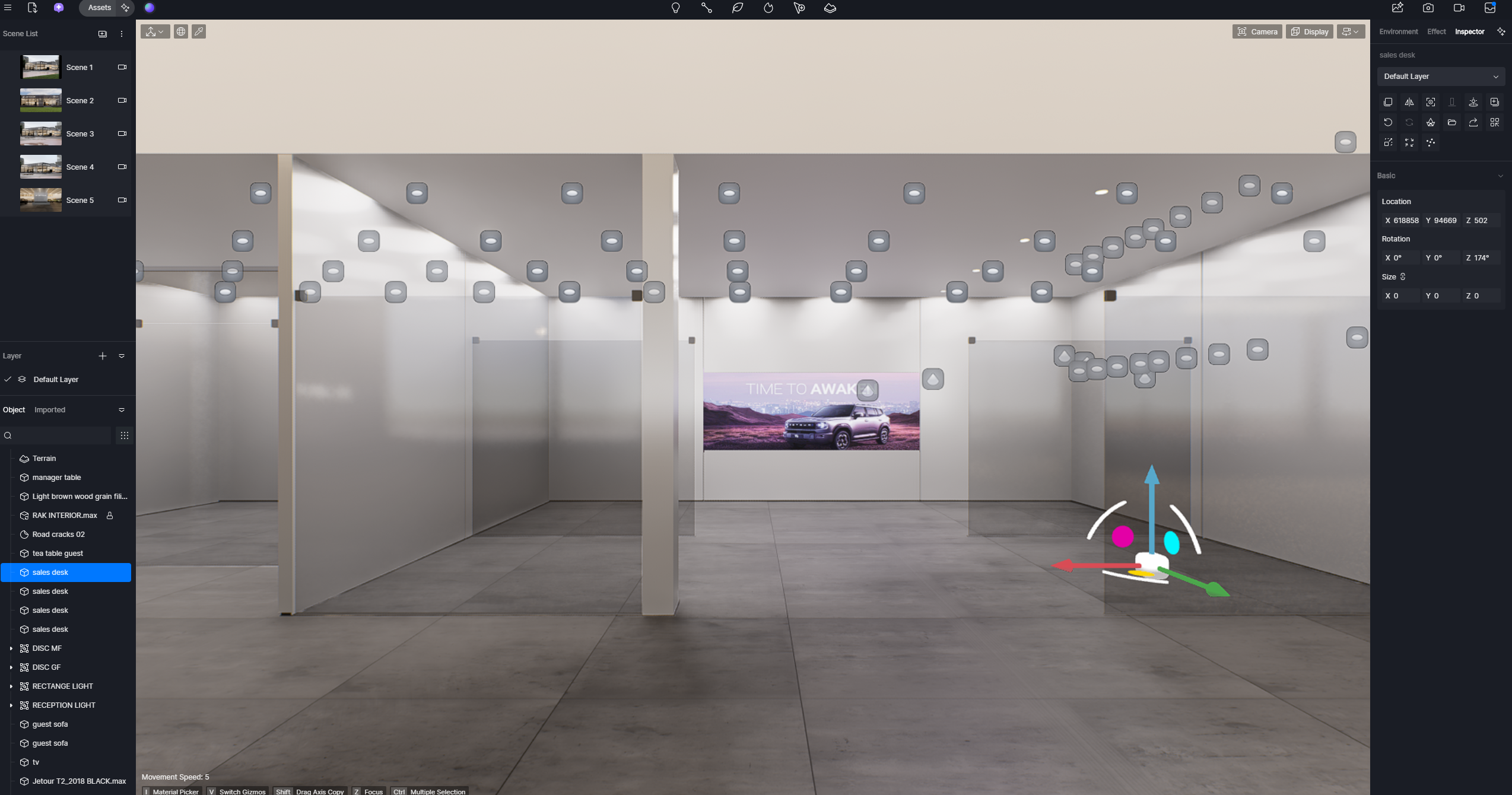

Hey, I got the same issue. My assets are in the scene, but not visible in it.Only the name appears in the left object pane

May I know how these assets were brought to D5 Render? You should be able to reload it if these objects were imported directly to D5.
  • If you have used our plug-in to bring these assets to D5, you may need to check the model file to see if these models are still intact or present in the linked file.
  • Please also check if these models were not renamed or moved from their original file location.
  • Ensure that these files are placed in your local path, we currently discourage placing them in your Cloud Storage or Server Path.
