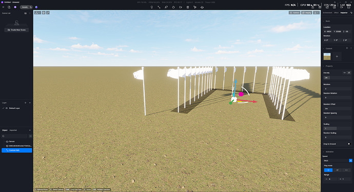

I created a Custom Path and added my animated character in Alembic (.abc) format to it. I also attached a screen recording — as you can see, the model doesn’t follow the curve of the path, it just slides along a straight vector.
Have you encountered this? Any idea what I should change so that the Alembic character really follows the path?

Can you send me this specific .abc file? I tried it on my end with another alembic file but it follows the path, even the curves. Please check my recording.
Note: Please check if your 2.11 build is this version: 2.11.0.0605 or 2.11.0.0603

Hi @alexandrplem
I personally think this is within expectation, given that your alembic file has a custom linear movement from one point to another. And the custom path tool does not control the Alembic file’s built-in path but rather just the position.
  • If you wish to have this character follow the custom path that was set in D5, I think you should remove the linear movement from one point to another from this character and just retain the body movement.
Yes, that makes sense — now everything works correctly.
Thanks for the clarification.
