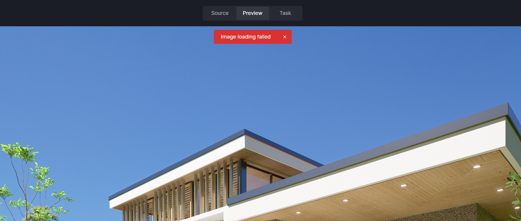

I have a similar problem, AI enhancer failed to load, it happens to almost all my projects
Hi @amap100298
There are several reasons for this error prompt.
  • Where is the original image placed? Did you perhaps move or rename it?
  • Does this occur to a specific file only? Or it persists even in other D5 files while using AI Enhancer?
Possible workarounds and solution:
  • Try to connect to another network and see if the issue persists.
  • Ensure firewall rules are set to apply to ā€œall programs that meet specific conditionsā€, not just a specific program
  • Paths with characters like & or % can cause image loading failures. Move the project file to a path without special characters and retry
  • Save the render to a local path and ensure full Read & Write access to the folder
