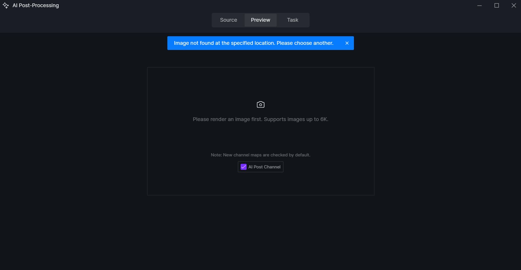

Hi. We changed the company’s server and I can’t enhance using AI tools like I used to do. The files works fine, I can render new images but when I going to enhance the images appear in SOURCE but did not appear in TASK, so it failed the enhance with the text “Image not found at the specified location”. I have PRO license

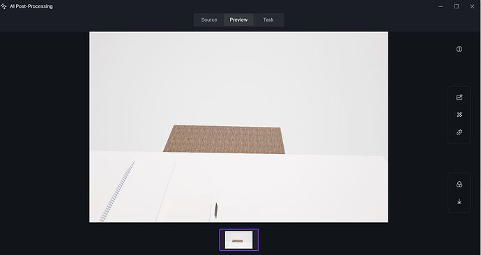

We also have the same issue. We have 3 accounts, but they are all the same.
(The AI Post Processing worked yesterday.)
  • We tried a simple image to test, but still failed.
  • We tested with other D5 project files, but we still failed.
  • We also tried putting it in the queue and rendering from it, but the AI processing also doesn’t work.

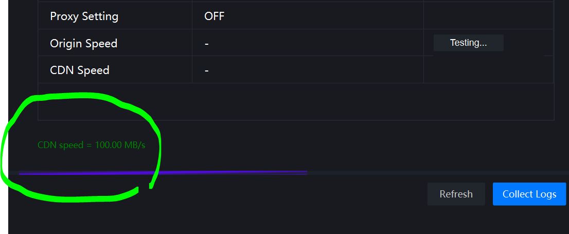

  • Internet connection tested as shown in the attached image. (CDN speed = 100.00 MB/s)
Could we please know how to fix this issue…?

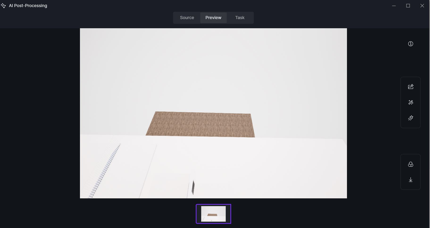

Hi @slee
Please check the file’s storage path for rendered images if it contains special characters such as ‘&’ or ‘#’, (‘#’
  • Try to rename it purely in text only, then try again.
  • Additionally, can you share with us your D5 Render Version? I want to check if you’
    re using the newest 2.11.1 build?

Hi @design27
Your advice worked! It turns out the problem was the special characters in the folder name. It happened to me because my file name had an ‘&’ in it. Tysm!
