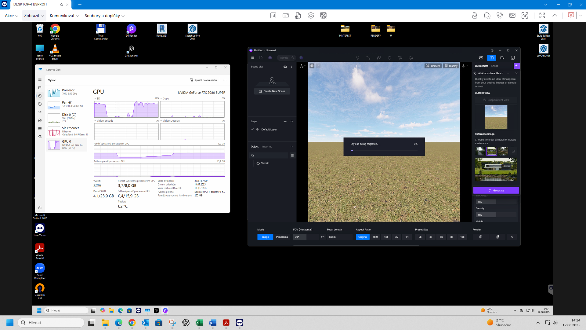

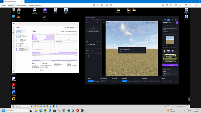

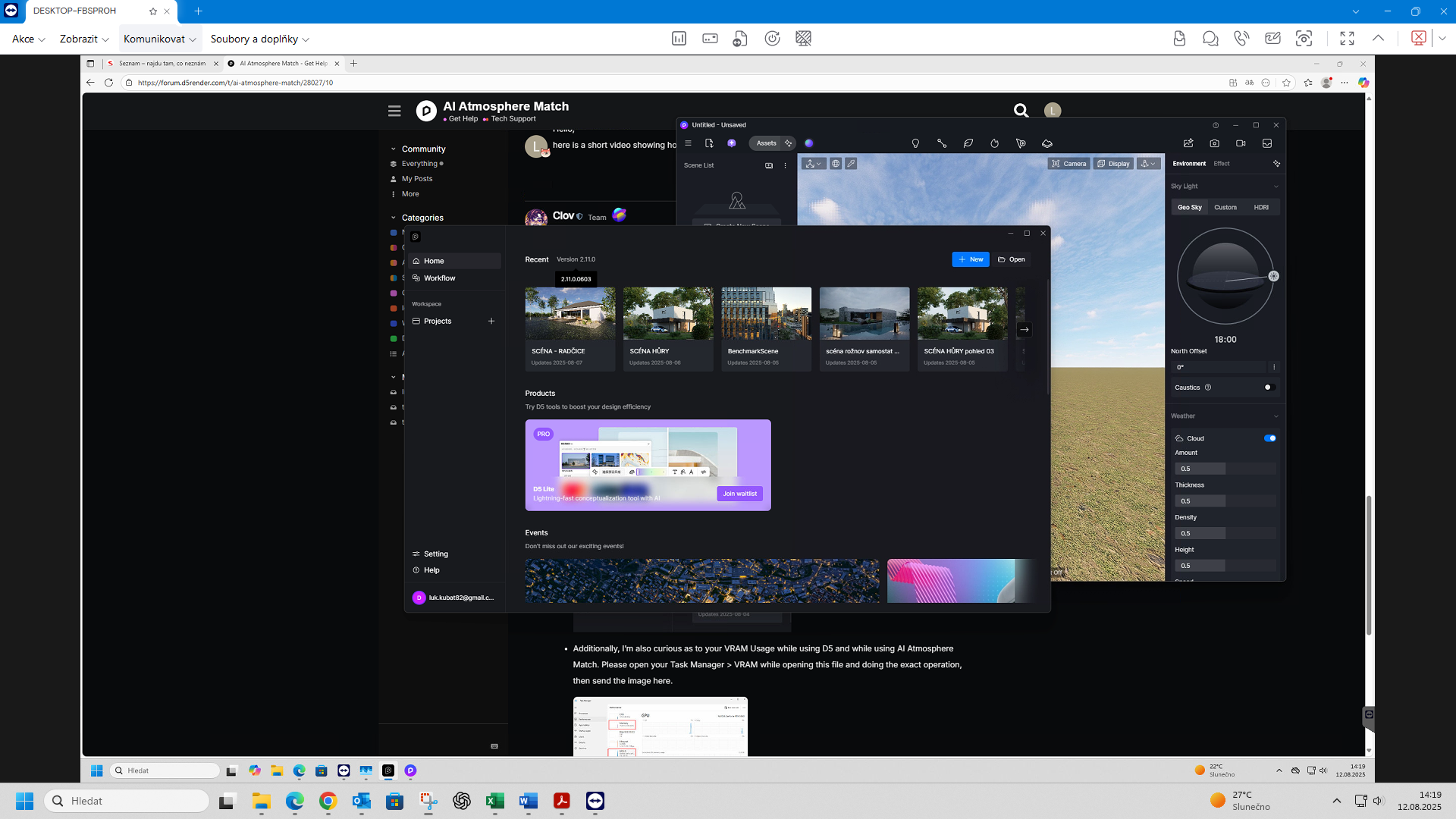

Additionally, I’m also curious as to your VRAM Usage while using D5 and while using AI Atmosphere Match. Please open your Task Manager > VRAM while opening this file and doing the exact operation, then send the image here.
Hi @luk.kubat82
I apologize for the inconvenience. This seems unnatural despite having normal VRAM numbers while using the feature.

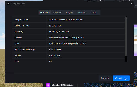

Please generate a log file for us so we can further investigate this issue.

Hello, I’m sending the requested screenshots. Thank you.
Hi @luk.kubat82

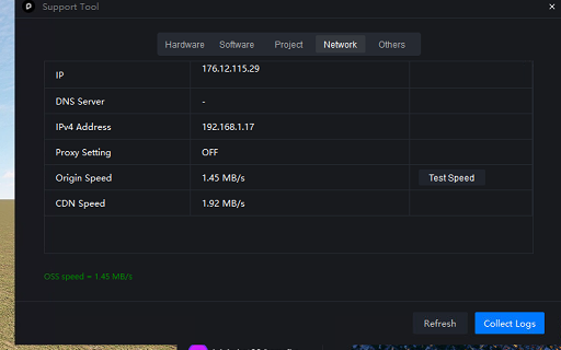

Thanks for these images, but this was not what I requested, but rather the log file
Please check the image that I have attached. There is an arrow pointing to “Collect Logs”. After generating, it will redirect you to the log’s location. Thanks

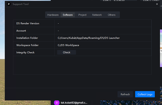

After checking your logs, we have found out the reason for the crashing:
The AI atmosphere is crashing due to special characters in your Windows username (appdata path). Our software is currently unable to properly process file paths that contain these characters, which causes the program to crash when loading a LUT generated by AI Env
We are working on a permanent fix for this, and it may be resolved in a future update. For now, you can try using a different Windows account with a standard username, then check if this has solved the issue.
