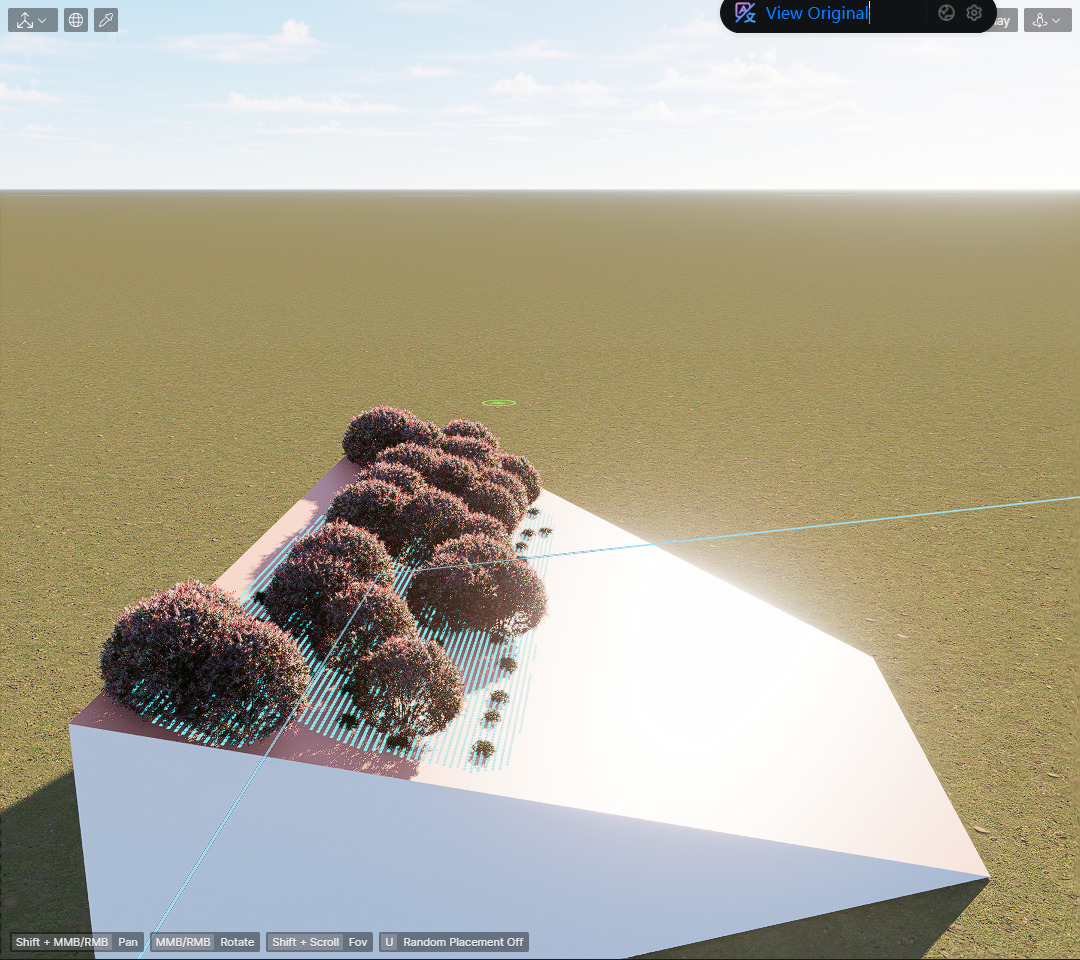

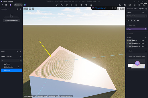

I was really excited about the new features great job! However, I ran into an issue when using the Advanced Brush. While it’s almost perfect, it seems to ignore the model’s height information, behaving as if the entire model were a flat 2D plane.
I’ve attached a screenshot to help illustrate what I mean.
Hope you can help us out.

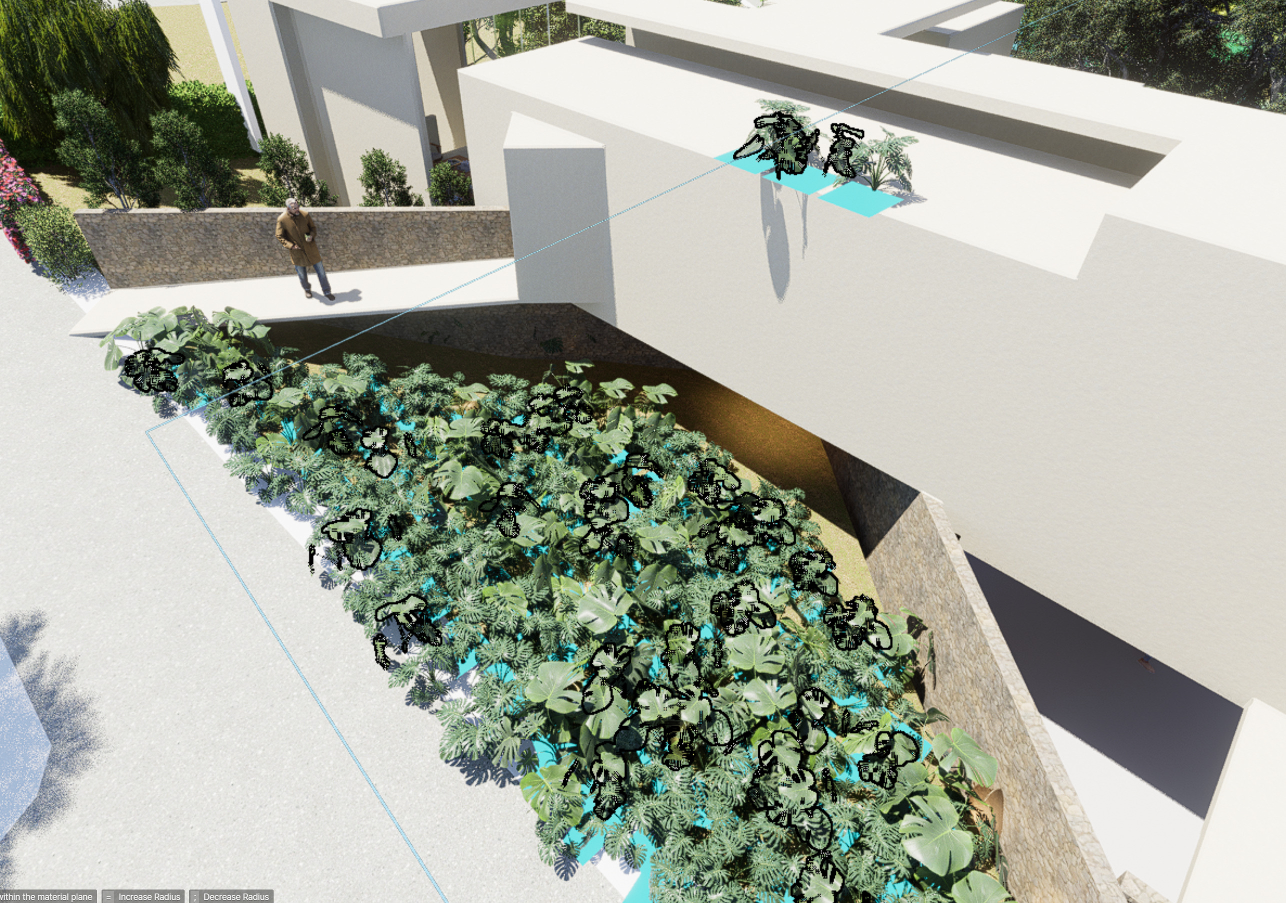

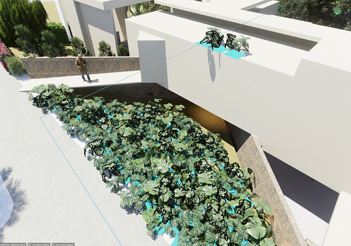

Hi Clov, thank you so much for your response. The thing is that the brush does recognize the elevation on a slope but when you create a volume or plane above this slope and leave a space under, this is space which is located under the new volume is the one that it is not recognized (as you can see in the image I attached there are some plants placed in the upper volume and the space under is empty) . I hope you can understand me. Thank you so much again for your help.
