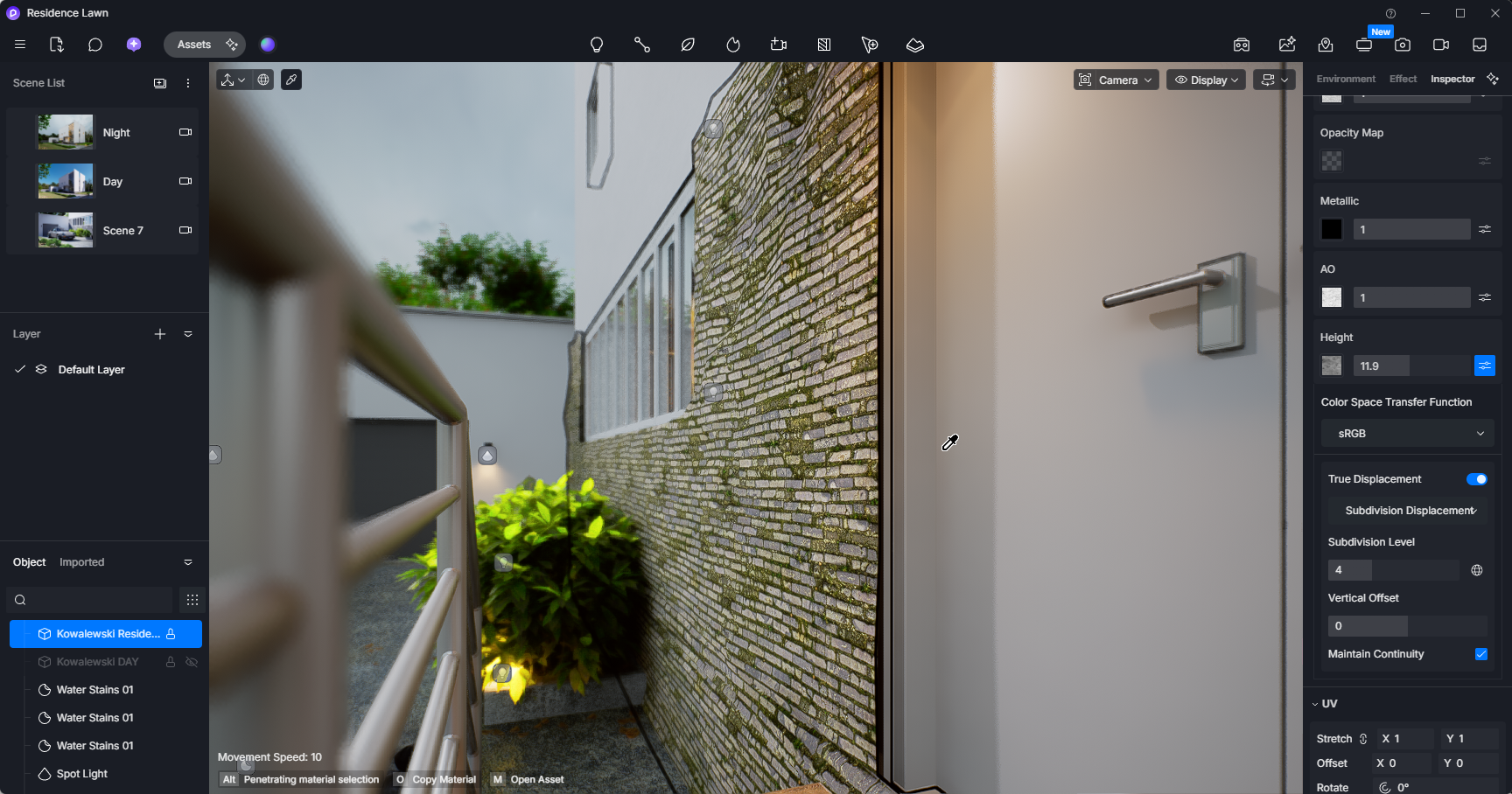

Materials using True Displacement created in D5 3.0 are no longer displayed correctly in 3.1. They can usually be fixed manually by adjusting settings, but every material has to be edited individually, which becomes time-consuming.

  1. Displacement Issue
