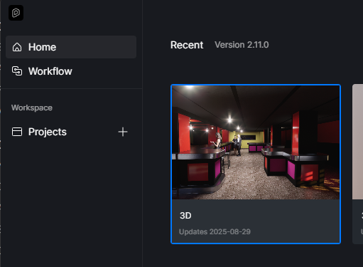

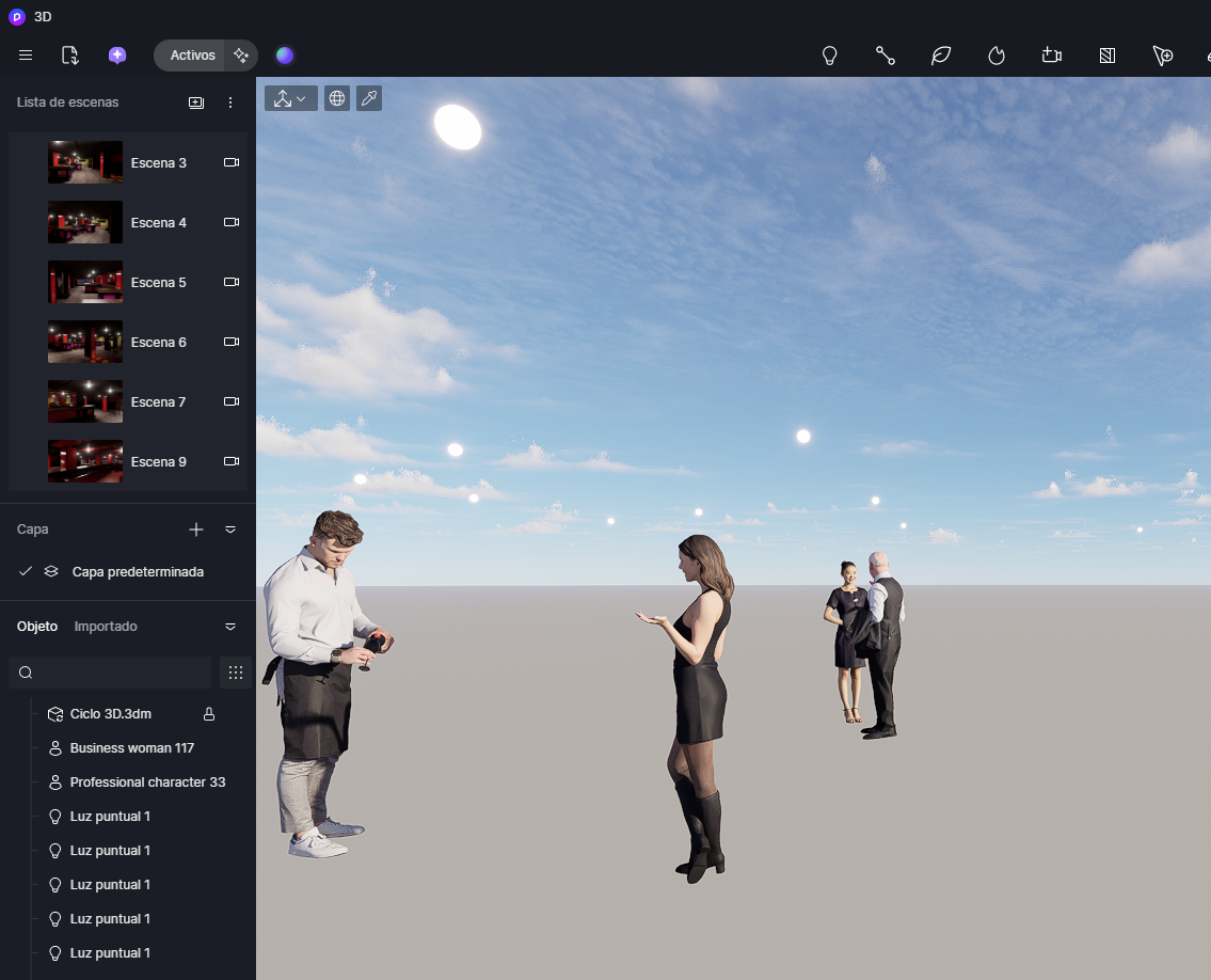

When I open up a old D5 project from the D5 launcher (not from the syncing button in Rhino) the D5 file opens up and all my work from D5 are still there (lights, models) but the Rhino model is gone. Even if the miniature thumbnail shows the latest saved version, the model is empty.

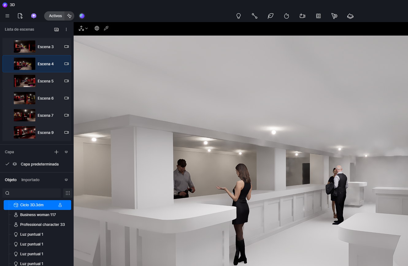

When I open up a D5 project from the livesync button from Rhino, firstly it opens a new project, not the synced one as it used to. But if I open the project from the launcher and then I try to livesync from Rhino the model syncs but all materials are lost.
