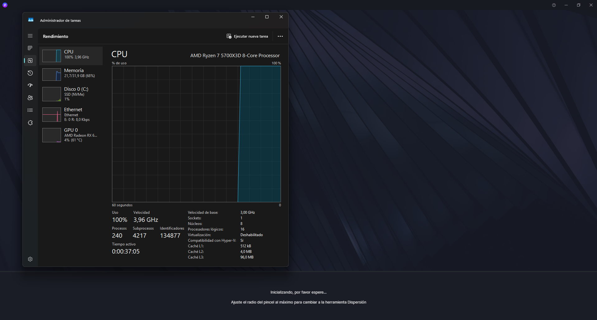

I recently updated D5 Render to the latest version (2.11.0). However, when I try to open any existing project or create a new one, the program doesn’t run correctly it gets stuck on the loading screen.
Additionally, I noticed that my CPU usage stays at 100%, even though D5 Render does not launch properly or proceed beyond the startup screen.

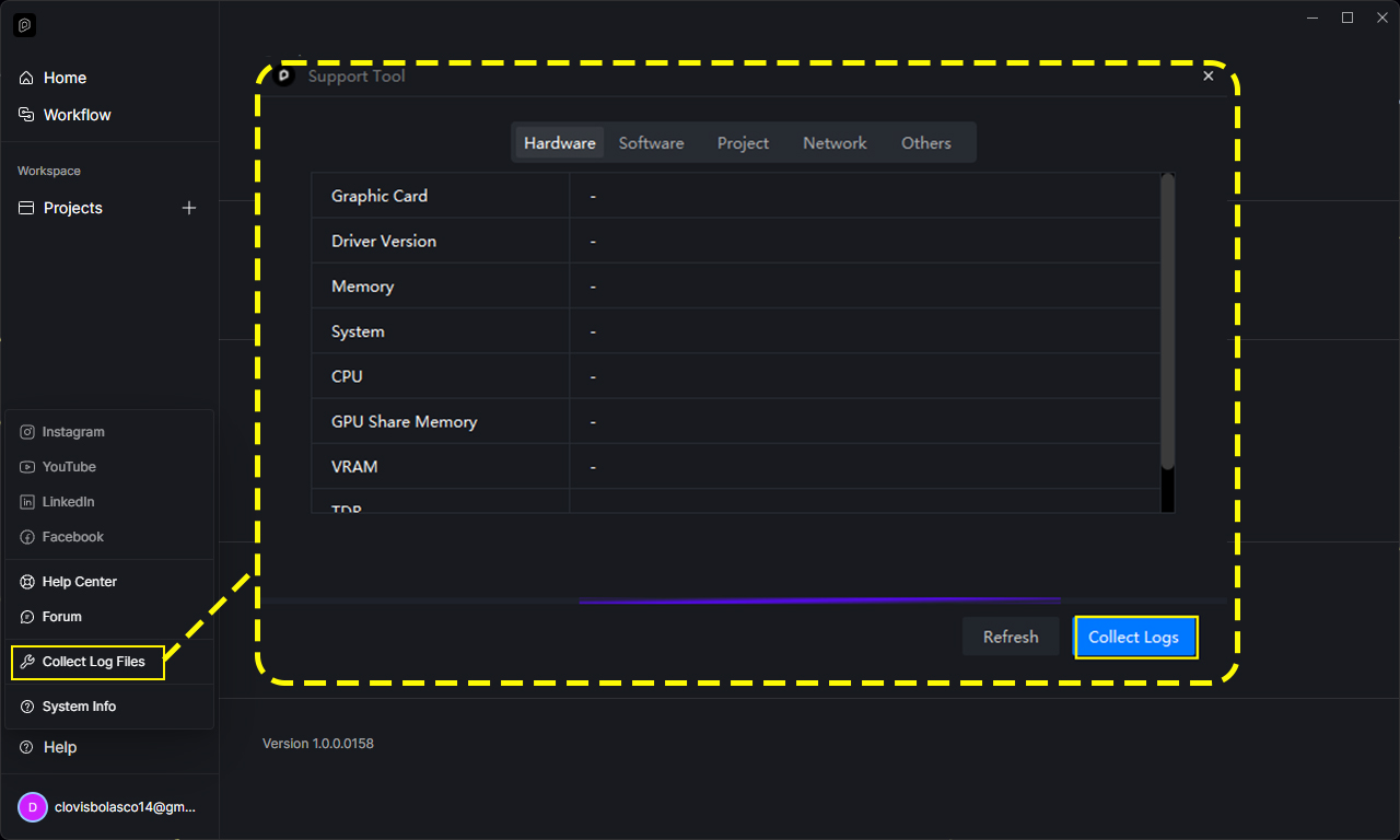

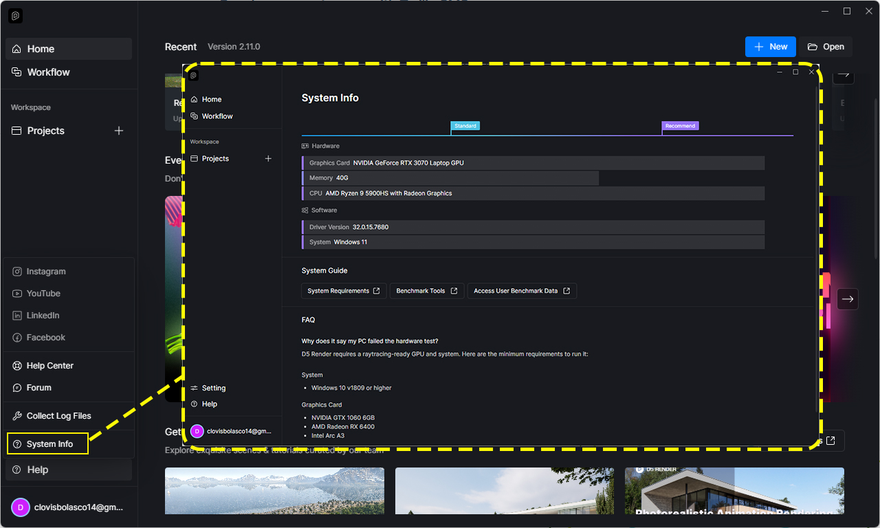

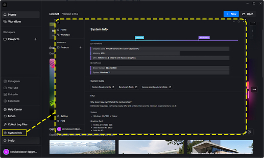

You may also send us the following images:

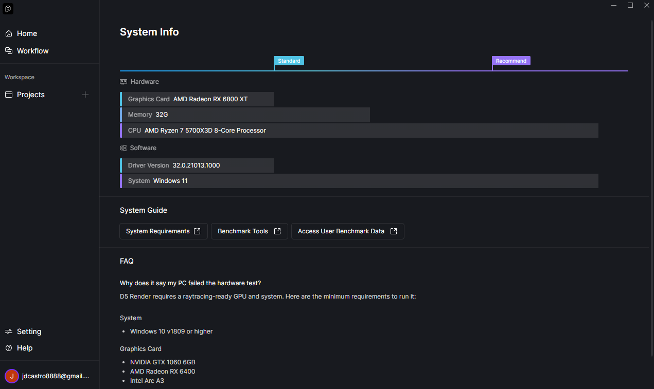

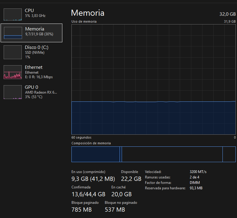

Hello, good day.
Yes, I’ve tried everything, including uninstalling and reinstalling the program, but unfortunately, it still doesn’t work. Version 2.10 was running normally, but since updating to version 2.11, the issue persists.

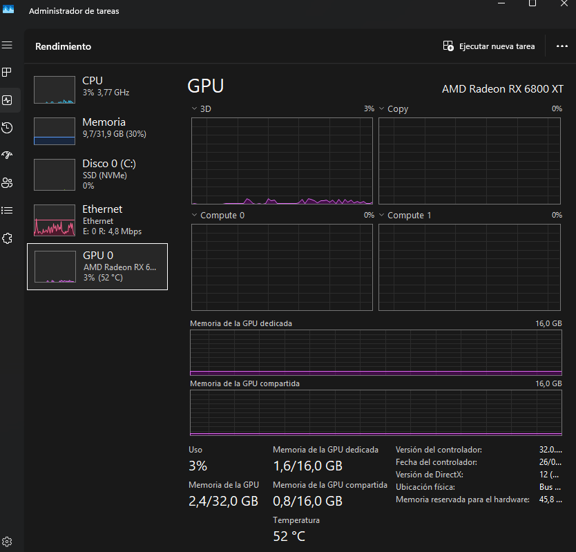

I’m attaching the requested screenshots.
Thank you very much for your support — I look forward to any recommendations.

Hi @jdcastro8888
Alright, everything seems to be normal based on the images that you have sent,
  • but I can’t seem to confirm how recent your GPU Driver is, so if there is a much more recent version of your GPU Driver, please update. Or simply do a clean reinstallation. Then restart your device, then open D5.

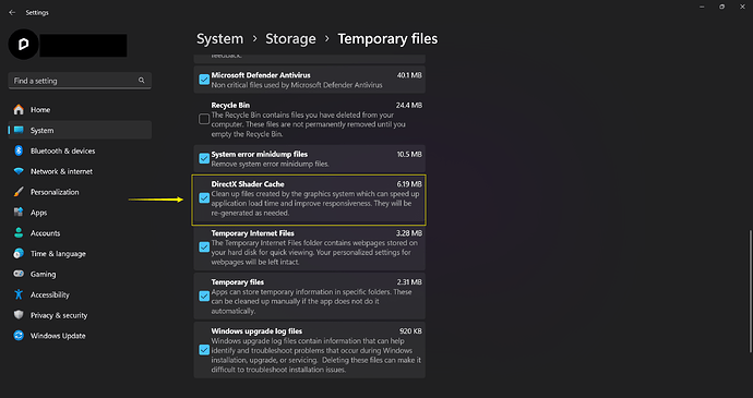

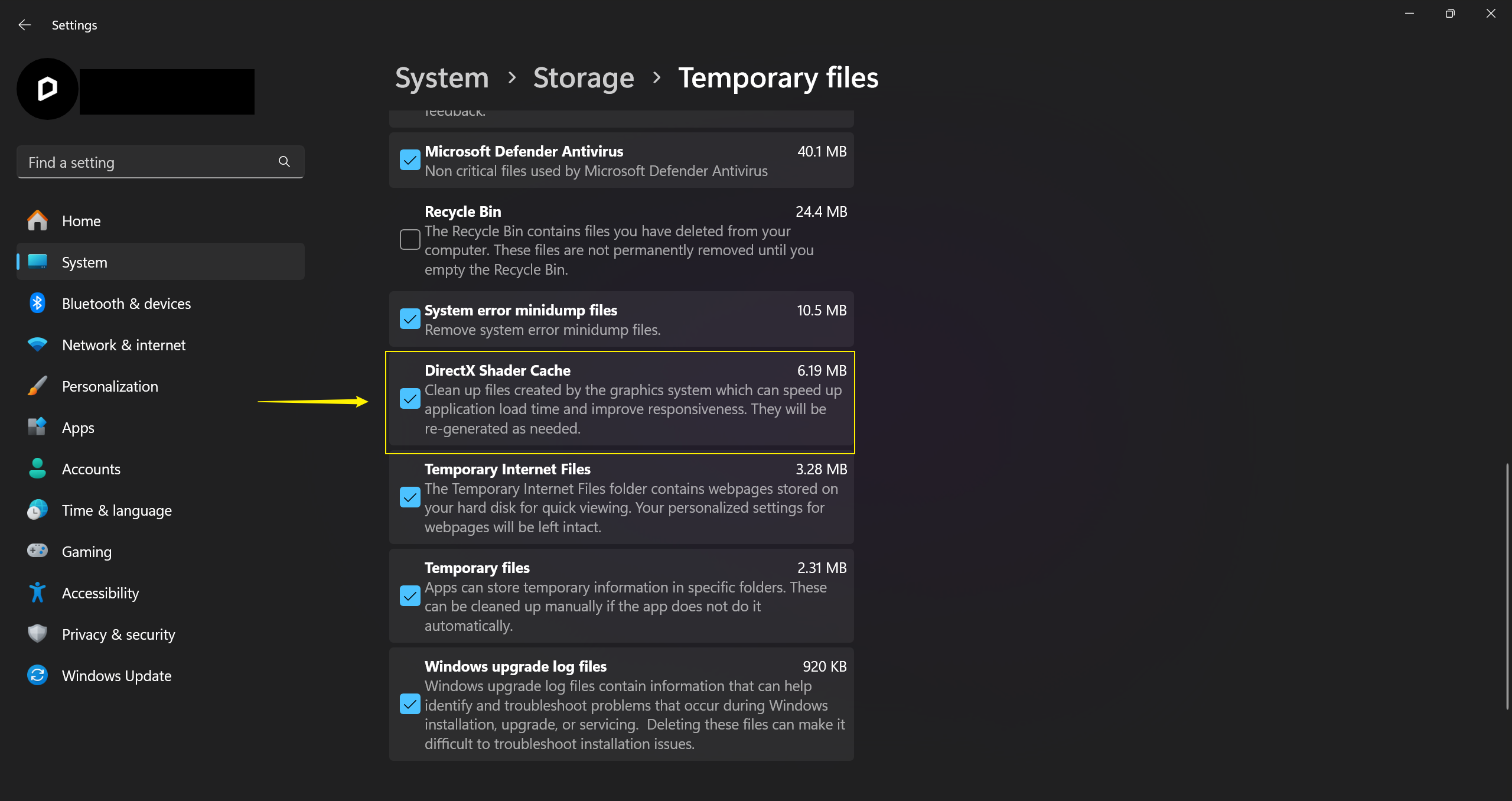

Additionally, please try to delete some Temporary files, specifically the DirectX Shader cache.
[Update] Solved with New Path of 2.11
