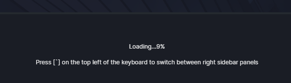

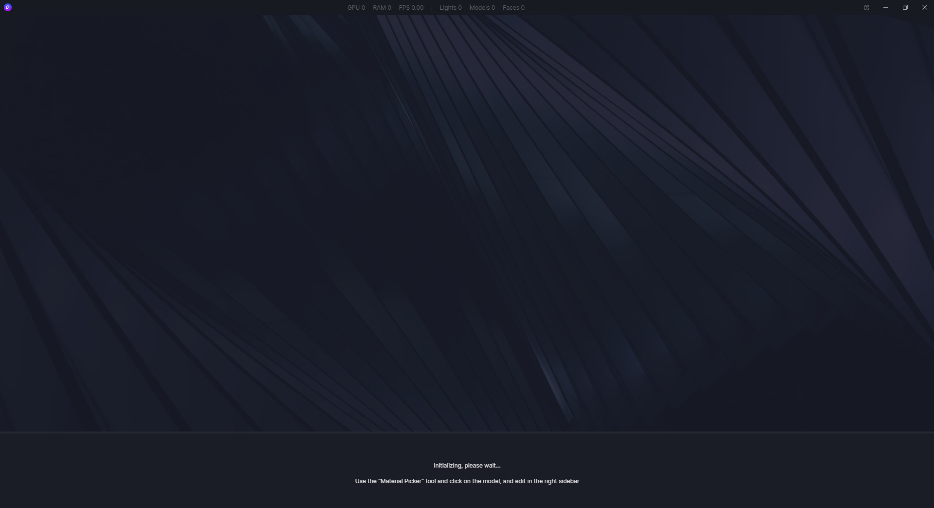

Ever since I have update the version from 2.10 to 2.11 my D5 Render get stuck on loading screen on either Initializing or a certain percentage (9% or 12% or 98% etc).
This is becoming hard to deal with as my existing scenes take multiple attempts to load. I have tried updating my graphic drivers and deleting temporary file. I have also disables XMP on my ram. I need help with it as it is creating a lot of disturbance in my workflow.

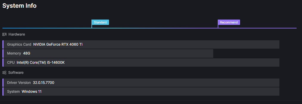

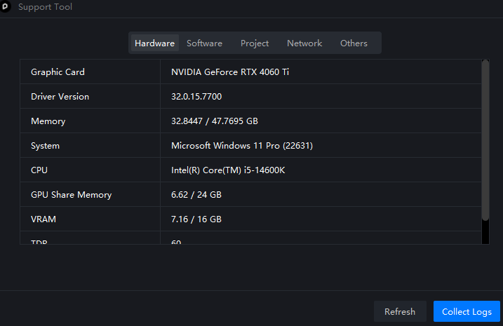

I have attached some screenshots of log info, and hardware.
