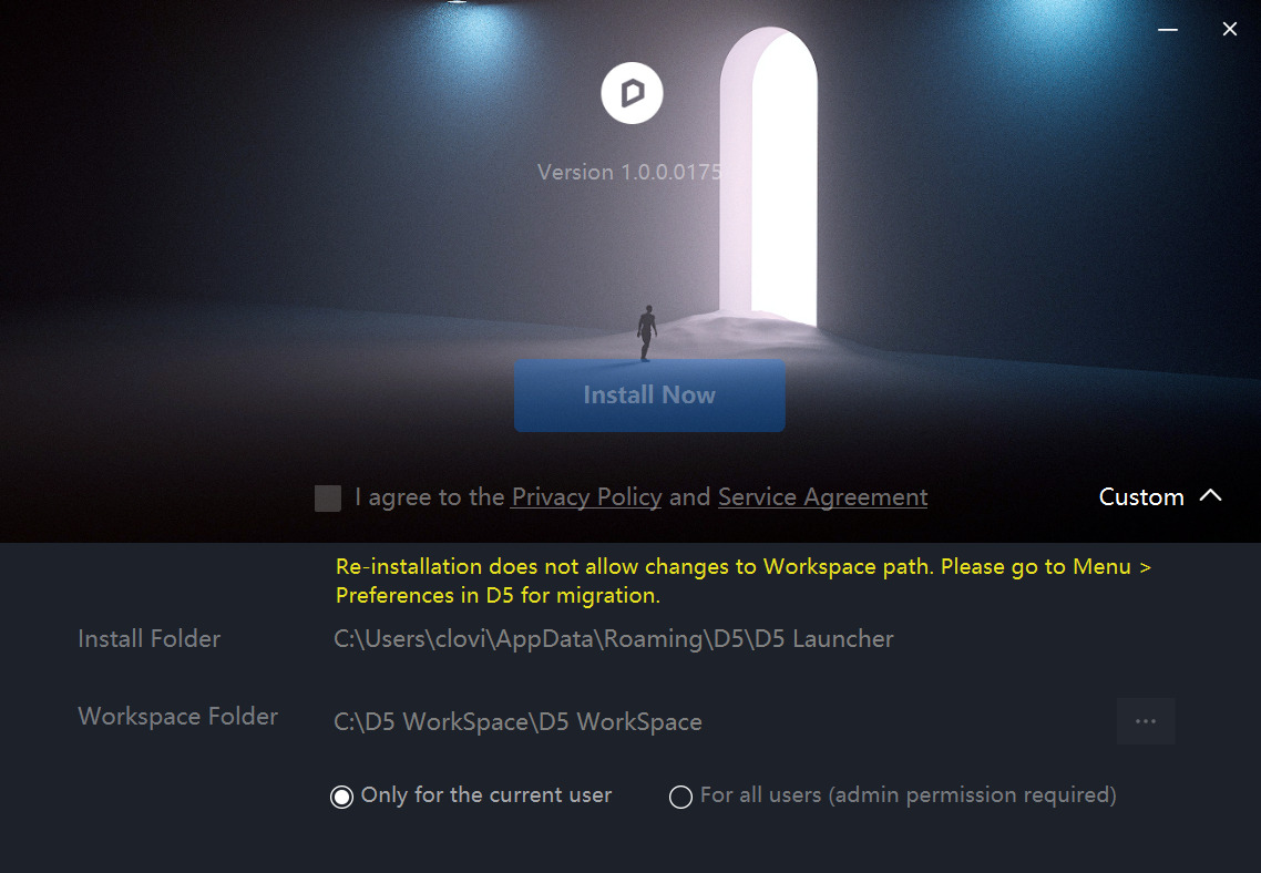

Hi @rashedexe @witthawat.luechaiwit
- Please try to temporarily disable your Antivirus, Firewall, or any encryption software while installing/downloading the Launcher.
- Did you select “Only for the current user” or “For all users” when installing the launcher? I suggest selecting Only for the current user for now. Then try opening again.

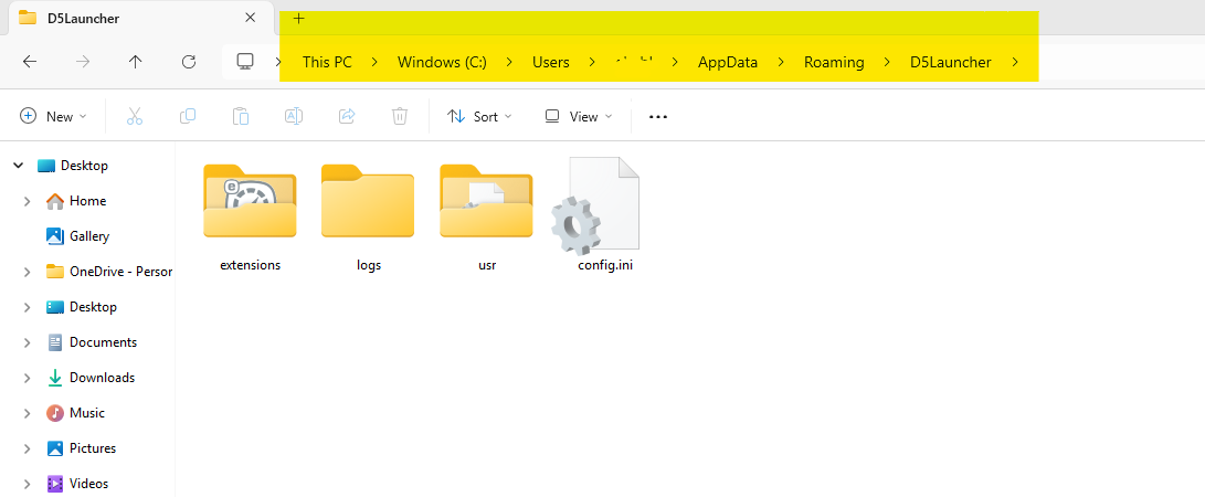

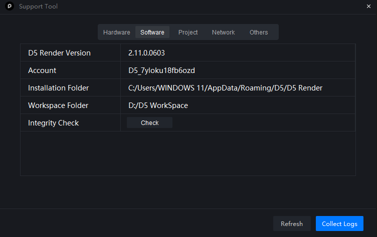

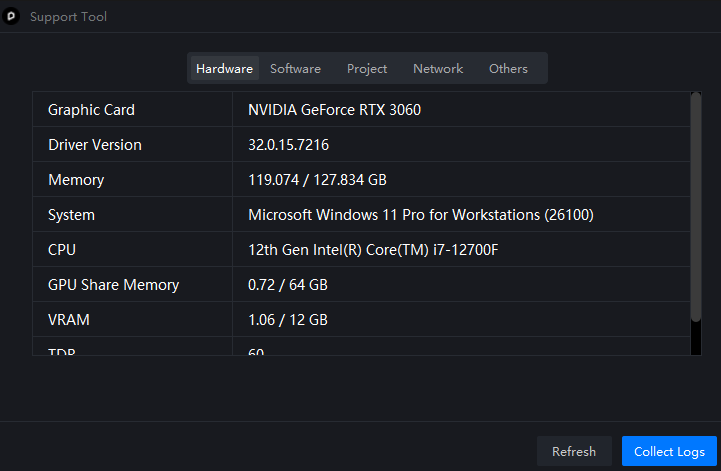

Please send us your Launcher Log files, you may send it to support@d5techs.com and have it titled ‘2.11 Clov-Forum 2.11 and D5Launcher-windows-1.0.0.0165 not opening’, please refer to the image for guidance.
Note: Please let me know if you have already sent it so I can immediately download it.

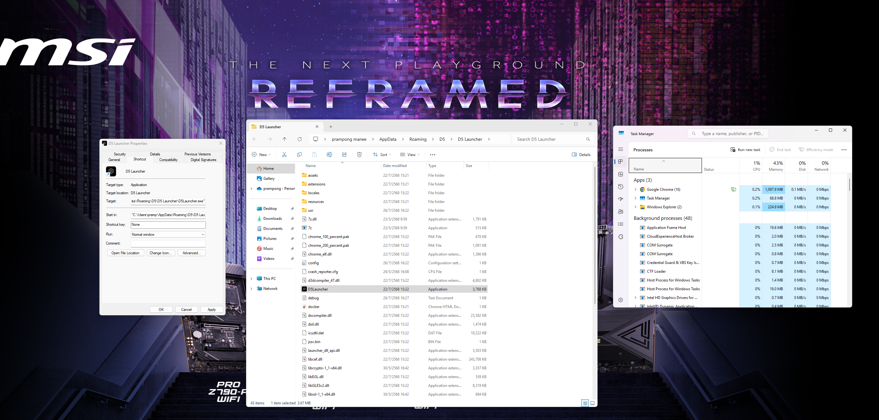

I have the same problem. After the update, the launcher cannot be launched, so I can’t use the program now.
i have also same issue its really urgent , I couldn’t access any file in 2.11 version.
please help to solve this problem.

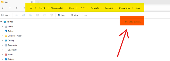

Hi @archtechconsultants @pramphotopram @renderstudio2001
We’re currently closely monitoring this issue.
- Please try to check on your Tray Icons if D5 Launcher is there
- Run D5 Launcher as Administrator
If these 2 suggestions didn’t help, please send us your launcher logs, I’m not sure how @renderstudio2001 was able to generate the log file without opening the launcher, but we do recommend sending this portion of the D5 Launcher logs so we can examine it further. Thank you!

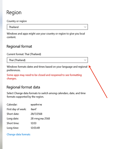

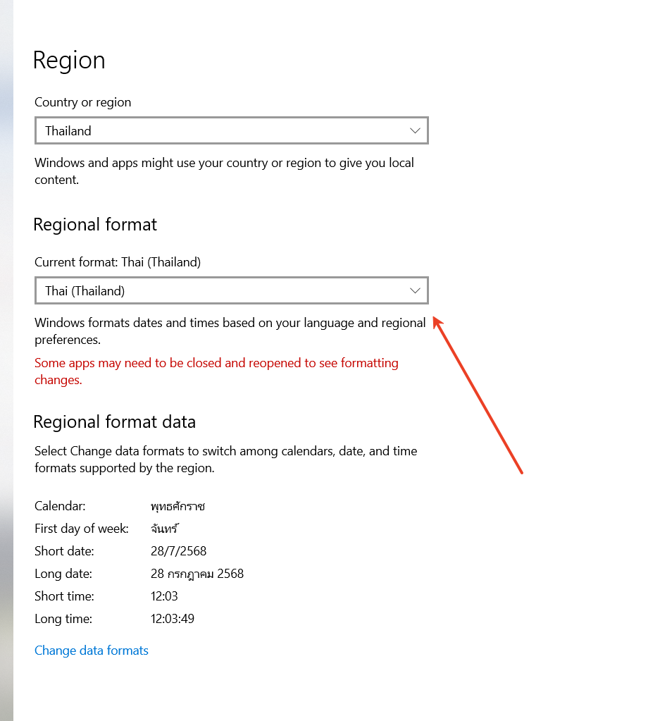

Hi everyone,
Can you please check this Windows setting on your end? Try changing the Regional Format to English.

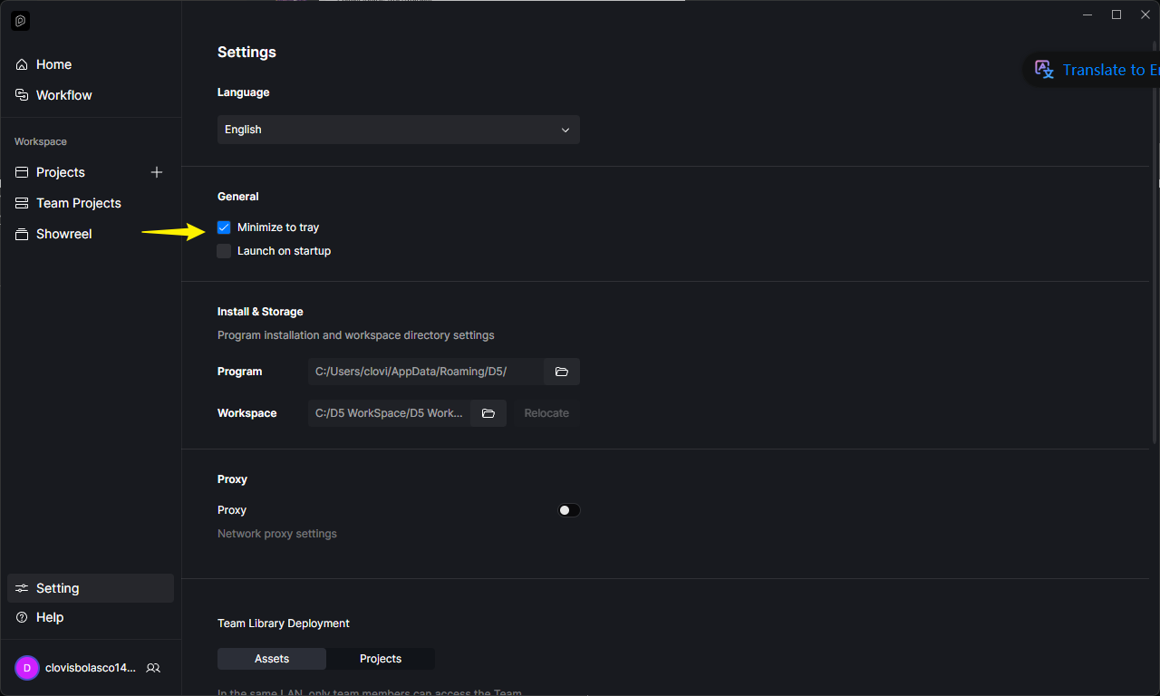

Yes, Thank you I changed to English and then updated to 2.11 Worked for me but only from tray icon not desktop icon still nothing happen when click on it.
Hi @rashedexe
Thanks for your update. Did you enable Minimize to Tray? I think if you enable this one and proceed to close the launcher, clicking the desktop icon won’t do anything since it is minimized in the tray icon section.
