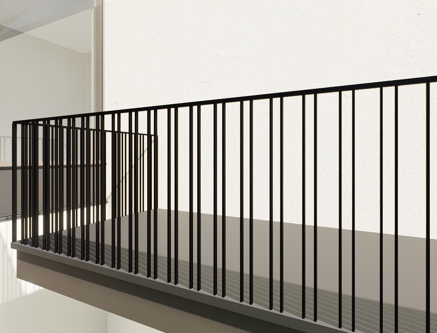

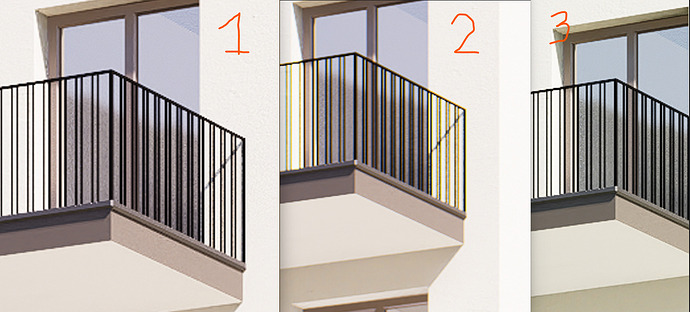

the handrails are simple black rectangular tubes without round corner option.
it seems the yellow lines occur only on vertical edges.
when rendered from closer distance it looks ok.

I have thoroughly checked your D5 Render Scene file and found that the effect
Chromatic Aberration causes the railings to emit the yellow contours on the railings.
Screenshot Attached is
You may try to disable Chromatic Aberration to reduce/remove the yellow contour on the railings.
Here is a screenshot of the render without Chromatic Abberation.

thank you! you are right, it was chromatic aberration.
were changes made to chromatic aberration in D5 2.8? because something like this never occured in previous D5 versions?
