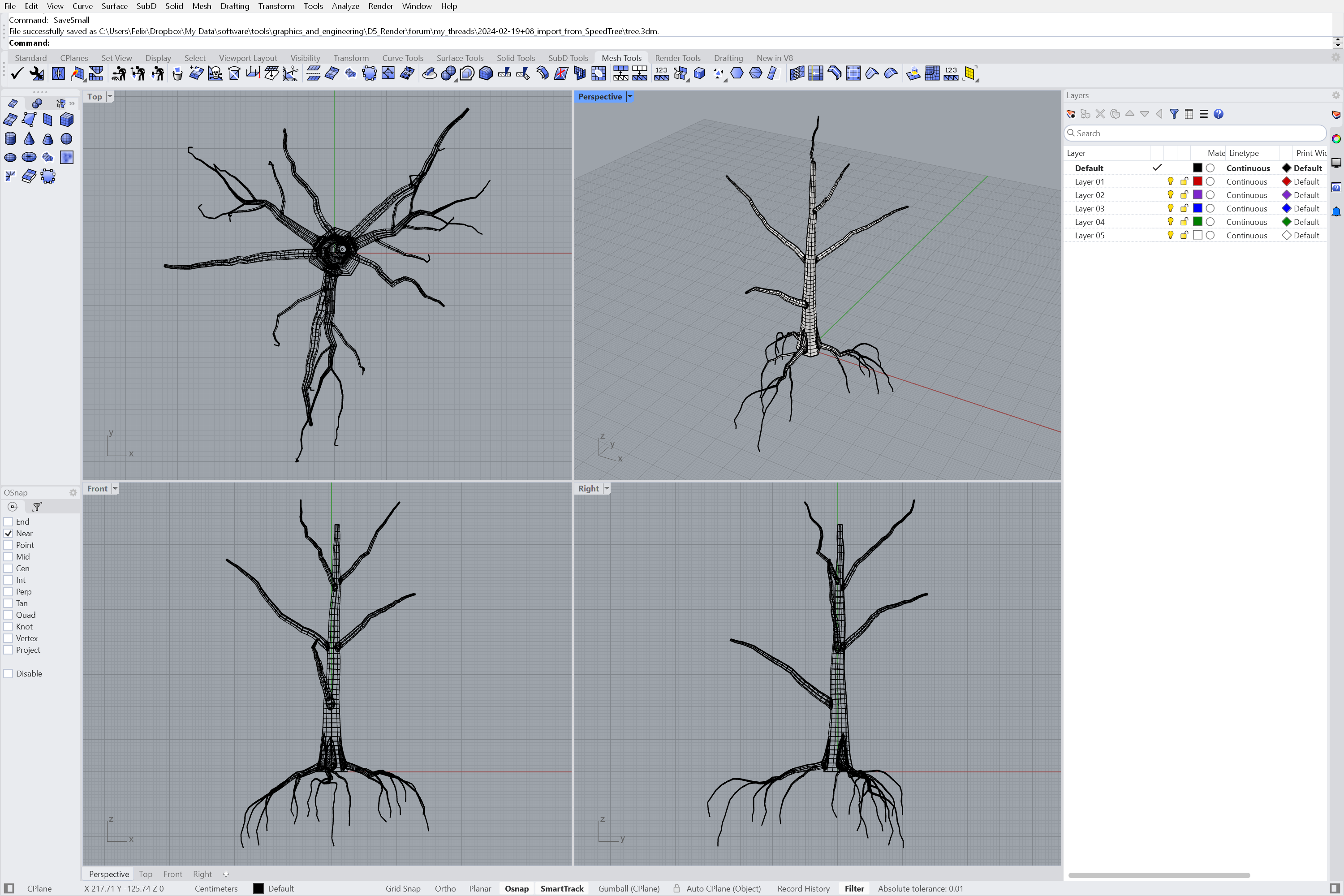

When I import the FBX into Rhino, the tree is in the correct position:

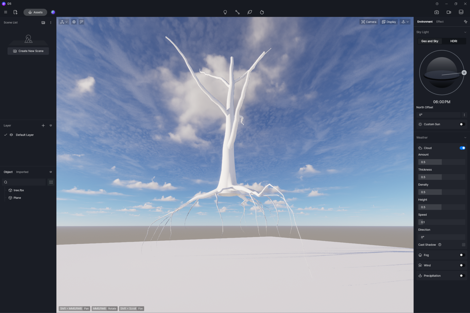

However, when I import it into D5, it is floating above the base plane:
Is this a bug, or am I doing something wrong?
Hi, when you loaded FBX did you see its data? That is, on the right the drop-down menu, when you click on the object the X-Y-Z coordinates come out, I reiterate that D5 is not a graphics program but a rendering engine that works differently from the graphics engine. If you, in the graphics one, placed the tree on a plane as you did, with synchronization I think you would find the tree normally buried with its roots. But if you start from D5 and load it as an object these things can occur, because D5 treats it as an object to be moved and rotated and scaled.

Has your tree’s location information changed? You could try placing the tree in the origin position in the modeling software and then importing it directly into D5 and selecting the sync pivot.
The modeling software is SpeedTree. It exports the tree with the correct origin. From that end, I think everything is fine. The problem is that D5 does not seem to respect the origin of the tree. This makes it extremely hard to align objects in the scene.

I think you can just click sync pivot after importing the model from speedtree into D5.
Sorry, yes you’re right, it’s Rino :slightly_smiling_face: :slightly_smiling_face: :slightly_smiling_face:
However, the best advice is from LunaLong
Thank you very much, @LunaLang! Indeed, right clicking on the object and selecting Sync Pivot does the trick. Sync Coordinates moves the object to 0, 0, 0.
